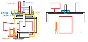

This drawing was send 2 years ago to Bestaedy.
The solution is here now!
Thank you.
