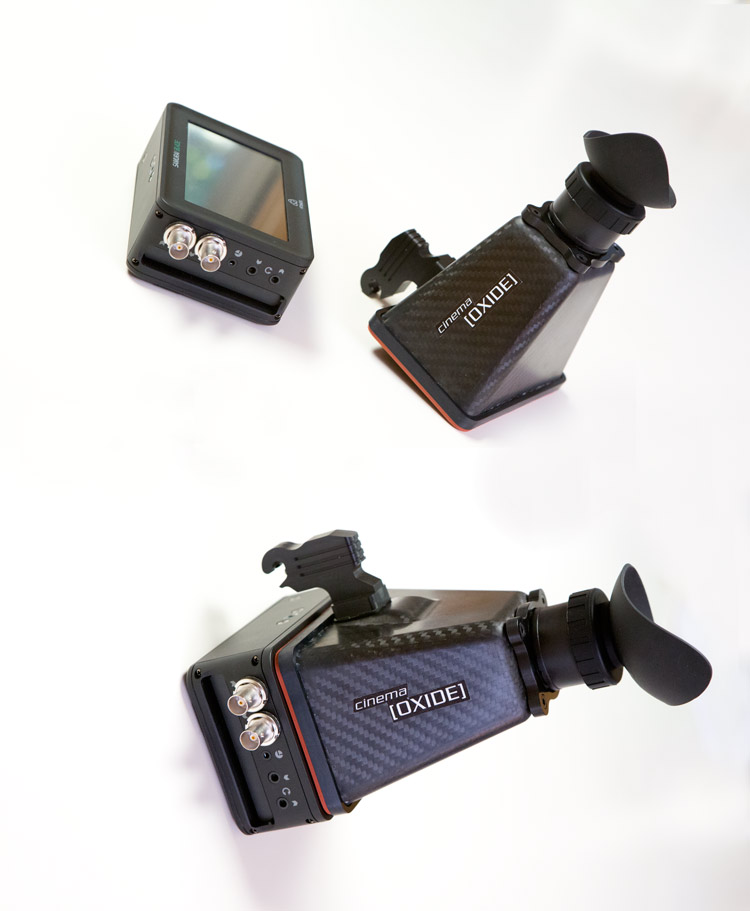

Would anyone be interested in an focusing diopter for the Samurai Blade? The one in the photo is the Carbonite Scope, but it would be similar. Hit me up at jason@CinemaOxide.com
Jason, while you are at it.
What I want:
A carbon fixture that holds the Blade together with a teradek bolt reciver and that is powered by a XL volt... No cables sticking out or such, think as far away as possible from something gaffered together. Think of a solid thing that I can give to directors and others and just know they can not brake it even if they drop it on the floor.
Size is not to important to rather have a carbon shell and the monitor, battery and other things inserted into foam and or some sort of cage system. Add your scope to it and I will buy two :)
