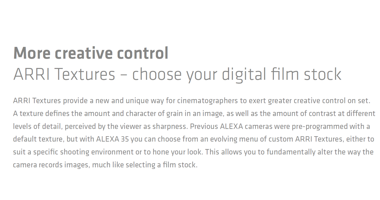

I must of missed the pamphlet; where is it? [Edit: LOOOL! Never mind; I just noticed a whole other page of this thread.]
As others have said, it could that the “texture mode” is merely to match ALEVIII cameras (cause the Minis, LF, 65 aren’t going anywhere any time soon).
Texture mode… seems like Arri is going instagram…
Patrick,
According again to the Brochure, all previous Arri Alexa camera came pre-programmed with a default predefined texture. This will give you more control over your own textured looks.

Patrick,
Hmm.
Quite likely "preprogrammed" is the same as clean as they could make it on the ALEV sensor. Now when things has been improved they are worrying that DP's will not like the more whistle clean look so they added a noise feature. As I see it the big selling point for Alexa cameras is that they looked very good straight out of the SDI port. So when connected to a on set screen DP's liked it, good amount of texture and a very nice rec709 lut to go with the log c signal. If this texture feature is put into something like a side car when filming raw, then sure, its a nice feature. I'f its actually burnt into the capture then I cant say I'm all positive.
Hmm.
I agree.
The grain texture of the Alexa is quite different in each channel and finer in the green channel than in blue and red (vs film where the texture is in my experience the same per-channel but the amount is quite different). It has a much nicer texture than some other cameras but this seems like marketing talk.
Bjorn,
I think it will probably be like a SideCar file that you will be able to alter in the ARRi Camera Raw settings in Resolve to some extent. Maybe you will be able to extensively alter the texture with an update to the ARRIRAW Converter. But if this new TEXTURE is something other than allowing more noise back into a cleaner image and is instead the ability to control the amount, size...and other variable of the grain/noise, could that really be saved into a sidecar file?

I agree.
Film works the same / has also different noise levels in the different channels. But for film you have different weighted film stocks. Some is made for tungsten, some is made for daylight etc. Daylight film stock has quite the same ratios of noise between blue, red and green as most Cmos sensors has. Digital cameras that compress the signal the same in all three channels of course get more artefacts in the more noisy channels as the more noise the more difficult to compress, uncompressed digital cameras are not suffering the same just as film is not compressed so the film noise when looked at in the telecine or projected without compression involved in the pipline normally come across as organic with perfect randomising etc.
That's not what I wrote. What I wrote is, intensity aside, the size of grain is larger in the blue and red channels than the green channel in the Alexa, consistent with a Bayer pattern array with more green photosites than red or blue.
In my experience, film grain varies in intensity, as you wrote, but each channel has an even size to the grain. I recently worked on a a job that was 4K S35 200T and another that was 4K S16 500T. 95% of my work is with Alexa and I own an Alexa and shoot raw and have to match grain for work too so I am familiar with it.
If you add a digital grain "overlay" the size is even per channel, like film, unless you specify otherwise. But the Alexa grain is not even in size per channel.
I'm just agreeing with you that this is marketing double-talk from Arri. I don't think the original Alexa has "texture management" so much as it's just a noisy camera in the shadows in a way that happens to look good. Dragon is also a noisy camera in the shadows in a way that looks good.
I am really curious about "texture management" and if it happens before debayer or not. On the other hand, I would never use it and I would just apply grain in post so it's sort of irrelevant to me personally.
