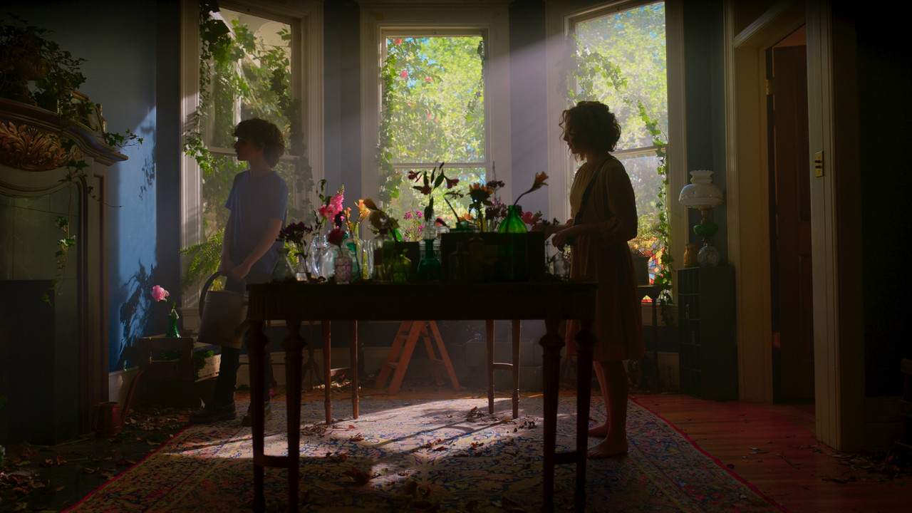

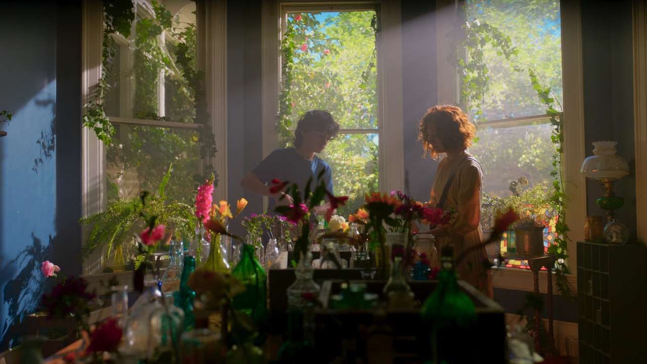

Attempted some highlight recovery on some Swing clips, but still a work in progress

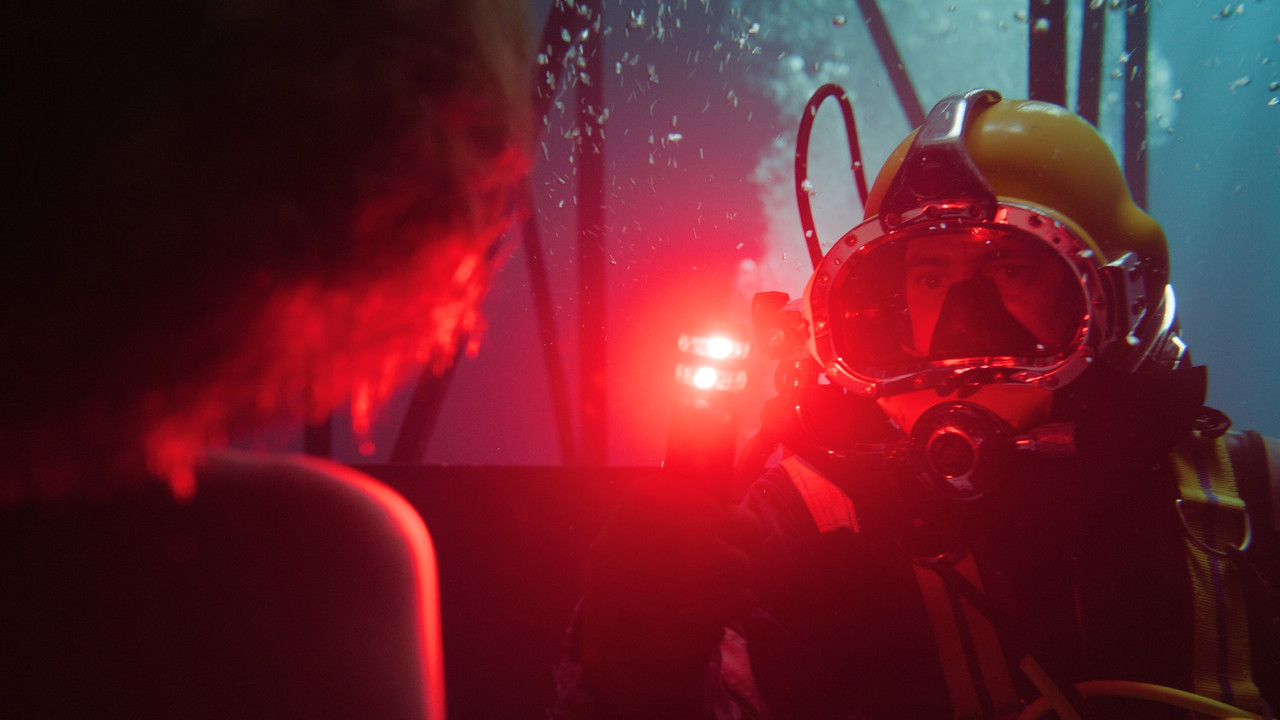

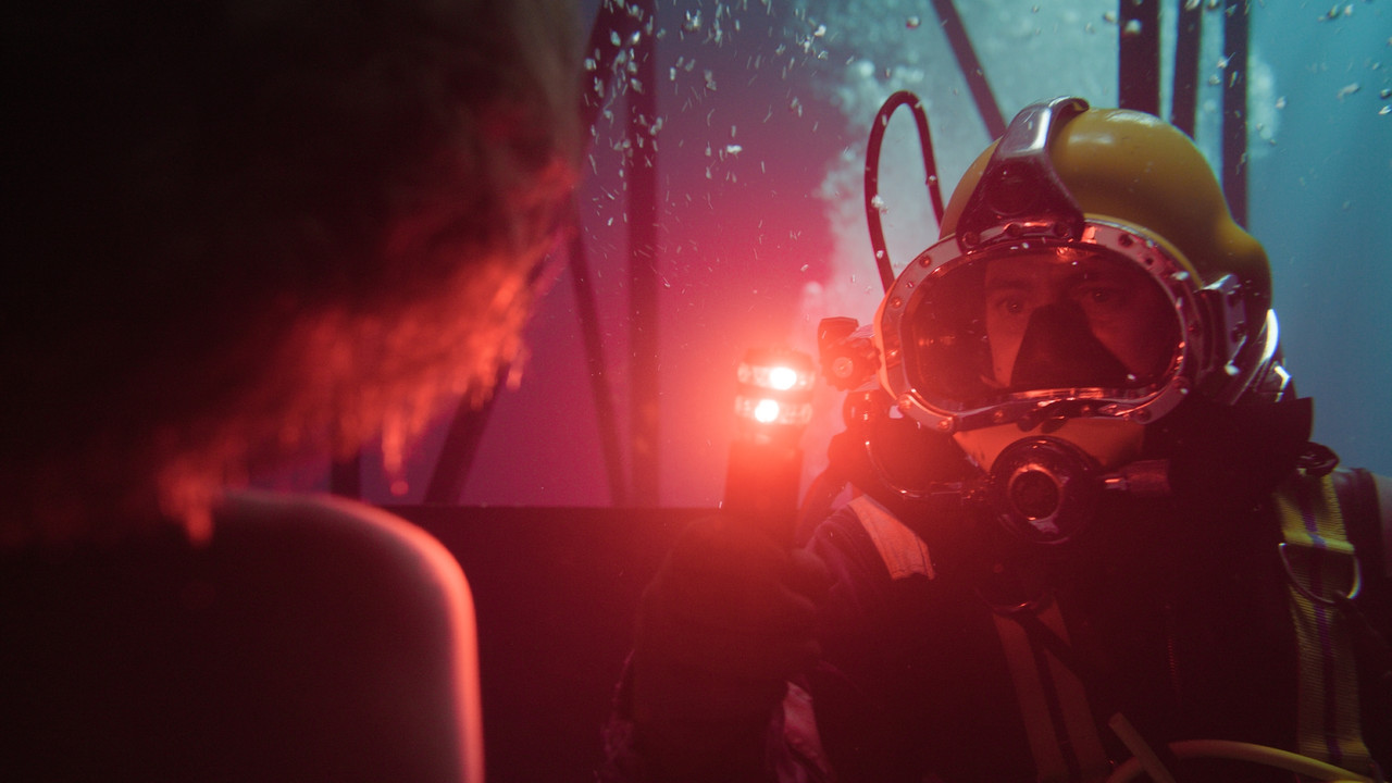

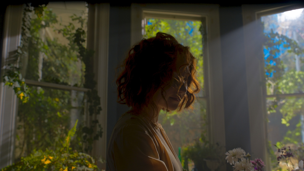

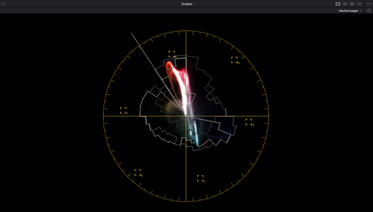

The Alexa 35 footage(even still using AWG3-ALC3 INSTEAD OF AWG4 ALC4) does really well at controlling "OUT OF GAMUT COLORS" with the AWG4 LOGC4 Transform Luts. The "REDs" in this image are just a little "OUT OF GAMUT" considering the intensity of the color. I used a slight 'HUE vs SAT" curve to bring them back just a little more.

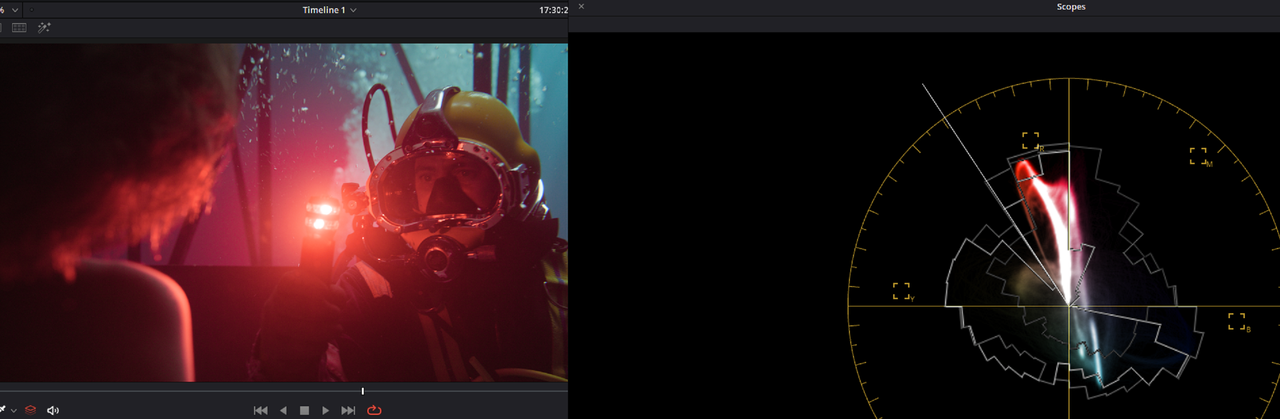

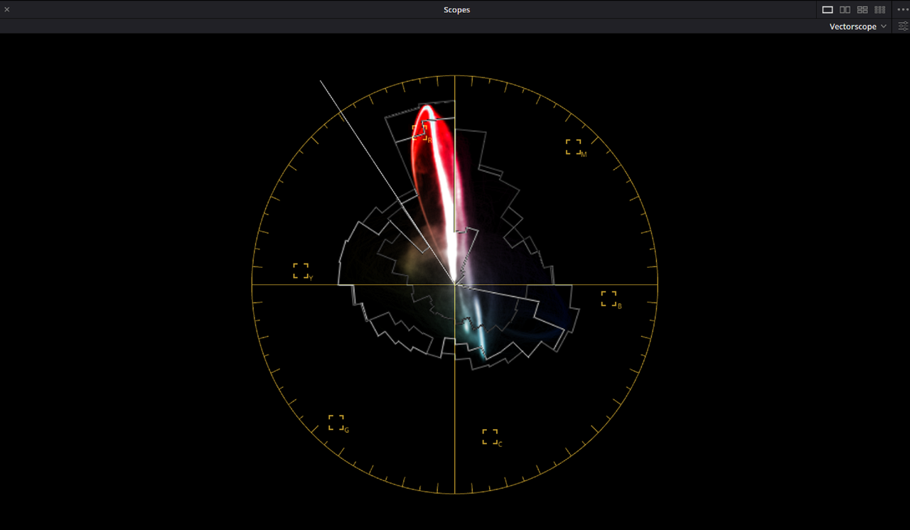

Here's a screen record of the video above next to a vectorscope .You can see how well the flashing red light is being controlled with the AWG4/ALC4 transform Lut applied.

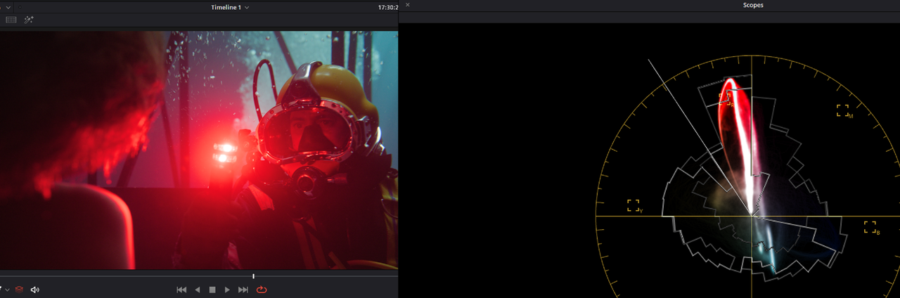

Out of Gamut Colors

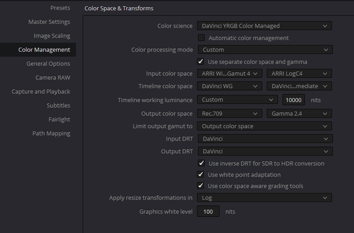

I'd be really interested in a "Write-up" if you have the time to do It. I've been basically messing around with how the AWG4/ALC4 TRANSFORM LUTs react with the older AWG3/ ALC3 Color Space so I haven't yet seen these Luts true performance with the AWG4/ALC4 Color Space yet. Yeah, I can't wait to see what we all find out over the next few months about the similarities and differences between the RWG/LOG3G10 workflow and the AWG4/ALC4 workflow. But the AWG4/ALC4 workflow is basically just ARRI's version of the RED IPP2 workflow.
I'd be really interested in a "Write-up" if you have the time to do It. I've been basically messing around with how the the AWG4/ALC4 TRANSFORM LUTs react with the older AWG3/ ALC3 Color Space so I haven't yet seen these Luts true performance with the AWG4/ALC4 Color Space yet. Yeah, I can't wait to see what we all find out over the next few months about the similarities and differences between the RWG/LOG3G10 workflow and the AWG4/ALC4 workflow. But the AWG4/ALC4 workflow is basically just ARRI's version of the RED IPP2 workflow.

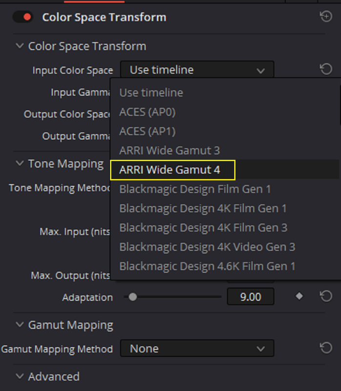

ARRI's new workflow being similar to RED's IPP2 workflow is a big step in the right direction and will minimize some chaos in post. I whipped up my transforms according to the white paper and a lot of math and testing. I'm certain Resolve will add this to their own CST plugin, perhaps even in the next beta. I do specify a different name on my transforms rather than calling them IDTs or CSTs. I use CGT mainly because you are transforming Color Space and Gamma Curve. I also take into account exposure compensation on some key manufacturer's transforms like RED or ARRI to account for 18% Gray being a different target. Actually helps a lot with studios using mine and other's transforms a lot to know who's you're using.

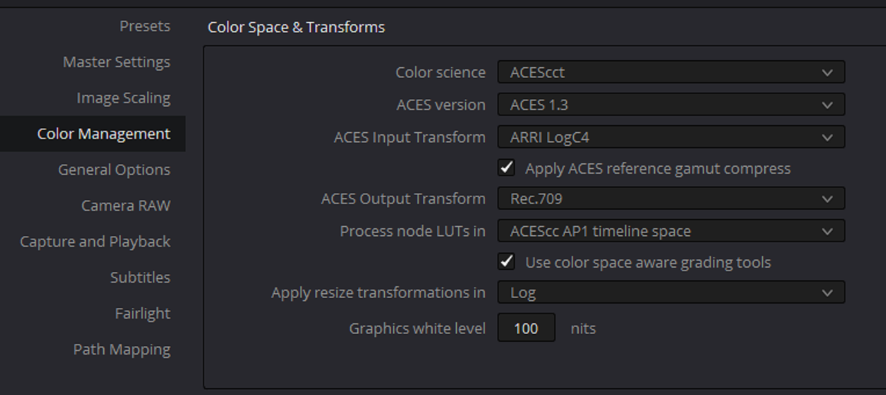

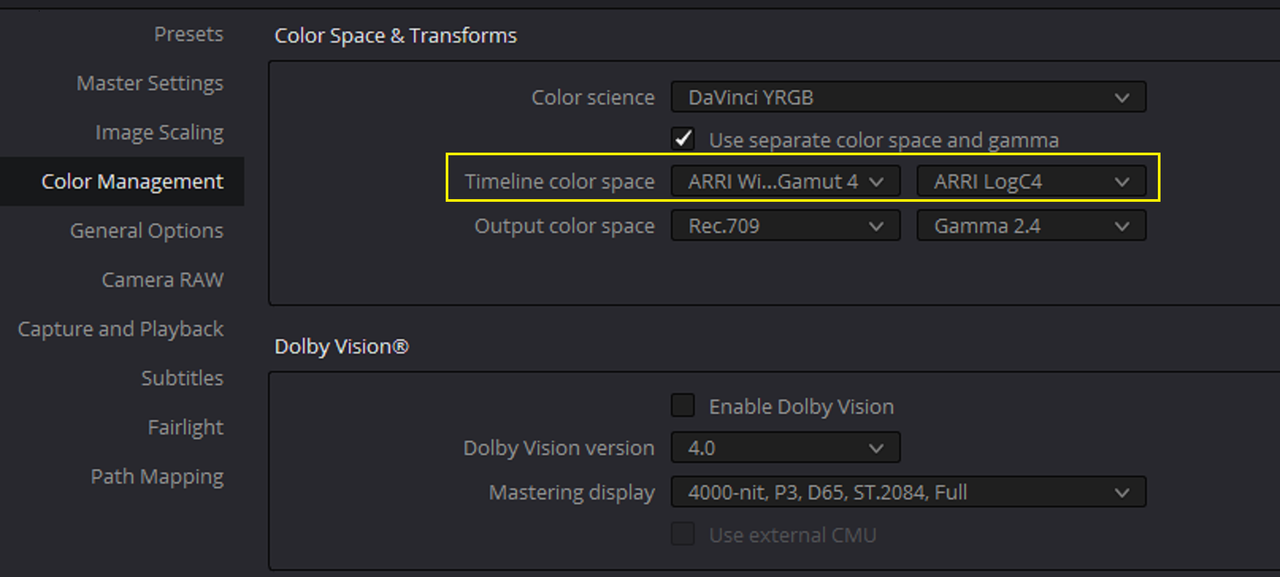

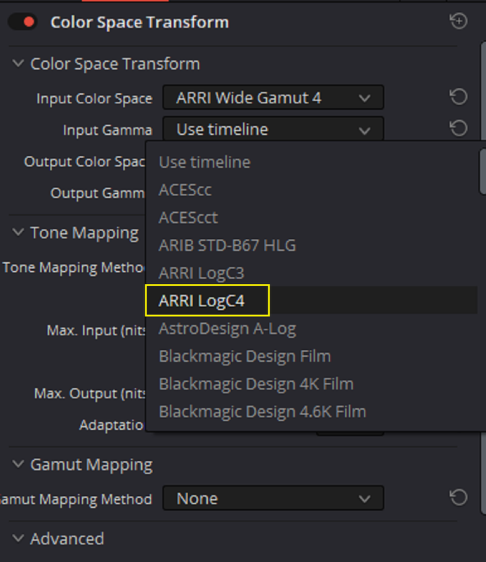

Yeah! I'm using ACES so hopefully they also add it to the 'ACES TRANSFORM" OFX as well since I use both the Project and Node based ACES workflows. I think I remember the new AWG4/ALC4 18% gray point being 28% and the AWG3/ALC3 being around 34 to maybe 38% .

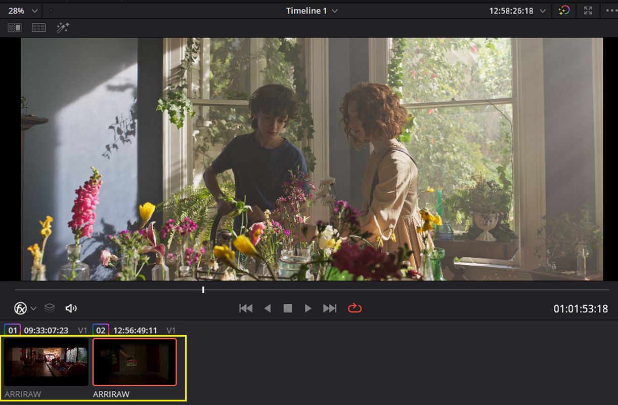

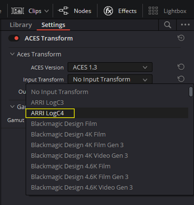

EVERYTHING ALEXA 35 IS HERE IN RESOLVE 18 BETA 6

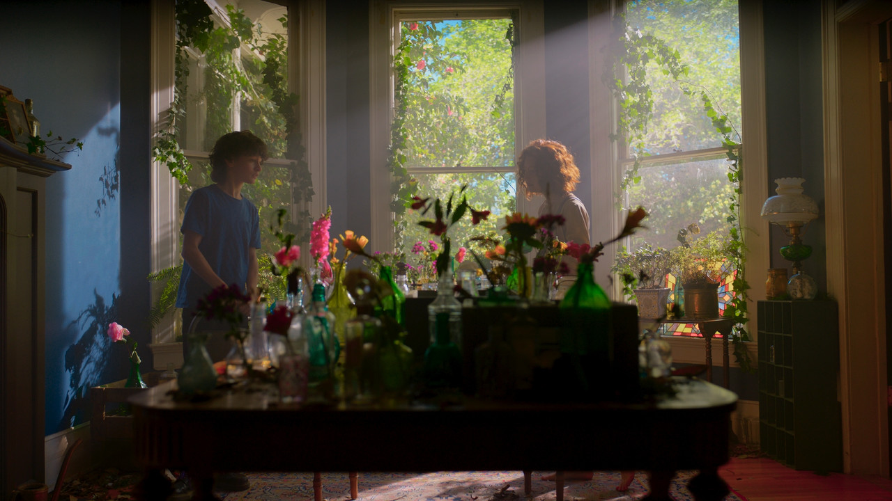

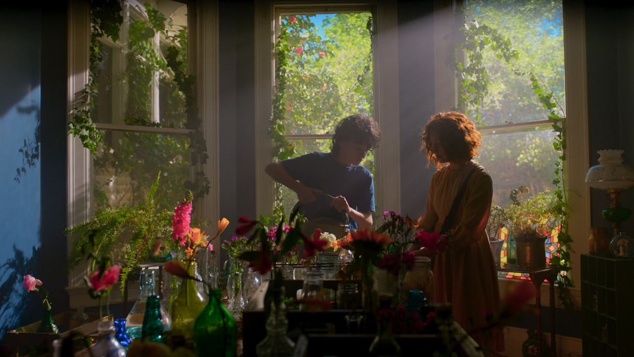

I've been trying to post a test of the "SWING" clip I uploaded here as a PRORES 4444XQ file but both RESOLVE keeps crashing and the video I posted on both Youtube and Vimeo had "Blacks" that were really lifted. So Here are a few frames from that 33 second clip until I can find out what's going wrong with Resolve 18 beta 6.
I think the Alexa 35 ProRes 4444XQ LogC4 files I posted on page 16 and 17 get deleted today and tomorrow , when they do I will upload them all again and this time for another 7 days this time. So let me know if one of the files you may have wanted to download has been deleted and I will upload it again.:thumbsup:
Here is the short ''SWING'' Test Video made from the ProRes 4444 XQ file I uploaded that I tried to export out of Resolve 18 beta 6 yesterday, don't know if it looks correct or not on your computer monitor.
Blacks are a bit too clamped. To much -- evening for a middle grade.
Alex,
Yeah, I uploaded another version. I was using a DTCL in ACES to invert the RRT. So I think that is the problem. It seems that every time I look at it it keeps getting darker and darker. I don't think I will be using that DCTL again, I'll just stick with the RRT in ACES and maybe try again later.
