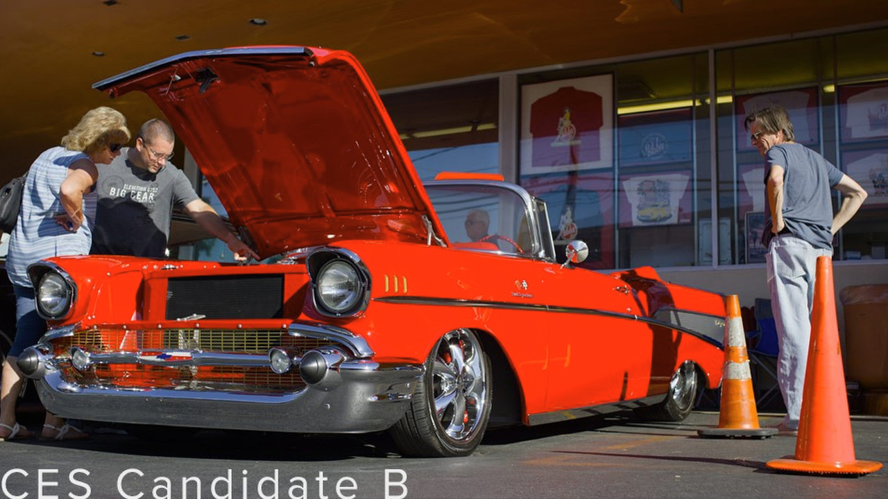

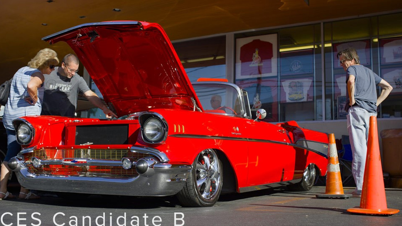

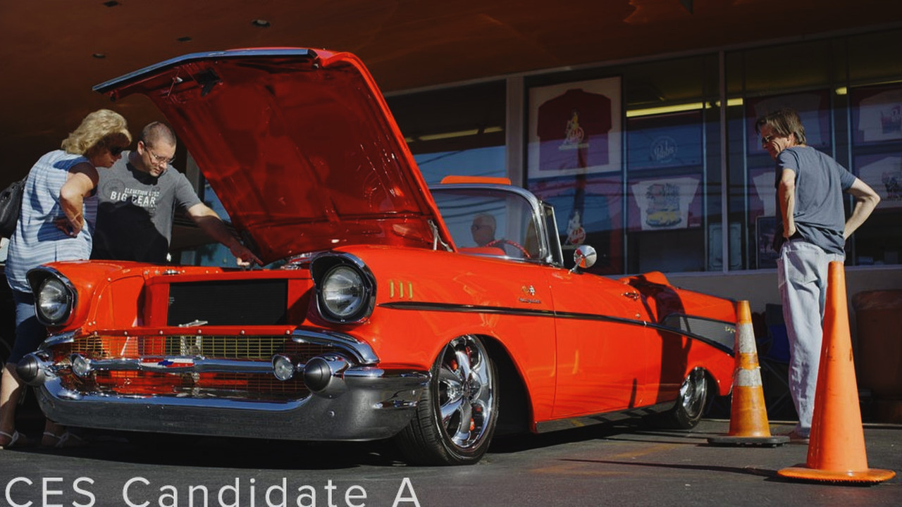

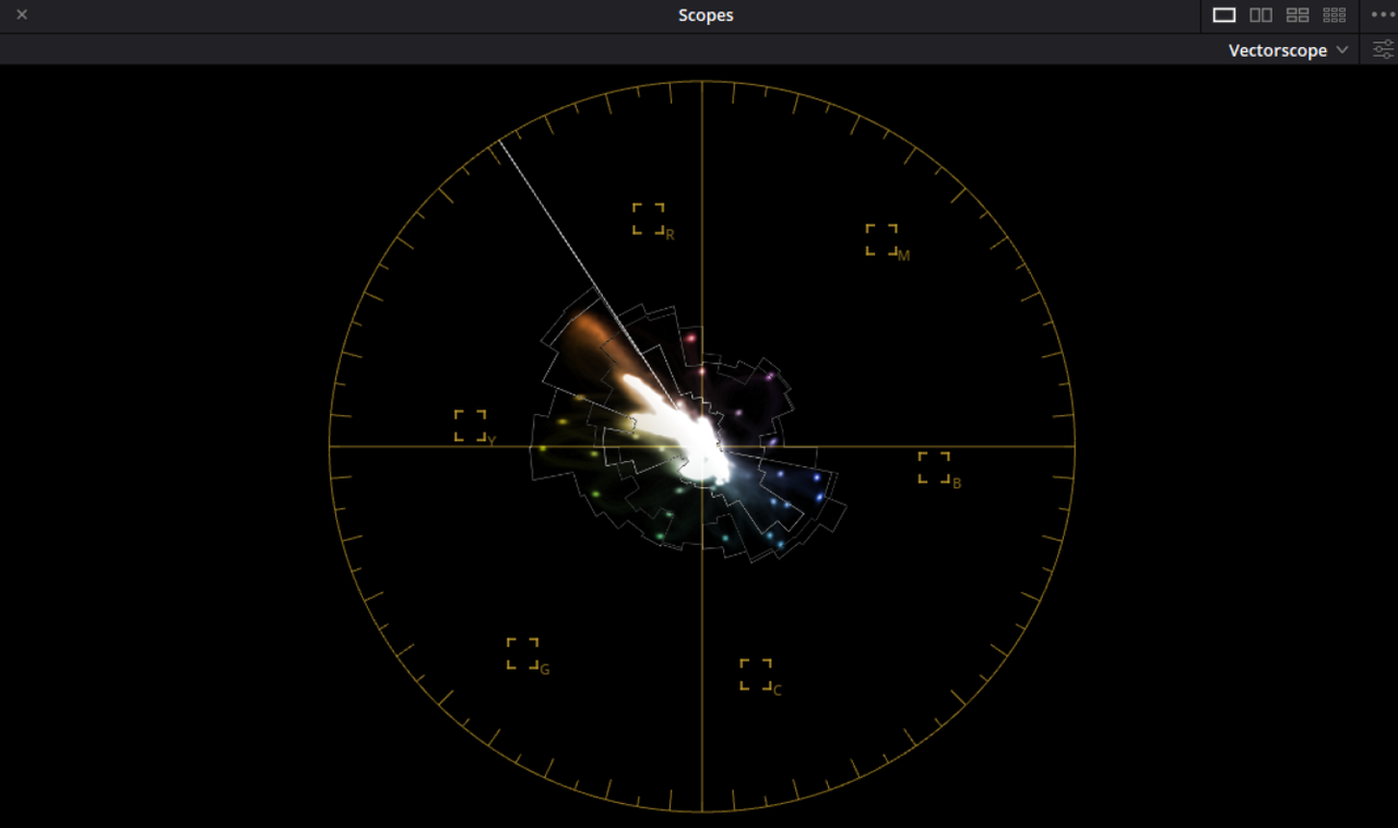

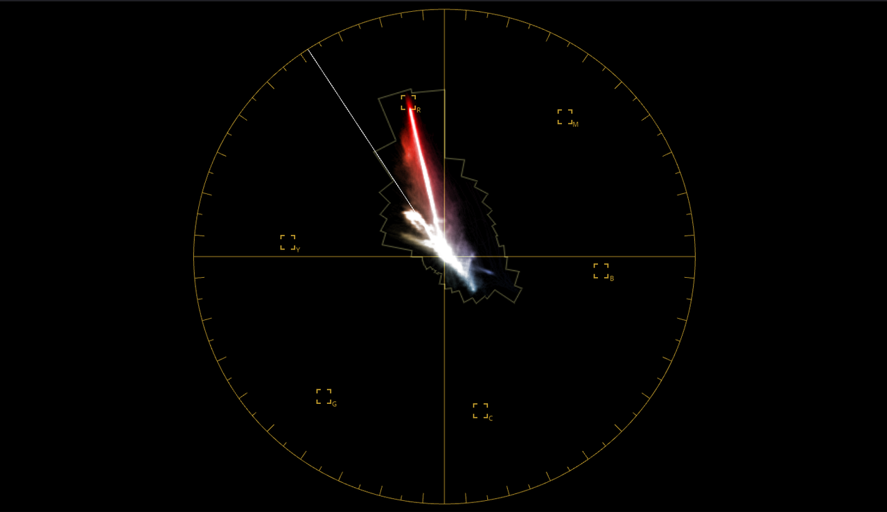

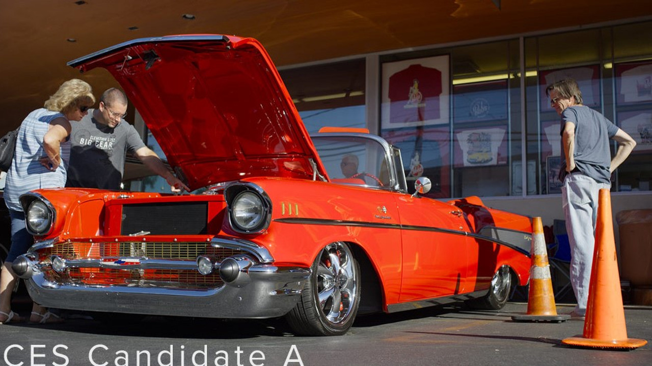

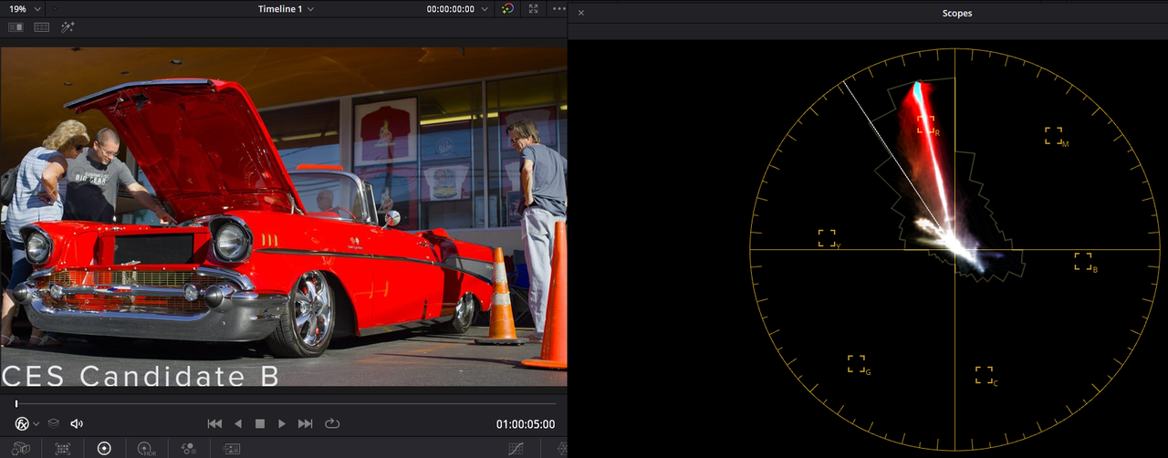

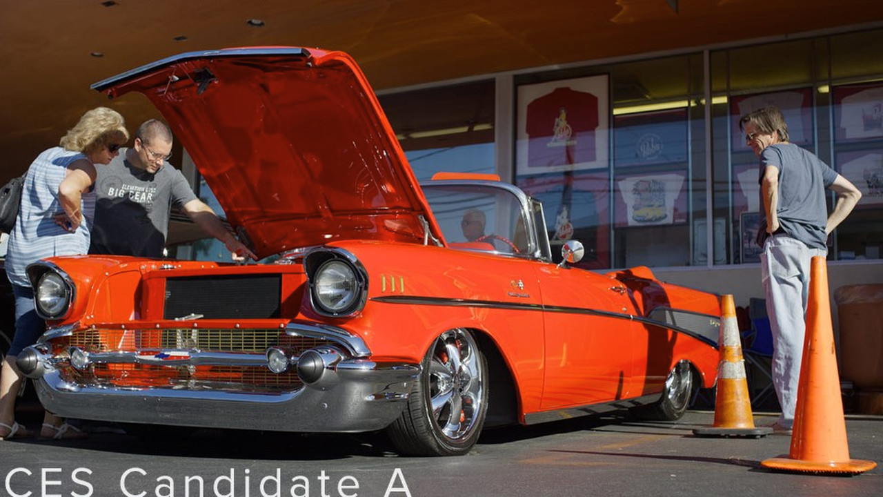

Keeping on the car for a moment Blair, how's this?

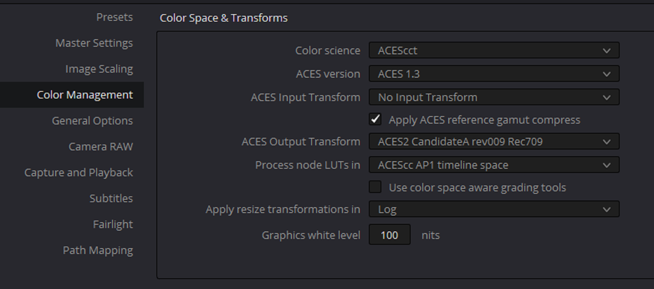

You can open that in a new tab for a closer look. Didn't include C because it's just too out of whack. Only providing two of my options here because I provide a few things. This actually is some new stuff that I'd be curious to get feedback on. I made a custom highlight roll-off to the ACES curve to somewhat get the car and cone to render better.
I've now had a full day to look at everything on the ACES side. It to me is still a work in progress and I still can't recommend the previous workflow due to color artifacts. Hue related ones.

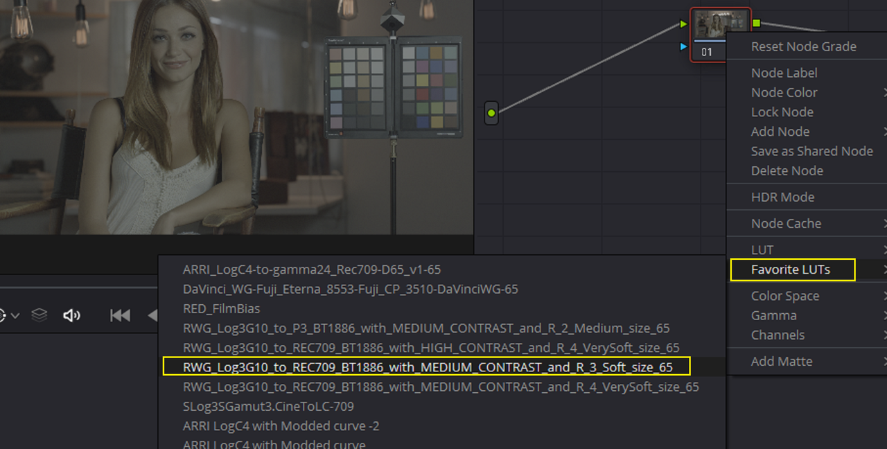

I can't stress enough. RED, Graeme really, put a great deal of time into doing this pretty right.

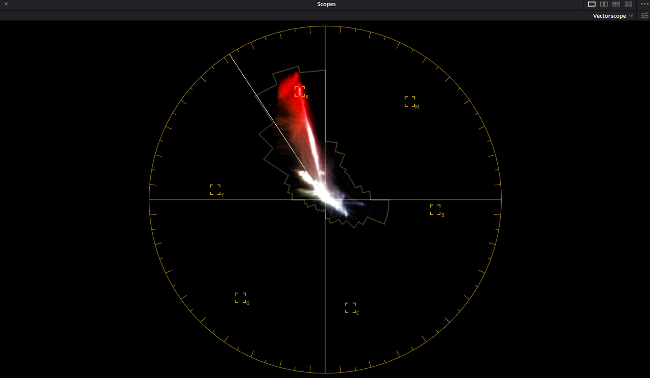

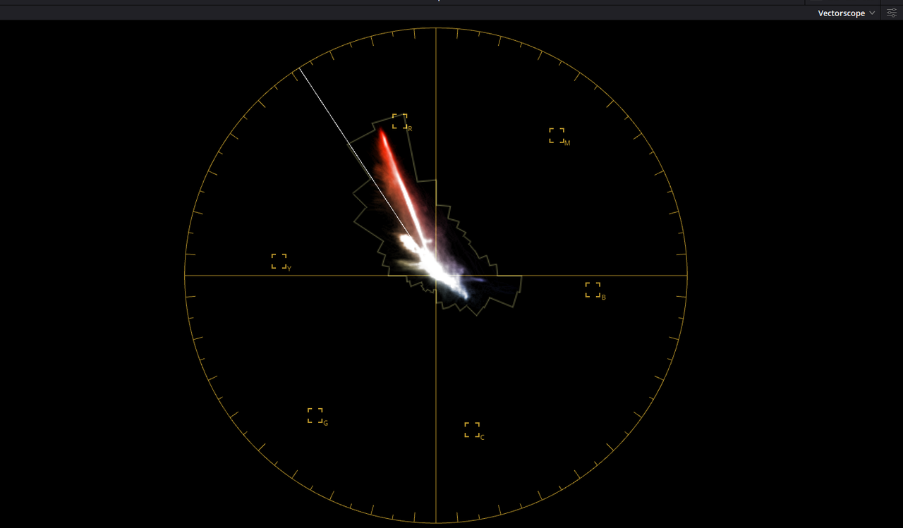

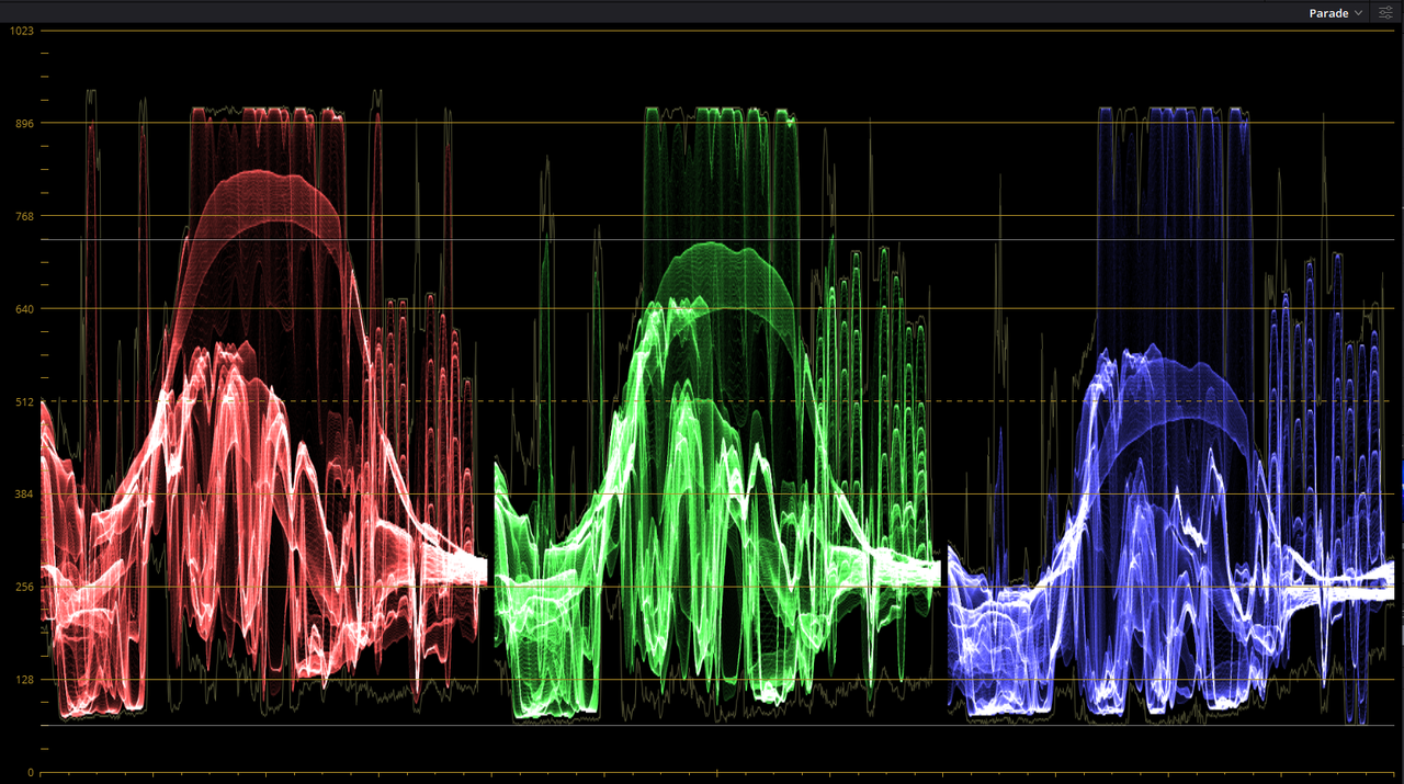

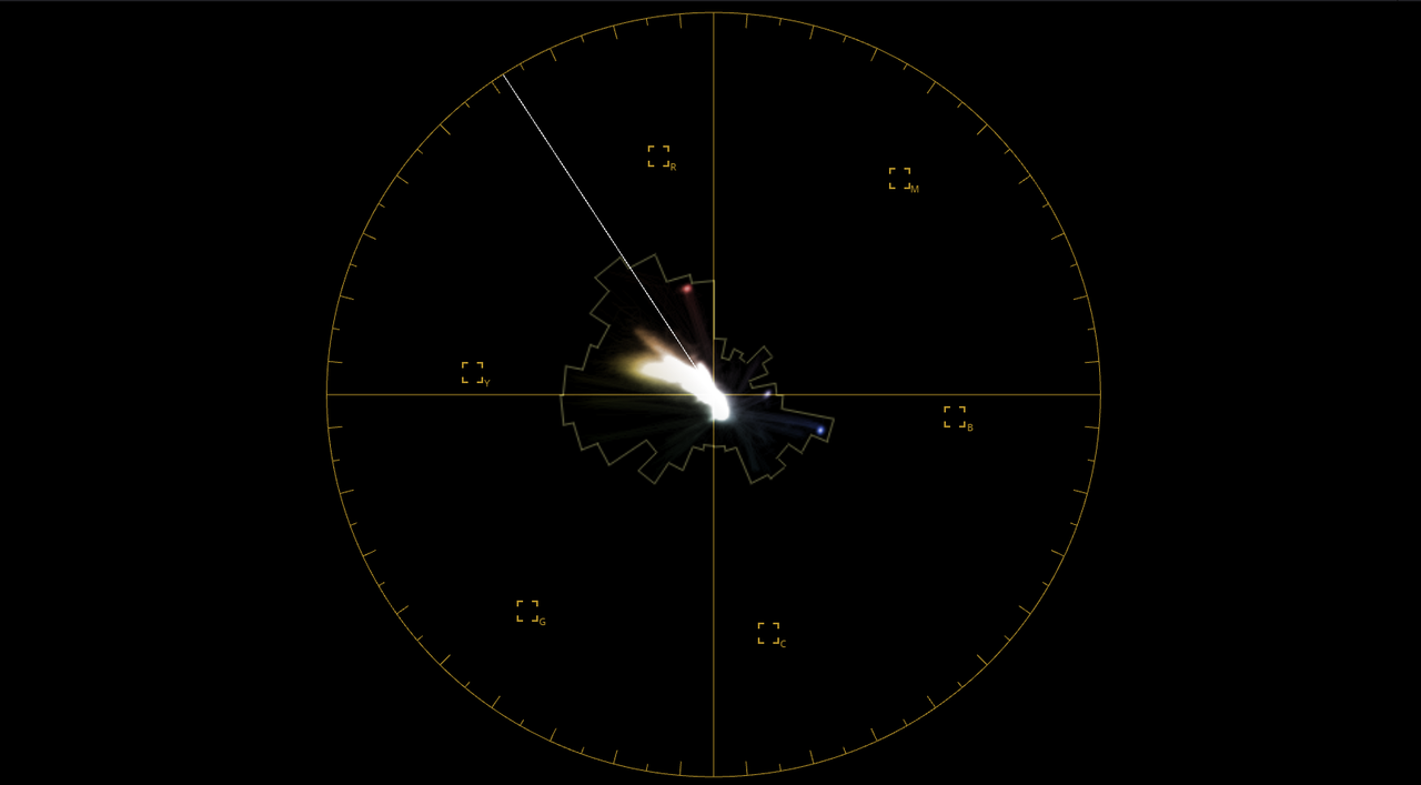

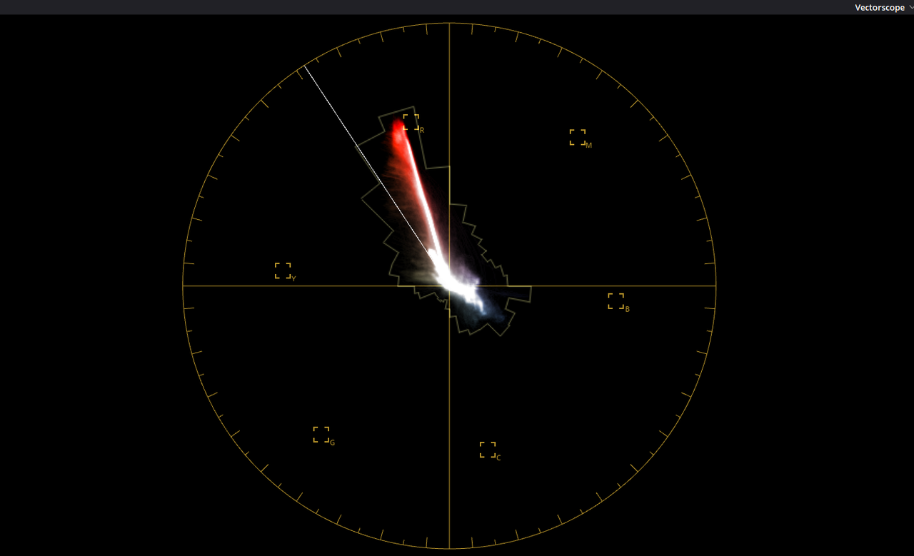

Thanks for doing this! I like the RED IPP2 Med/soft and both the ACES A candidates/with HRO. How Is A looking in the VECTORSCOPE with the additional custom HRO?
