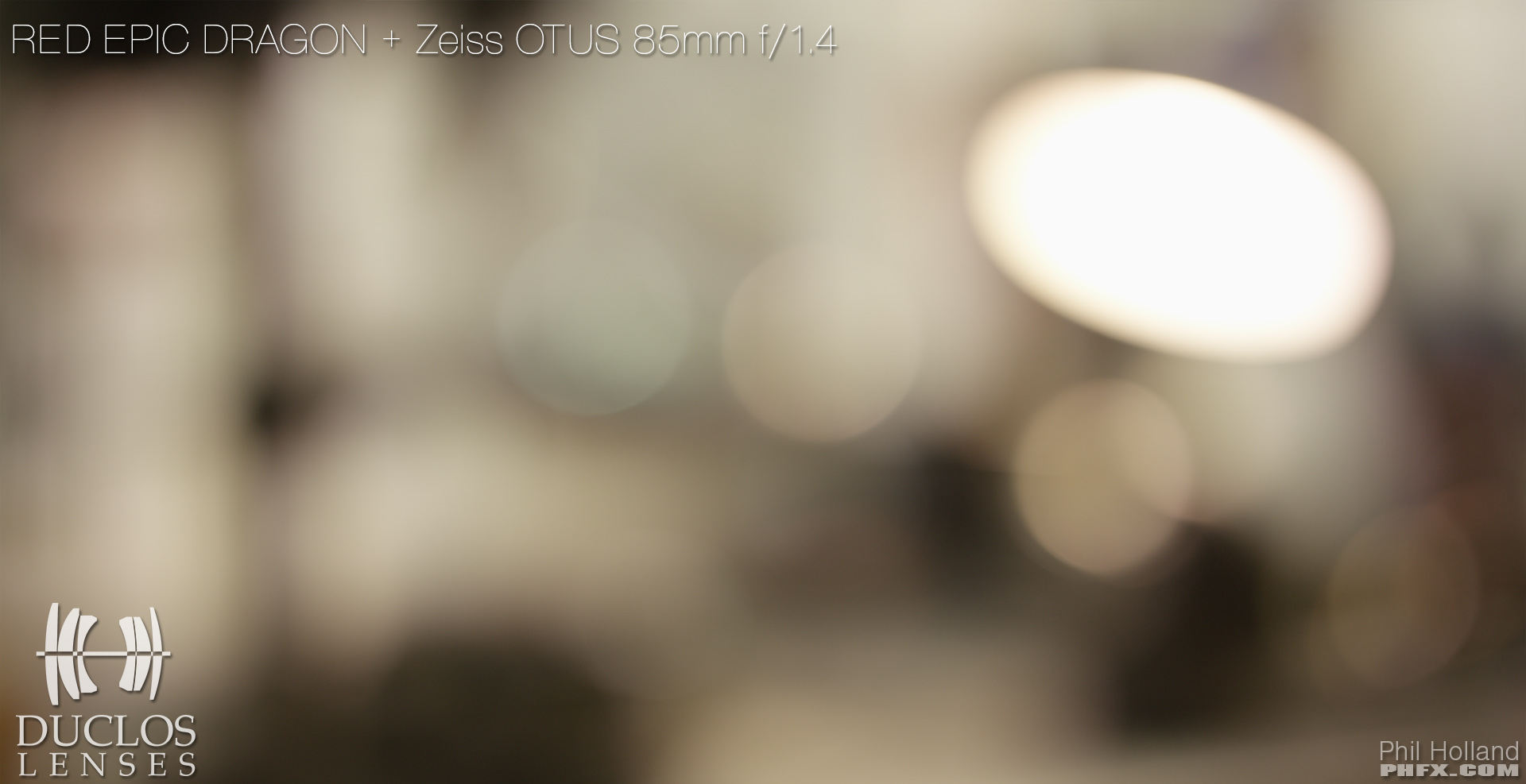

Resolving power goes to the Master Primes and even the Ultra Primes. Lateral Chromatic Aberrations are pretty wrangled on the Otus line due to the more modern coatings and aspherical design. The Master Prime 50mm T1.3 wouldn't fair that well against the Otus 55mm f/1.4 as it's the odd duck in the bunch and exhibits a good amount of CA. A solid set of MPs or Ultras though don't exhibit much CA overall though.
The Otus line was designed to cover FF35 coverage where the MPs and UPs are designed for S35, though over designed handsomely and most do a nice job covering Dragon 6K FF and resolving decently across the field into the corners, though that's where the Otus primes could show their strength really.
I will say MPs and UPs are a bit dated these days and the newer coatings and aspherical designs manufacturers are exploring can overall out perform them. Otus is using an alarmingly similar coating to the Compact Zooms and a few of the more recent CP.2 primes (135mm and 15mm) from what I can tell.
What does the Otus line up outperform? Zeiss CP.2s and Canon CN-Es pretty well.
The Otus focus mechanism sort of shows you these were a bit "designed for motion". So they do rather well on pulls compared to other still lenses. One day when the time comes these well be shoved into a line of properly housed primes that will be very interesting. The curious question is what will that cost? And are we talking 2 or 3 years? I'm privy to a bit of information on the Otus line-up and future lens releases, but there's still a few large question marks ahead as it stretches a bit beyond what's currently planned. I'm guess they will land in the $7,000-$8,000 price range per lens with the more cinema minded housing and they will likely have a 95mm thread at that point.
One thing that Zeiss did though is design the Otus 55mm f/1.4 to essentially trounce their 50mm f/1.4, which is oddly not so lovely in a few ways.
I dig the Otus Primes a lot. They are the best still lenses Zeiss has ever made really and they more or less out perform everything else directly competing with them. They are designed to have a rather nice bokeh, clean plane separation, and extremely wrangled CA. Which makes them very desirable for a lot of shooters.
Oh and the MPs aren't the "king of glass" for me. The Leica Summilux-C Primes are currently the highest quality cinema primes on the market when it comes to technical prowess. Aspherical, bloody sharp, extremely minimal breathing, and very good coatings as well. But these are again designed for motion and a heck of a lot more money per lens.
I have been thinking hard about grabbing the 55mm and 85mm myself.
