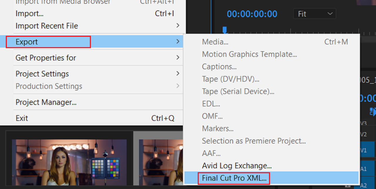

You want to export the project or clips in question out of Premiere pro as a Final Cut Pro XML file and then import that XML file into Davinci Resolve. I use to do this when I was using Avid Media Composer with Resolve however it was an .AAf file that I imported into Resolve.
I don't know about an Xml import from Premiere, but with the .AAf files from Avid it gave you the Option to Relink to the Raw files from Avid into Resolve.
Here is a video of the Premiere XML export.

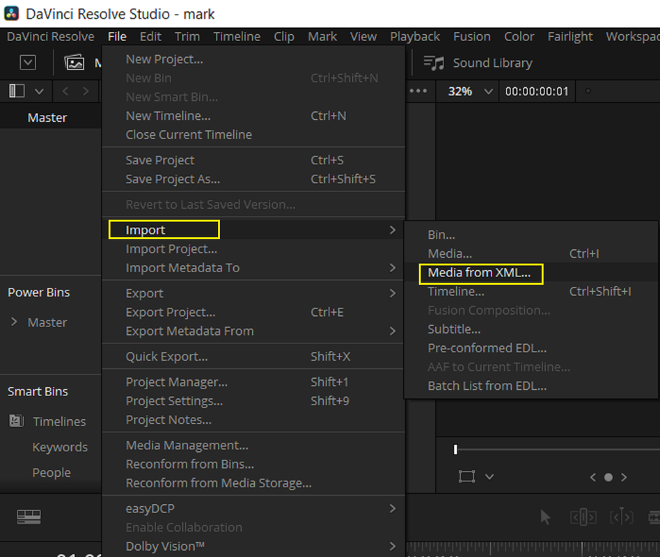

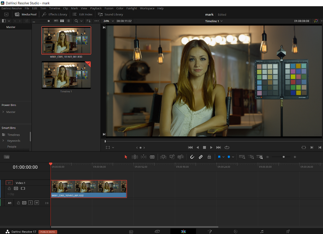

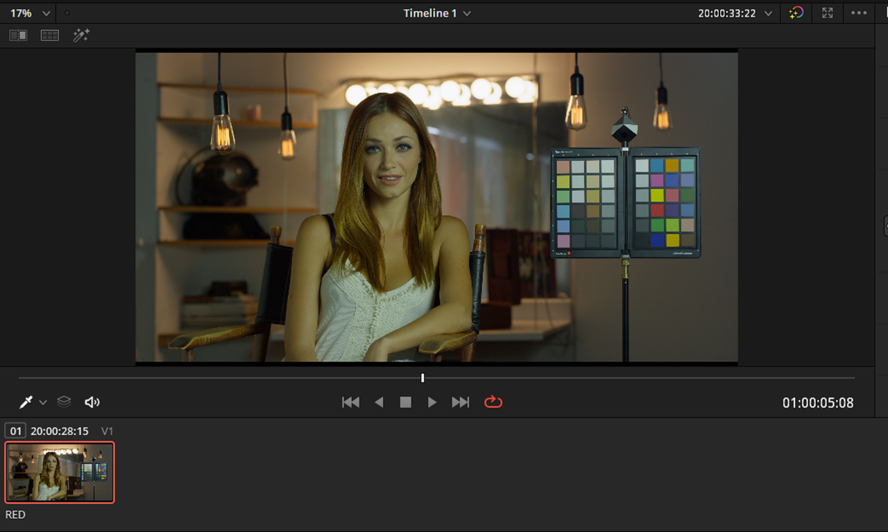

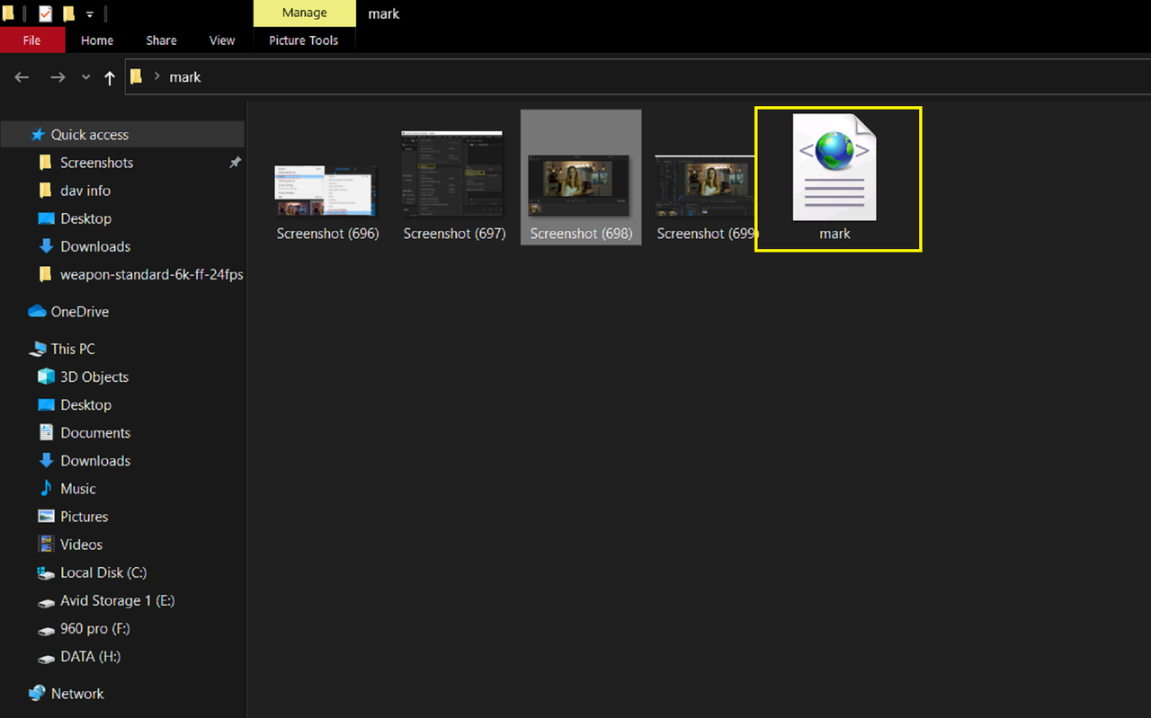

Here's a quick example I just tried with Premiere and Resolve. It brought the XML import from Premiere in as an .R3D file into Resolve.
Timeline
Color Page

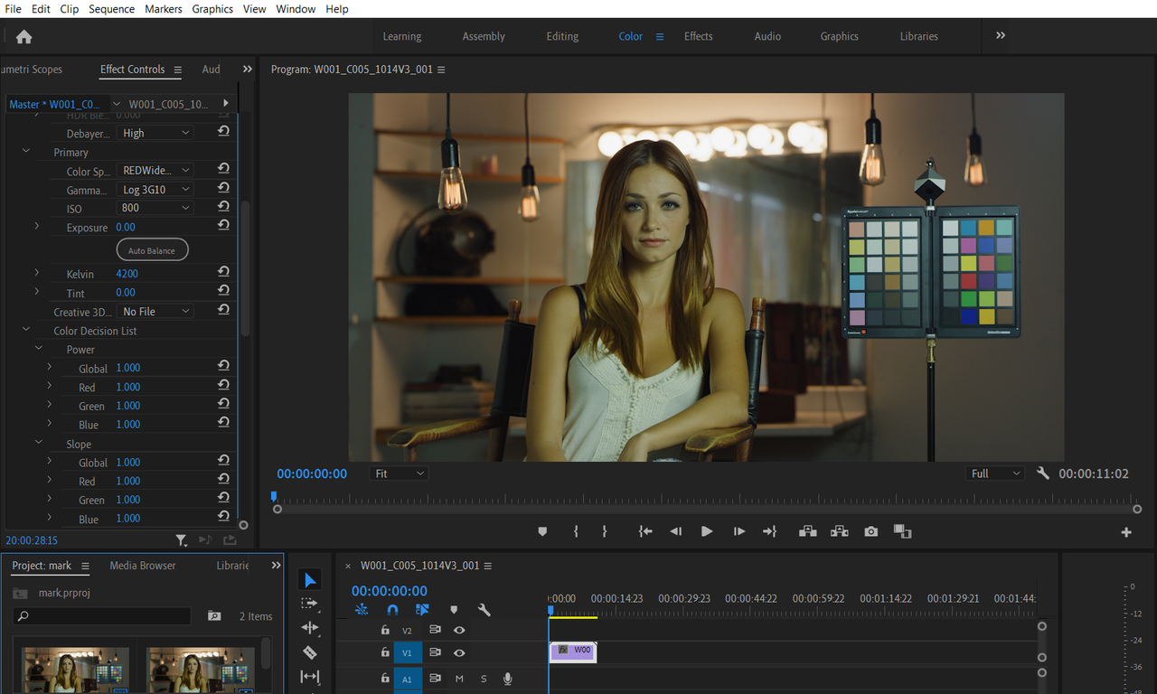

I loaded one short R3D into Premiere Pro and applied the Zeiss distortion and Zeiss shading corrections. I masked the shading to be able to easily tell if the correction passed to Resolve. It did not. I didn't get that far. The Premiere Pro XML Translation Report said "Settings on clip XXX not translated. Sequence <ZZZ> at video track 1: Effect <Zeiss Lens Distortion Correction on clip XXX not translated." A similar message regarding the distortion correction was also in the translation report.
