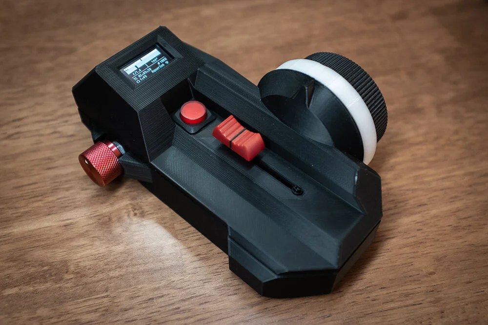

We've built a WiFi Follow Focus hand unit with other various controls called ROVER. It can be connected via WiFi to RCP2 cameras in ad hoc or infrastructure mode - even over the internet for remote shoots, so long as the camera IP address is reachable over the internet.
Follow Focus & Iris work with Autofocus lenses.
We are considering adding user-config buttons. Curious how many user-config buttons might be ideal?
Any other feedback before we go into production would be great. This was built with remote shoots in mind, but it turns out to be a great wireless FF unit for minimalist setups - no need for further accessories.

Working Prototype:
