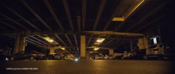

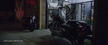

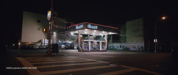

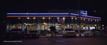

It all depends on your shooting style. Your get great results from either OLPF. Here's some stills from the new OLPF on a low light test with mix sources.

Thanks Paul. Actually shot on the Allstar 18-35mm 1.8t zoom.
