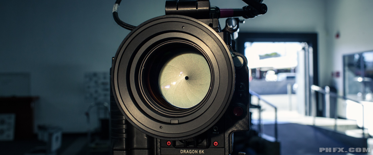

Any videos from this lenses? Is it full frame, s35 or what? How many blades do they have? Do they sell them or is it only for rental?

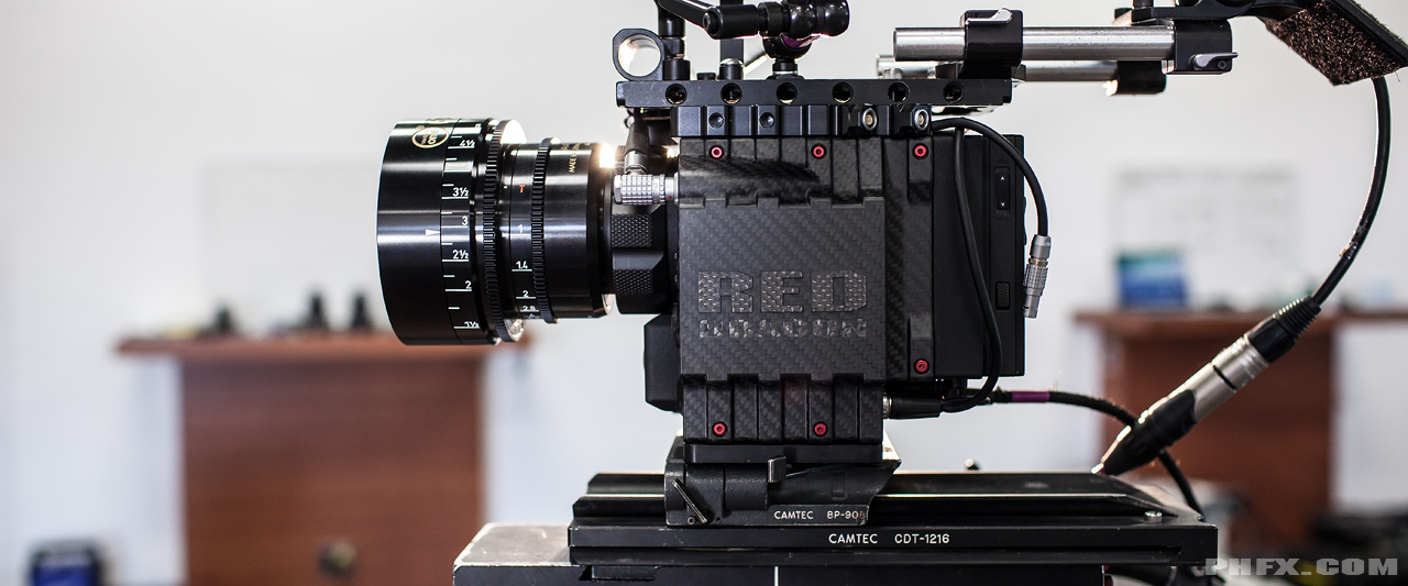

There are two houses that have them here in Los Angeles. Camtec and Keslow Camera. They are very expensive if you can purchase them, but I don't know the specifics behind what it would take.
There are currently 5 lenses available: 25mm, 40mm, 65mm, and 90mm. The most recent addition is the 17.5mm T1:
I believe all of the lenses have and will use a 16 blade iris:
I need to spend more time on Dragon with them, but these are designed for S35 and do cover Dragon 6K. Though I can't say anything for sure about the 17.5mm. It does at least cover up to 5.5K on Dragon though.
