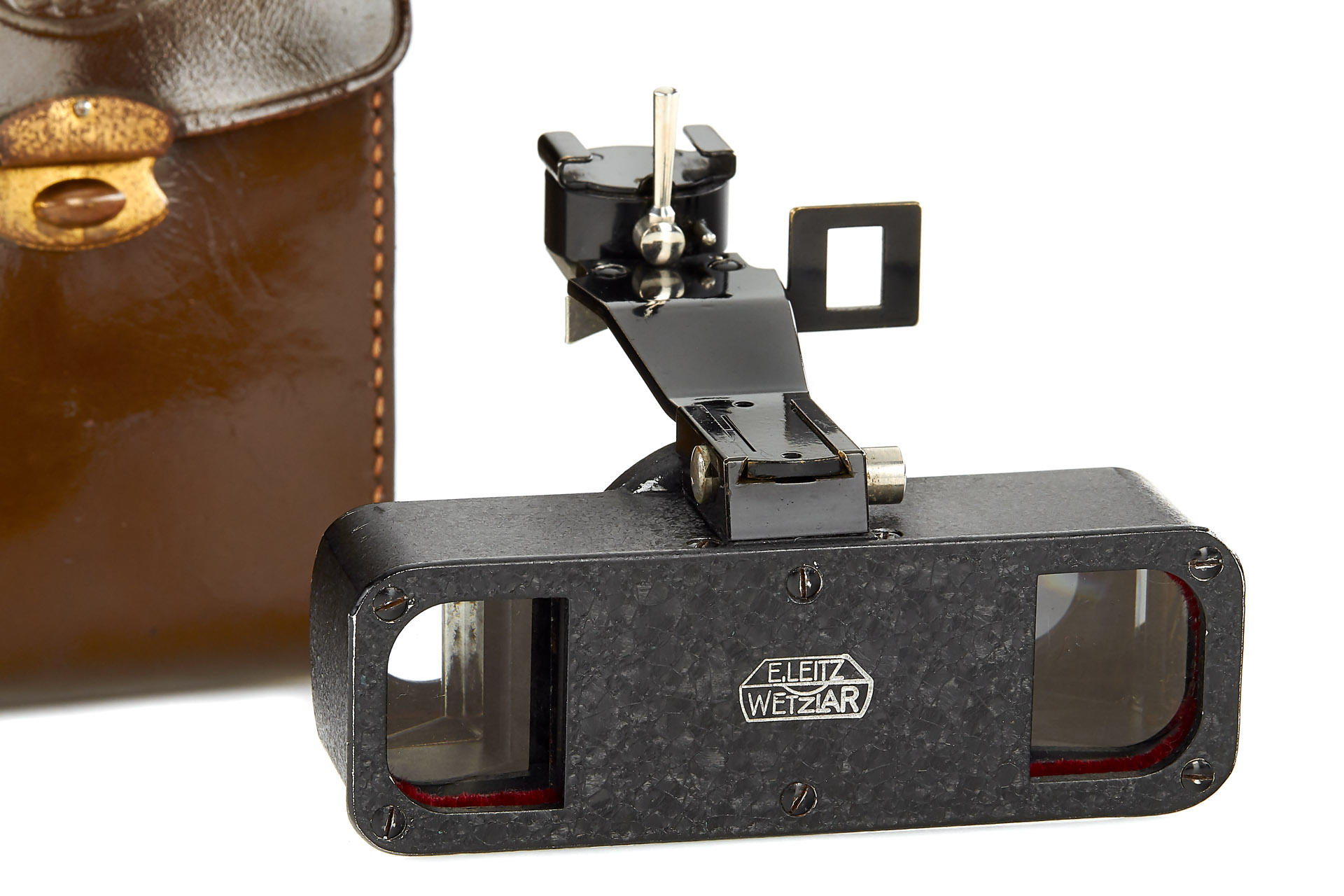

And, is a beam splitter something like this?:
A final thought: everyone has a camera with them these days. So, those who want to stand out should carry a stereo camera. That's worth a thought.

5. Compatible beamsplitters
What I saw done with both Kinefinity and Z-Cam was people taking the sensor out of the box.
Depending on your desired lens, you likely would only need one such modified brain, as you can place the extended lens next to a normal cam.
Recently I saw the front + sensor of a Komodo, and I didn't saw too many connections, if I remember correct only two flex PCB bridges.
However the PCB holding the sensor was still larger than an average IPD.
Such method would not allow only stereoscopy, but even VR - which a beamsplitter cannot.
