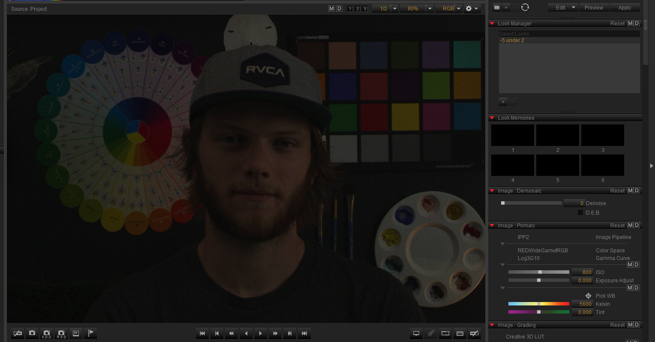

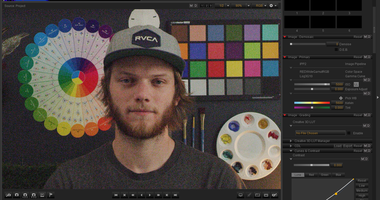

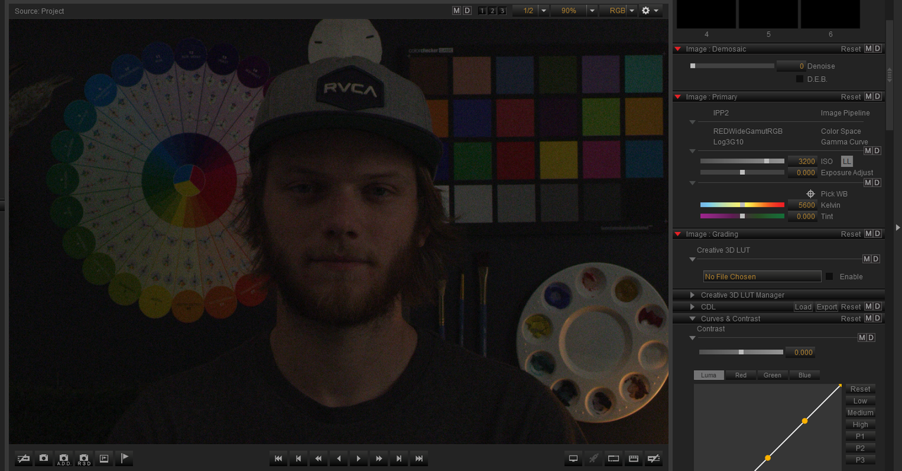

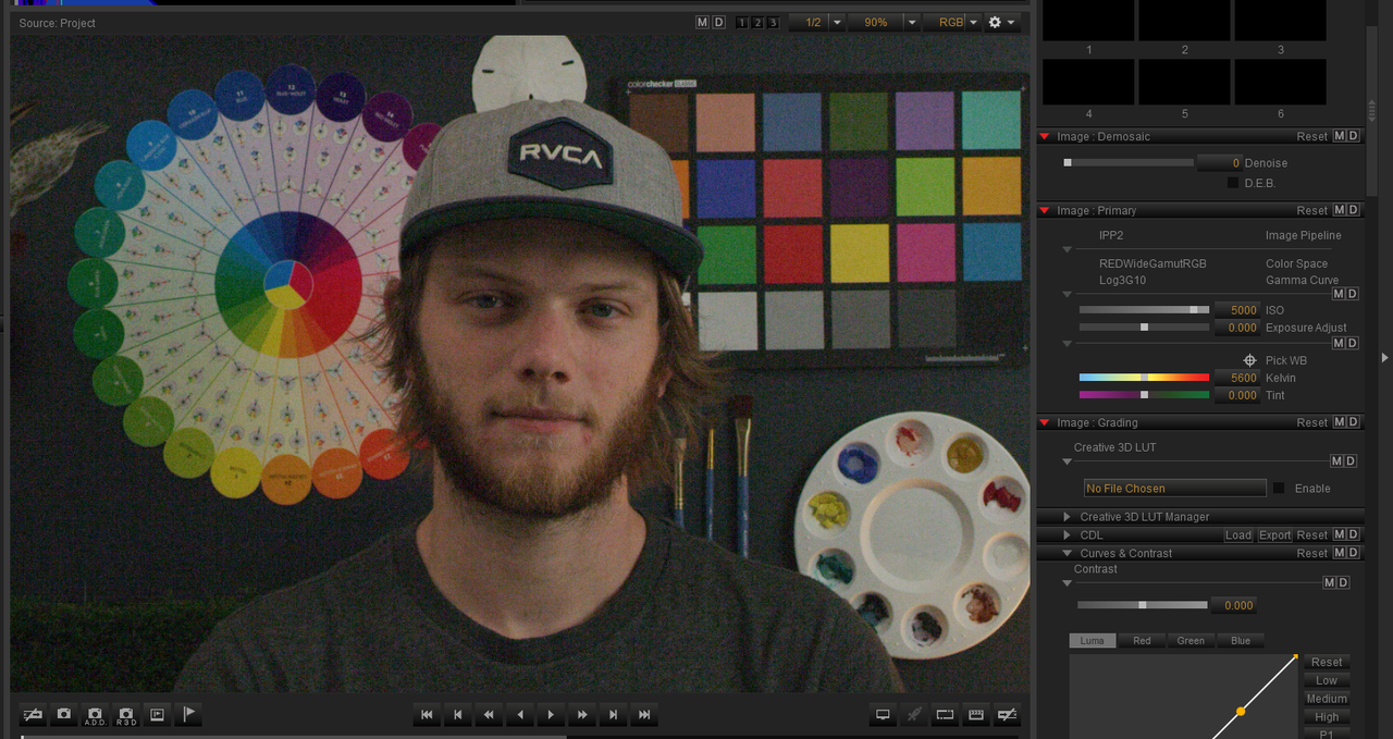

Here is the original Metadata from both the "Standard" and "low light" from the "-5 under" images. Next, both raised to ISO 5000. I think something may be wrong with his test. Maybe because he used "Redlogfilm" instead RWGRGB/LOG3G10. The "Low Light" raised to ISO 5000 should have less noise and look much better than the "Standard" raised to Iso 5000. So I think something went wrong in his methodology.
Standard Orig Metadata of Iso 800
Low light Orig Metadata of 3200 Iso
Standard Iso raised to 5000
Low Light Iso raised to 5000
