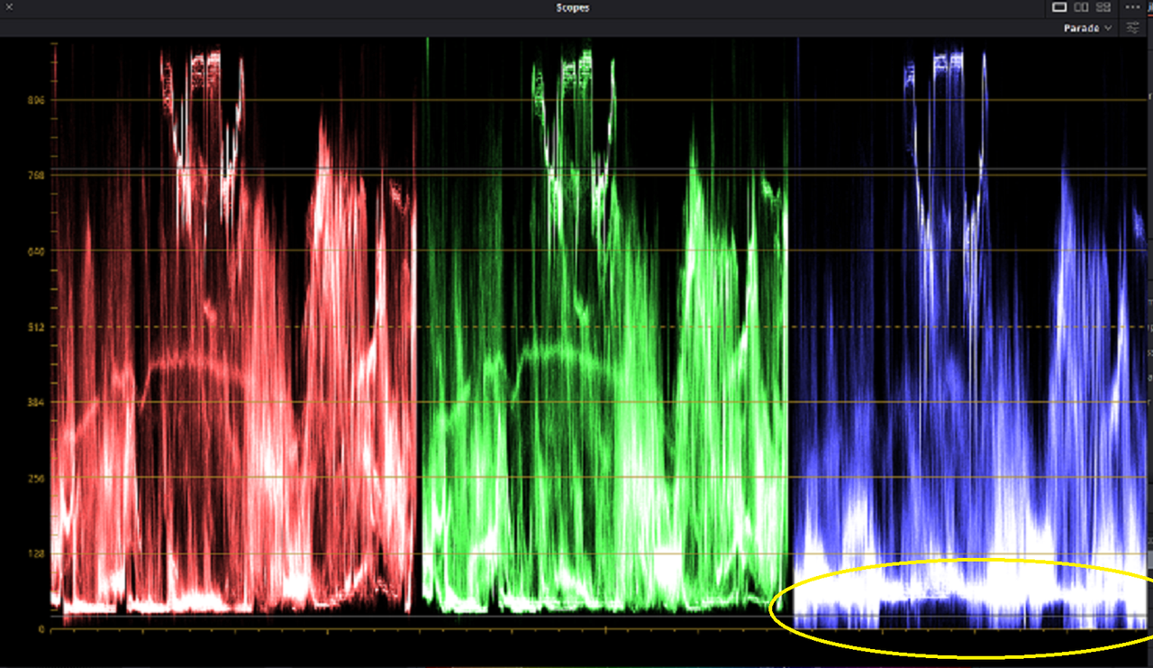

It looks like ACES was used. Here's my attempt to correct it.

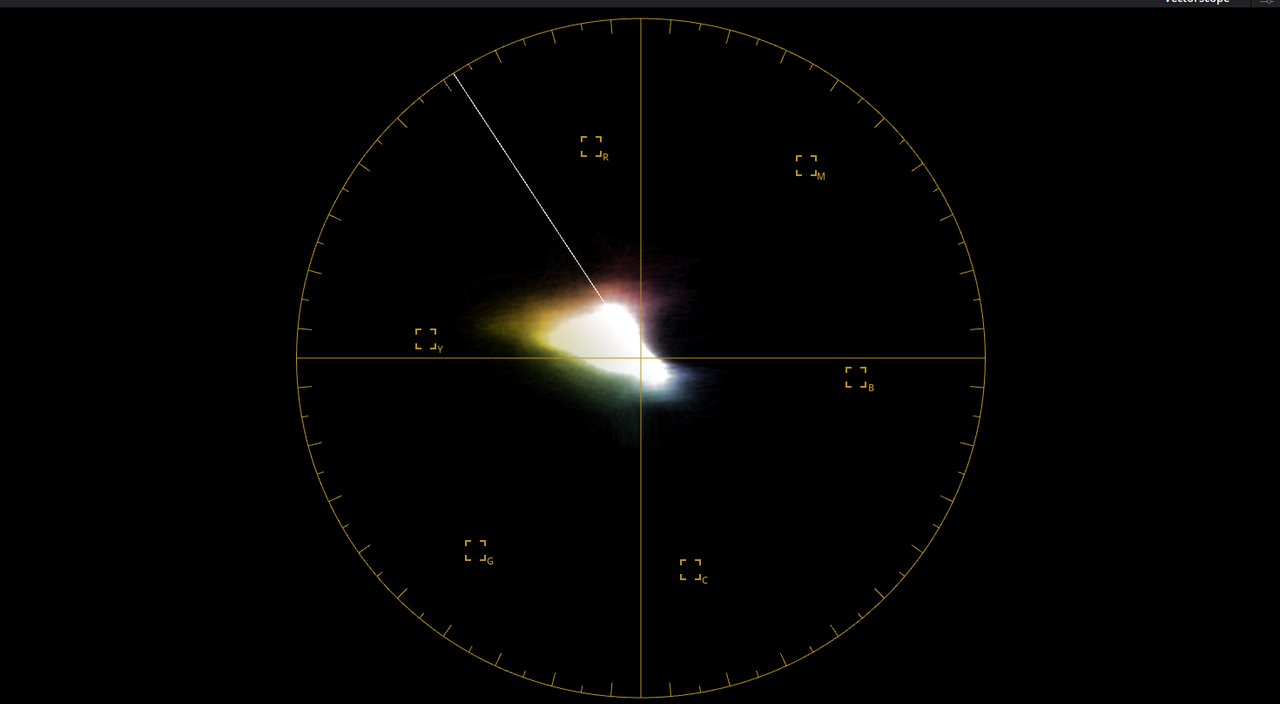

The reason I guessed ACES was from looking at the Vectorscope and the way the blue's shadow area looked. I personally only see that in an ACES workflow of ProRes images of red footage. But I could be wrong.

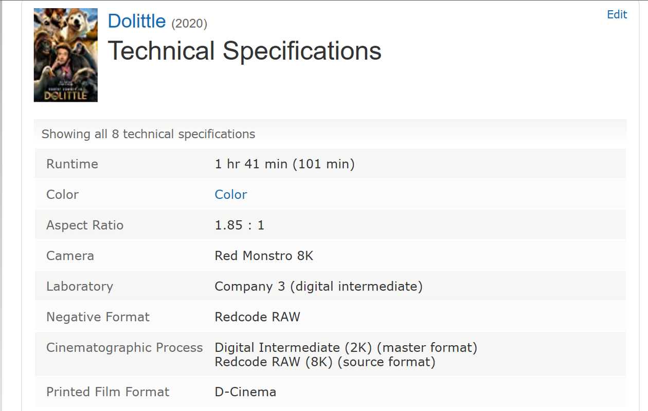

Also "Company 3" graded this so it's kind of hard to believe they did something wrong.
