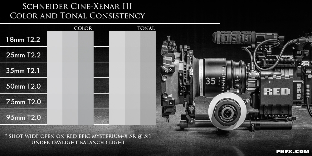

I'm sure Martin's set is the same, but color and tonal accuracy are a huge thing for me. The SCXIIIs are dead on matched:
