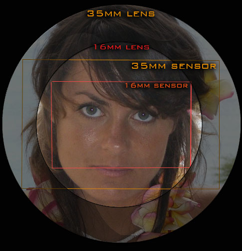

Aaron, first of all don't put a Super16 lens on a 35mm FILM camera as the rear element may strike the shutter. On Red though it's quite possible to do as there's no shutter to get in the way.
That said, a 25mm lens is always a 25mm lens, but the FIELD OF VIEW will change depending on the sensor format size. Here's an image rescued from an old thread that shows how this works:
As you can see, the FIELD OF VIEW changes, but the real DEPTH OF FIELD won't as it is fixed for the lens and aperture you are shooting at.

Great illustration!
Thanks Paul, that will come in handy when explaining these issues to students.
