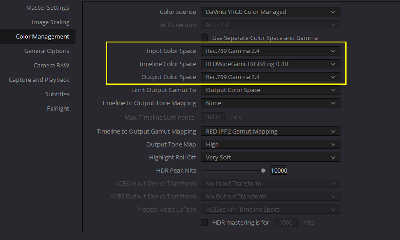

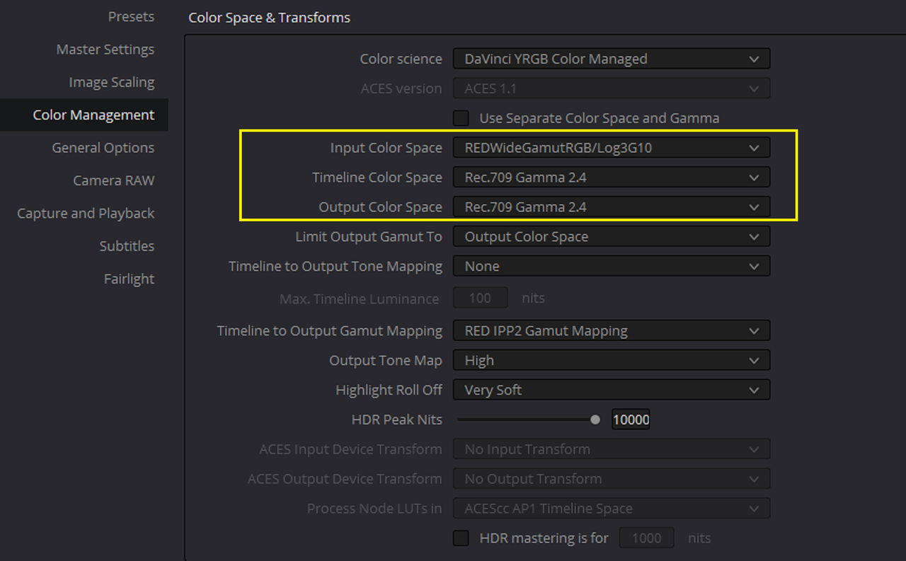

There are more than couple of niggles in Davinci Resolve when working with Red material... I completely accept this is not really anyones fault but rather a product of different approaches not marrying 100% as of yet...
BUT I'd love to be able to!
1) use Resolve Colour managed workflow for all my RED projects
2) not use a LUT to get to Rec709 or (but rather GN's maths in the form of 'IPP2 output mapping')
now this is possible until I introduce footage that is not Red raw... either Red VFX stuff or other camera rushes. Unfortunately the engaged IPP2 output mapping effects all the footage on the timeline...
is there a rational explanation for this and is it avoidable without going back to unmanaged or LUTS??
thank you!!

IMHO i love the fact that the IPP2 processing is applied to all footage on the timeline. I find it easier to match and integrate footage this way - when it is sitting under the same contrast and rolloff curve.
It may depend on the camera though, so for example
cDNG flies work wonderfully - because they ignore the input space and are debayered into linear and so long as your raw settings are correct the IPP2 rolloff works wonderfully with them.
Any VFX work should be delivered back in RWG/LogG10. I do work in Nuke and at the end of the chain put it back to RWG/LogG10. Any viewing LUT i use to work with the footage is just for viewing - it doesn't get baked into the output files. So bring those QT VFX movies in and they work the same as the source RED files - you should be able to flip between before and after footage.
Any camera file like Slog2 from an A7sII works well so long as you right click on the footage and interpret it correctly, otherwise it would be read in as RWG and you don't want that. But IPP2 the end of the chain works well.
The key is that any other source needs to be interpreted correctly for Resolve to linearise it internally and therefore that final stage have the IPP2 work done on it. What it won't work so well with would be baked movie formats already into display space, like 709. But if you interpret those correctly I'm my limited experience with those files they work fine.
IPP2 has some nice contrast and desaturated roll offs - really helps with all footage.
cheers
Paul
Thanks for responding...
If you have a master file (finished) cut in with new rushes this is disastrous... no?
ideally but this is not always controllable or possible... and when you bounce out some footage for a designer to do some quick motion GX this is very very unlikely...And what is just ridicules is asking the Designer to export GX from photoshop etc in RWG/LogG10
I agree and it has been fine with some Arri stuff (even A7S was ok)... Phantom 4k was less appropriate but just about ok.
the bottom line is that is works when it does but sometimes doesn't (program masters etc, Gx from a designer etc... )....
It is seems it is a bit of a fudge to keep Red guys happy if you read the relevant sections in the latest manual... (there is a whole bit missing which in a manual this size suggests is because it is a fudge)
If all you do is hermetically sealled RED projects then it is fantastic (but then why even bother with colour managed) and it is fine for most mixed editorial rushes creation... other than that it feel like it is wrong or I am doing something wrong... ;-)
Yes, in that case that's not going to work. In which case you're better off adding the appropriate nodes as part of a shared node at the end of node tree i would think.
If it's photoshop work then would it not be better to take the assets in (with alpha) and comp in Resolve? Interpret as sRGB and it should be okay - unless you're looking for super saturated RGB colours?
I don't know if it's a fudge or not - it's no different to an ACES workflow where the same ODT is used across all footage - you'd be in the same boat there if you have to work with footage that is display referenced.
cheers
Paul

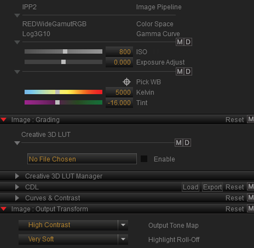

Michael,
The Color managed settings you are using will give you different looking results.

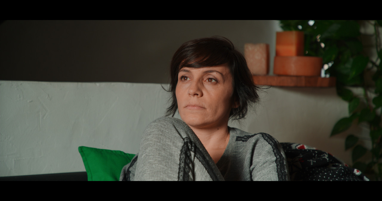

Here is a File from Luigi Valtulini. First processed with the settings advised by Peter Chamberlain of Black Magic Designs. And , Your settings
High Con/ Very Soft used
Original
with a lut I made for this specific image for a REDWidegamutRGB/ Log3G10 image, with a curve to reduce overall brightness. This looks the same way as it did in a Non Color Managed REDWidegamutRGB/ Log3G10 project
Image with your settings along with the lut I made for this specific image for a REDWidegamutRGB/ Log3G10 image, with a curve to reduce overall brightness. It seems it didn't respect either the curve I used to reduce overall brightness or the Very Soft Highlight Roll-off

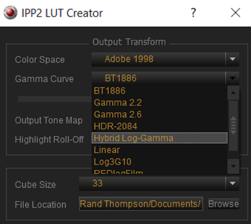

And if you are going to use Photoshop for your VFX work, why not make an IPP2 Output Transform Lut that transforms the REDWidegamutRGB/ Log3G10 image into Adobe 1998 and whatever gamma you need?
I know this all uses a Lut, but its probably what you will have to use atleast in a non Color- Managed project with specific Raw settings for the different camera material you will need.
But maybe I am misunderstanding what it is that you are asking.

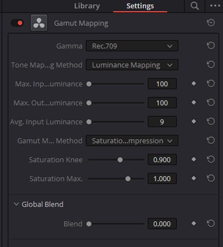

Micheal,
If you do use ACES the "Gamut Mapping" OFX tool can help a lot with Tone Mapping, especially with Red .R3D files

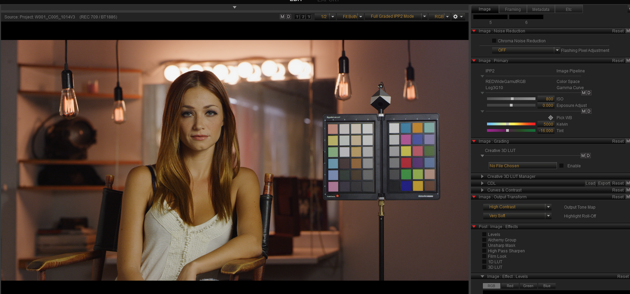

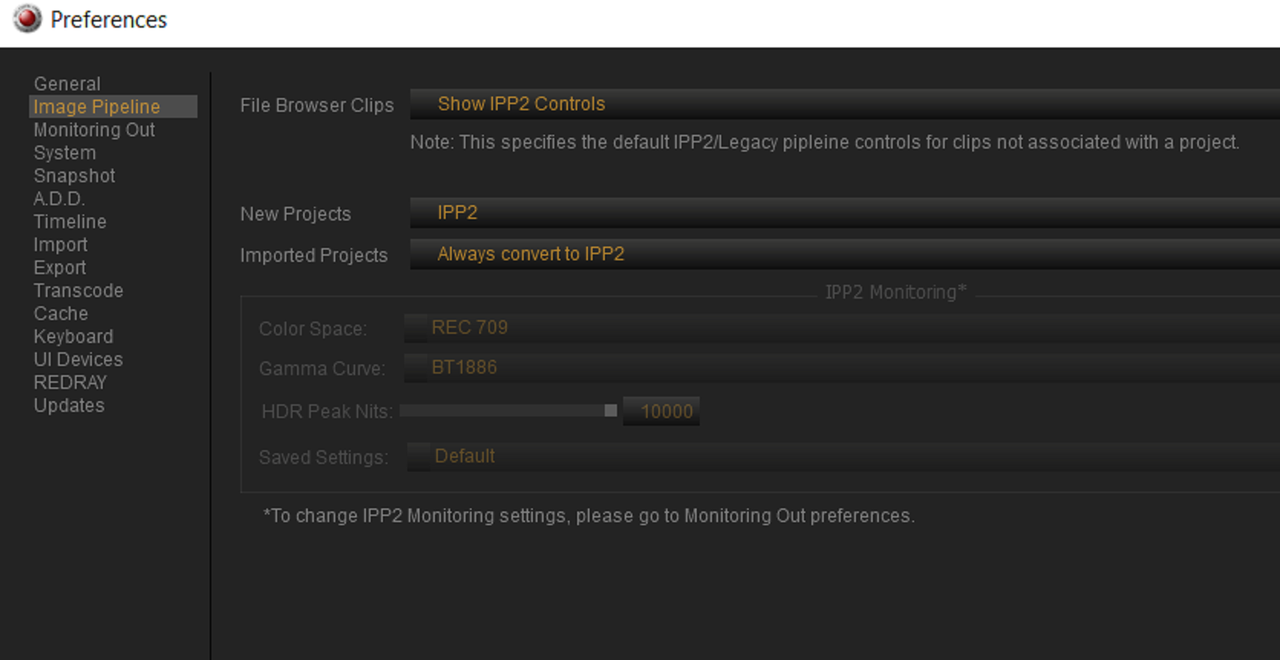

Here you go.
Redcine-X Settings

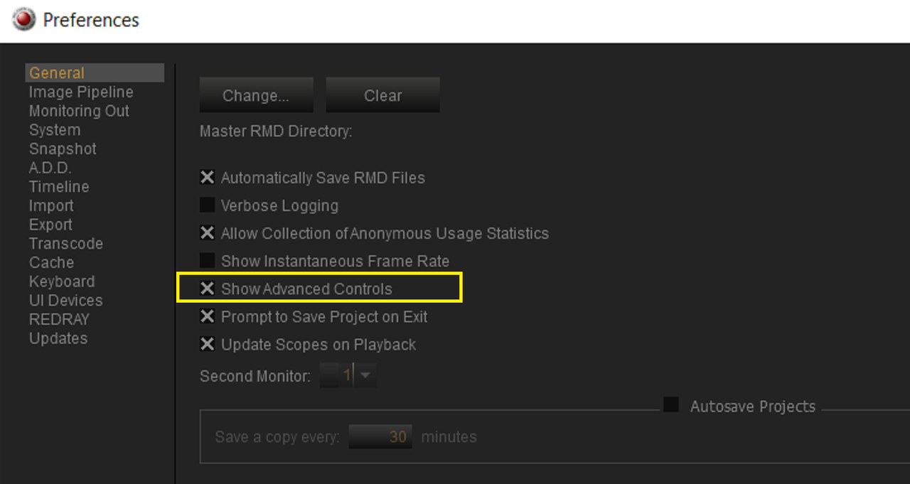

Preferences found under "Edit" at top left-hand corner of Redcine-X
Be sure to Enable "Show Advanced Controls" Under the "General" under "Preferences" So that you can use the IPP2 Settings below

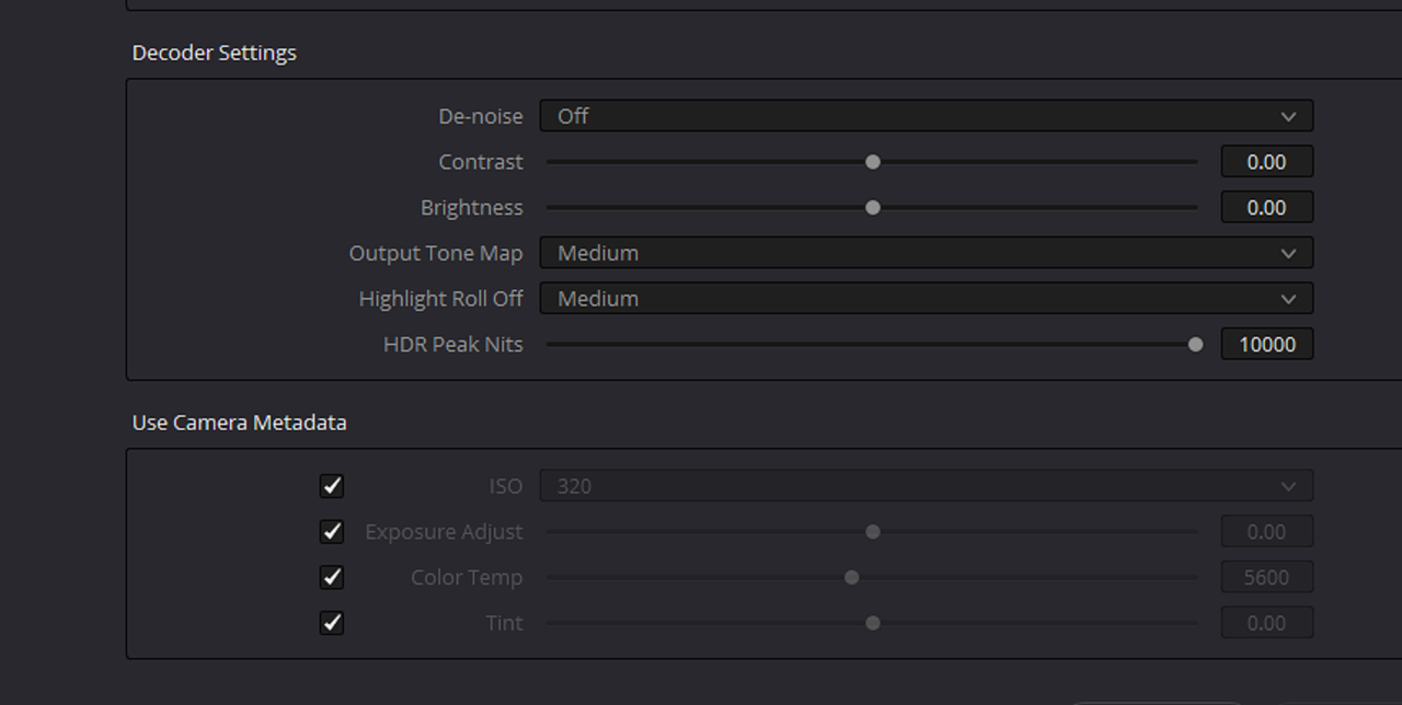

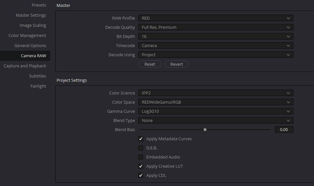

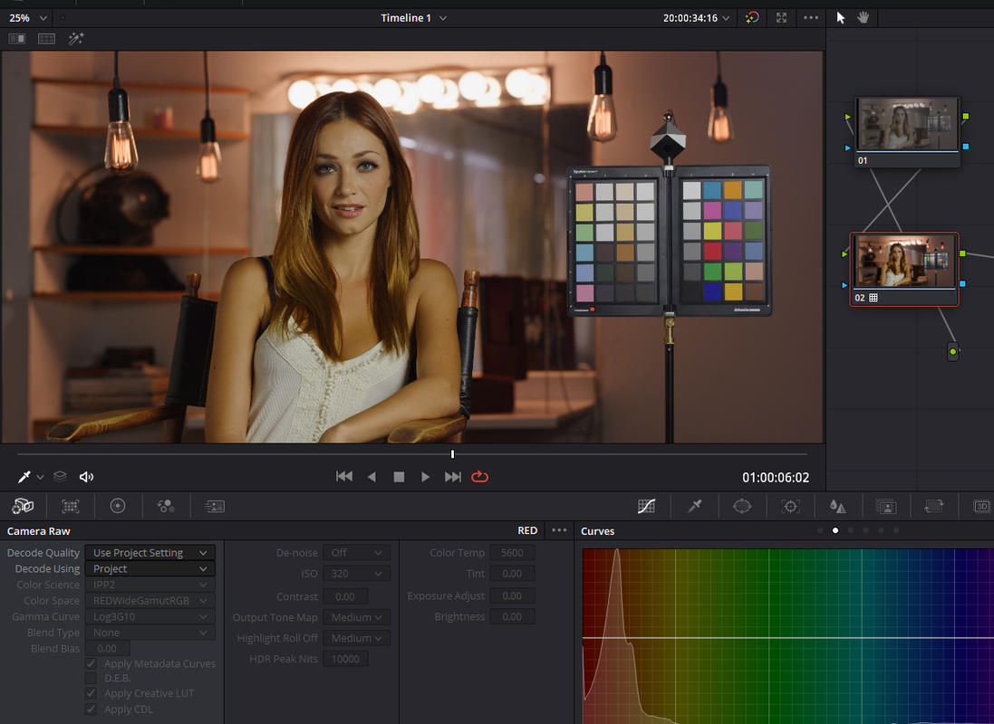

Resolve Project Settings
Ignore the "Decoder Settings" Area, you can leave these settings as they are, They don't really do shit.

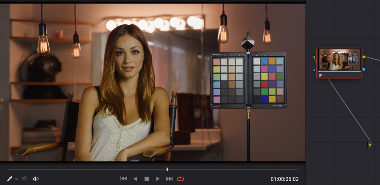

High Con/ Very Soft IPP2 Output Transform Lut Added as in Redcine-X
Redcine-X
Resolve

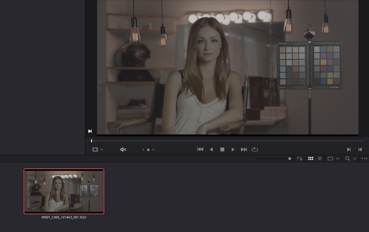

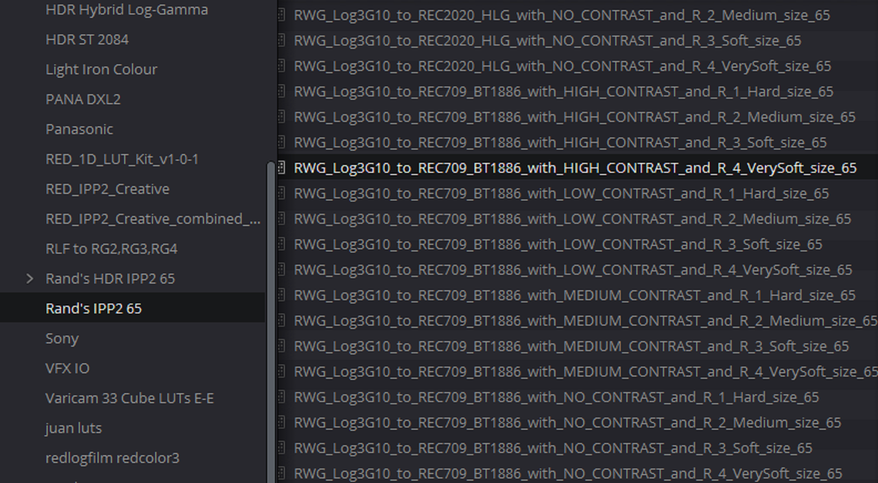

I see you added the LUT as a node but not from the settings menus which only produced your LOG starting point? It seems this should be able to be setup right from the decoder settings, which is what I was trying to do. Thanks!

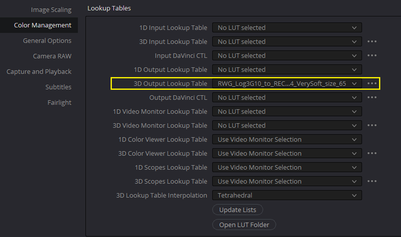

Jon,
You could also pre-select an "Output Transform" Lut in the Project settings to automatically transform the RedwidegamutRGB/ Log3G10 image.
In the " Color Management" Table Under the "Lookup Tables" heading in "3D Output Lookup Table" select the IPP2 Output Transform Lut you want to use. Then you won't have to use nodes to apply the Output transform lut. However, you will be locked to that IPP2 transform for the entirety of your project. The Node based approach allows you to choose the best IPP2 transform to optimize your footage.

Jon,
Thanks for your help Rand, that is exactly what I needed!
