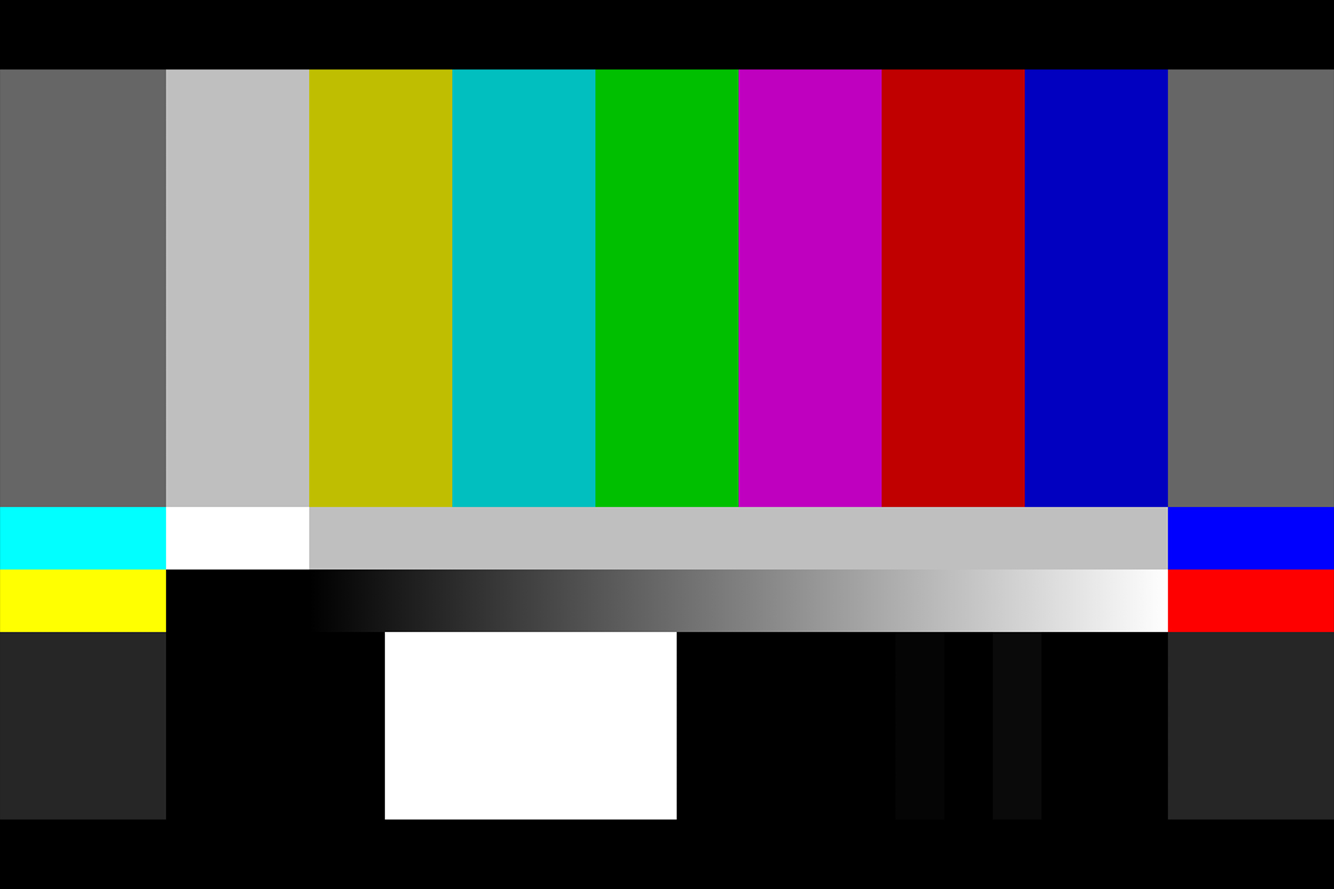

I generally try to export a second or two of SMPTE Bars at the head of the project, and I import the file back into Resolve to check it on scopes to verify all the levels are correct. Using calibrated displays is a must -- without that, you have no idea what you're looking at. We also accept that the basic picture is going to change a little bit on different devices, because that's life.
