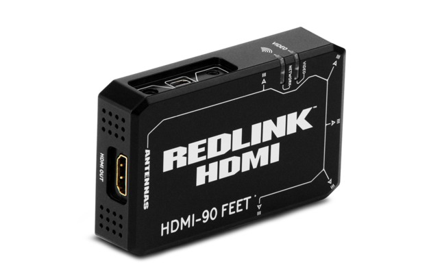

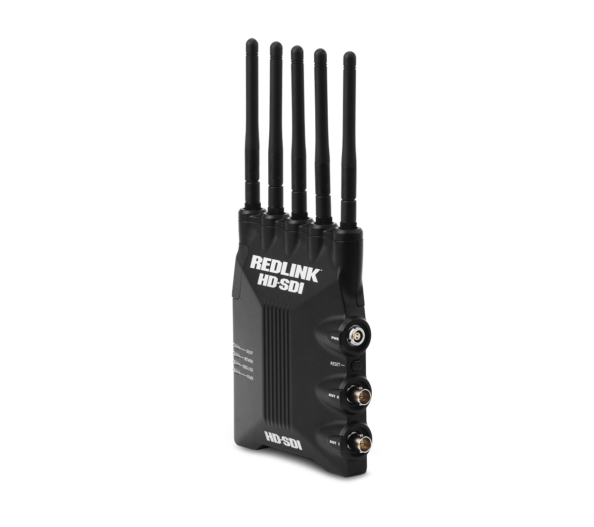

There are currently two types of REDLINK HD video receivers, SDI and HDMI:
However, at this time, they only receive the signal sent from the $13K Meizler module (which has now been completely redesigned).
Needless to say - $14K+ wireless monitoring option is not for everyone. Especially with many amazing solution in the $1~2K range.
It would be amazing to have just a REDLINK TRANSMITTER module - that would be only designed for sending the REDLINK signal and be in the range of $1~2K (which would still bring the solution to $2~3K for the transmitter / receiver combo). There are four possible designs IMHO that would make a sense...:
1. "end-module" - such a module would simply be just "clipped on" onto the end of the brain in a similar fashion as the REDMOTE. The power will be provided by the brain itself (via the rear connectors). The input would be taken from the HD-SDI (on the brain itself, or on another module such as the PROXY MODULE), with a pass-through HD-SDI connector. It could have a compact design similar to the HD-SDI REDLINK VIDEO RECEIVER...
2. "normal module" - would connect as any other DSMC module via a module adaptor, or another module - and will allow other modules to be mounted on its back (so passing the rear pins through, unlike the "end-module" proposed above). This will also be powered by the brain itself (via the rear connectors). The input would be taken from the HD-SDI (on the brain itself, or on another module such as the PROXY MODULE), with a pass-through HD-SDI connector. Design similar in shape and size to the REAR SSD MODULE...
3. "module adaptor" - basically a replacement for the normal or the +1 module adaptors. Ideally it would be amazing to have a +1 adaptor combined with REDLINK transmitter. This could take the signal from the HDMI and pass it through as the RED LCD/EVF connector (+1). This will leave the HD-SDI open for any other uses. Again powered by the brain itself via the rear pins. Design similar to the +1 MODULE ADAPTOR...
4. "backpack module" - a part of the back-pack system for accessories. However there are two possible downsides with this concept: The backpack is basically designed to hold "just" one accessory which would limit its use - and the backpack version would require to be powered by yet another cable from the 4-pin mini Lemo at the bottom of the brain. Design could again be compact and similar to the HD-SDI REDLINK VIDEO RECEIVER...
Both the HDMI and HD-SDI versions state that 4 receivers can accept signal from one source. This is IMHO more then enough. All we need now is an affordable transmitter...
Please discuss bellow and vote in the poll which of the above versions would best suit you...
