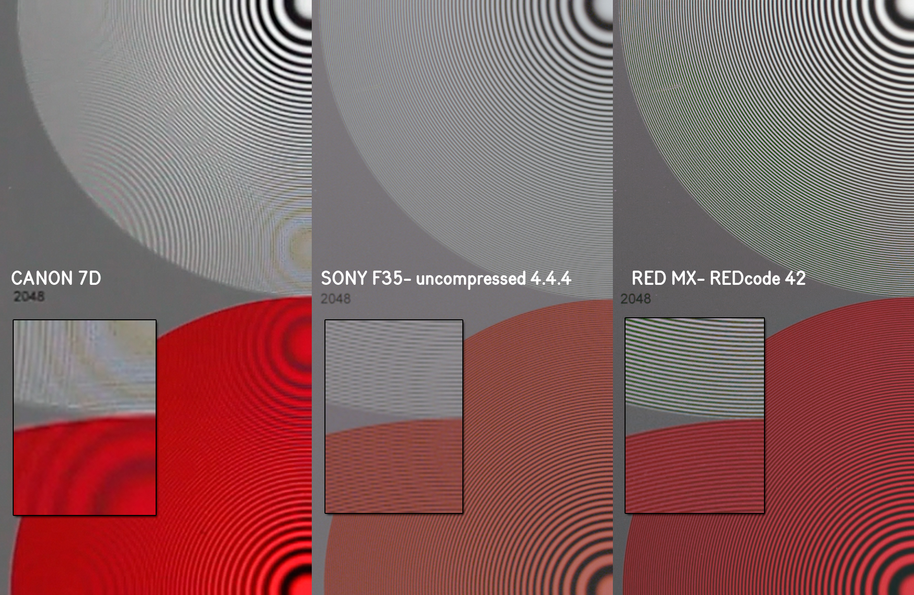

I dug up this old test from years ago with the F35...
