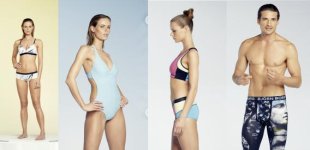

These are MX skintones.... To me those beat the shit out of any german skintones. And they are all shot in completely different colored back lights and all graded with the same setup. It's only HD screendumps but needless to say the resolution and 16 bit colors beats alexa proress any day and personally I think it beats the XT stuff as well. I can not really understand the problems with skintones and MX and especially not dragon. If it's half ass properly lit and the makup is somewhat well done it looks smashing I think.
Edit the attachement got a bit small.. here is a bigger version of the same screendump: https://www.flickr.com/photos/107237384@N04/14351789185/
and here is a dragon striaght from camera old olpf no adjustment I think redgama3 red color 3 iso 800:
https://www.flickr.com/photos/107237384@N04/12863353275/in/photostream/
it got a bit of green in it from not perfectly balanced light or if it's the sumricons that added that cast but nothing that can not be sorted with a very small adjustment in grading.
And yes both of those are "full body" so makup, is basically the sprayon kind of makup and about 50 clothes changes in a shooting day... so no the makup is not perfect but to me the MX and dragon shines more than most when it comes to skin tones.
I got the above in motion as well but can not show it in public so you would have to PM to see it.

Björn cant see same RED colors on your examples. waayyyy different than my examples
Maybe my eyes are wrong with RED color :) look at her sweatshirt and face.i know MX skintones.im checking my library and Dragon skintones that we shot ,exactly like yours.Not even come close to Alexa's RED.
Red skintones looks to me like human beings without blood there is no red in it.

I like Björn's examples too and the original video, but these are all quite different skin tones/overall grades, and rightly so, given the different purposes for the work...
