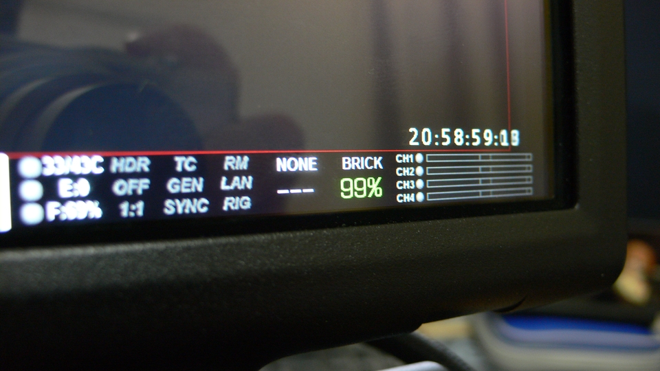

Updated to firmware 1.7.9a and lo and behold! Brick percentage shows up on the display! Looks like the problem's fixed, at least on this camera.
Thanks for all the hard work Red Team!

Not even just voltage, an actual % comes up! Have you tried non-red batteries to see if they show voltage?
I used a IDX battery plate when we flew EPIC on a Steadicam and we could read the DC volts from the IDX battery plate, but not the RED battery plate. I'm updating the camera today and will see if it reads Volts or %

I upgraded to the beta firmware and suddenly the camera would not start up with either a RED Brick or a third party battery-but AC power was okay. I went to the release firmware (.44) and it worked just fine. Using an ET/IDX battery plate with an IDX power cable.

Updated to firmware 1.7.9a, now I am also reading % on RED Bricks;-D
Tested EPIC Build 1 v1.6.44, not reading % on RED Bricks.
Will run with 1.7.9a for more testing.
