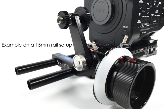

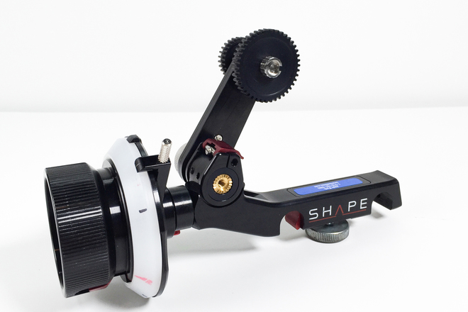

For the budget-conscious, the Shape FF Pro might be an option, going by the product photos. The gear-arm appears to be quite long and it is reversible. It looks as if it would work well for short lenses of small diameter such as the Leica R's and Contax(es?).
You said you needed something soon and on the cheap. The Shape might fit the bill at only $995.
