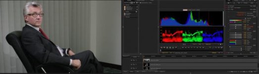

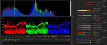

What is going on with my little lady, I am bit stumped. I used the cam for a wide shot in a simple interview I did yesterday. I thought because I was mixing the footage with s sony 500s that 14:1 compression would do fine. 5k hd, iso 800, canon 24-70 @ 2.8, was pretty well exposed. I find the pic pretty soft which we could put down to the lens but with my pl glass does not make a big difference. When I apply the noise reduction it just shows up red. I'm on the beta firmware, and black balanced accordingly. After a fully debayer out put its just uninspiring.
The second zoom pic is with the noise reduction set to 6, its difficult to see from these but red pixels pop up and the noise does not really decrease.

I still don't really understand the complaint. The window sill is white and exposed at 40% IRE. Thats underexposed by at least 4 stops and the noise in the still is really not bad. Every example I have seen has been underexposed. What your calling mid tones are underexposed whites. You can't expect a white object exposed as a dark grey object will be completely unaffected. I would say shoot a test with a regular image with each tone exposed in the region it belongs. If your problem, persists maybe you should send it back, but at least right now it doesn't look like a problem to me.
Ryan, it doesn't matter whether you expose white at 90IRE or 40IRE, it should still be noise free because it has enough exposure. Yes, the exposure is low and it will be a darker shade of white, but that doesn't mean it's normal to see noise in the whites in this situation. If it was at 10IRE and pushed then of course there should be noise, but not here. There should not be any noise there because it is getting enough of an exposure for this shot. Not every white needs to be exposed so high up on the index. Anything above 30IRE should be pretty clean to be honest, but what I'm seeing is noise currently begins at 40IRE and at times even higher up in the midtones.
Sorry, I couldn't resist. lol. But try uploading the pics to an image hosting website. Can't exactly see anything from those screencaps.
