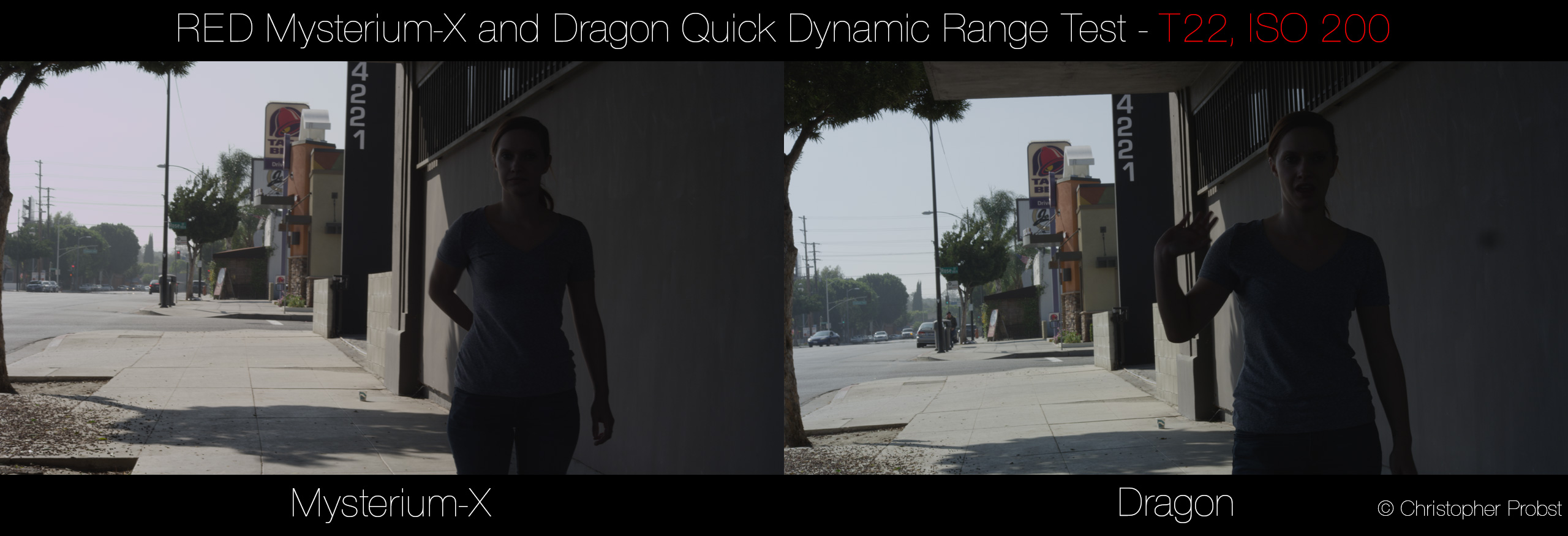

This is what I was most curious about - the claims of a "Penalty Free" ISO adjustment. Seems like there is still a "sweet spot" (read: mandatory) ISO range to constrain yourself to as you start introducing all sorts of weird shifts at the lower end of the ISO spectrum. Looks like I wont be shooting 50 ISO in the daytime.
Thanks for these, Christopher and Phil - very informative!
"Penalty Free" is an interesting term. One I was a bit thrown off by first. However, what Red's stating in the specifications is "cinema ready ISO 200-2000" performance. Obviously within a proper exposure range. The one image that sort of shows exactly what that's all about is the T22 ISO 200 sample where color information is retained in broad daylight without any distortion or clipping. The sky is the easy place to spot how that's working, however, if you look at the sidewalk and pretty much everywhere you can see what that actually means.
To me it means essentially a workable latitude and clean image at ISO 200-2000. That's pretty much what we see here.

Thanks guys. I know that Penalty Free statement was hard to wrap your head around.. it's much more complicated than that, as the pixels respond differently as you can see here... and we still have a bit of work to do tweaking the knobs.
Dragon color is getting closer though.. the combination of the latest sensor calibration along with the new color science. Phil.. you should swing by Friday and do a test of the new calibration on a Dragon vs the calibration you are using here... if you are happy now I think it will be worth the trip.

All this information is awesome! Thanks guys for taking the time to show us all this test. So happy about the magenta shift in the highlights fix with with the dragon. It was always correctable, but super happy to see that i don't have to worry about it anymore.

Another thing I'm observing in some of the clips I've posted and more recently in Chris's shots here is it's clear to see that Dragon's OLPF is seeing more detail as well. That combined with higher pixel density is part of the equation. I think 5K for 5K Dragon's going to be a hair sharper overall straight out of the box compared to Mysterium-X if you take the lens and sensor size out of equation.

are these tests supposed to show how good the Dragon is.. or how bad footage can be produced with an MX Camera?
We all know, Dragon is supposed to be better than MX.. But making tests to let the Dragon shine in parameters outside of anything that makes sense for an MX Sensor??
Showing how bad MX can look is a big service to all us that want or must stay on mx for some time..
I!! know how good my footage looks.. but these tests wil spark the discussions that only Dragon delivers and all our MX are worthless..
So, its not Sony, Canon and Arri against RED.. we are making our own cameras bad..
