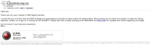

Many many thanks and I will keep this updated as and when I know anything on my order. As it stands at the moment it is as follows,

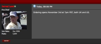

What a week! I decide that EPIC X is the way to go. 'Top of the range and will ship before Scarlet' - future proof job done! Hold on a moment, now Scarlet is announced and that we can order very soon. So will that come before Stage 4 EPIC? Also if it comes with an S35 sensor.......will be cheaper. It all seemed so simple a few days ago..........
