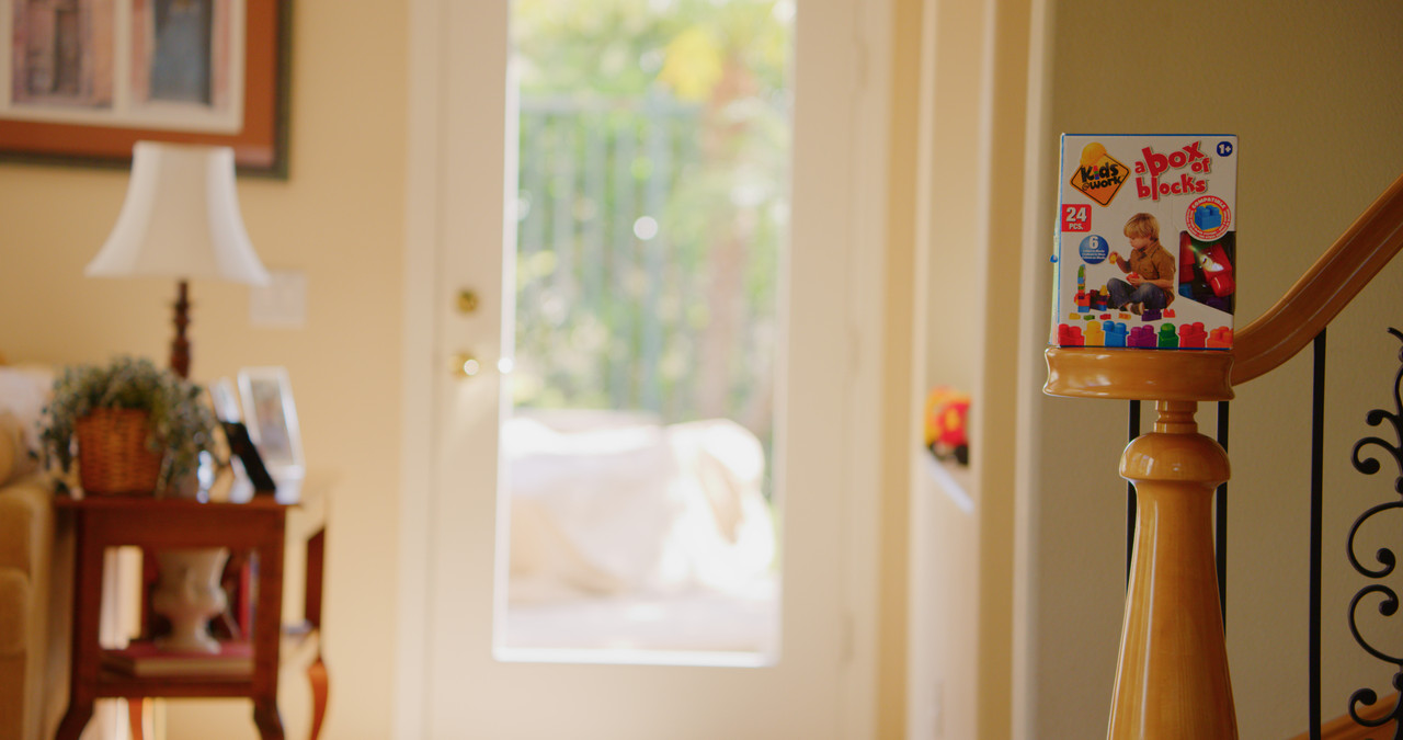

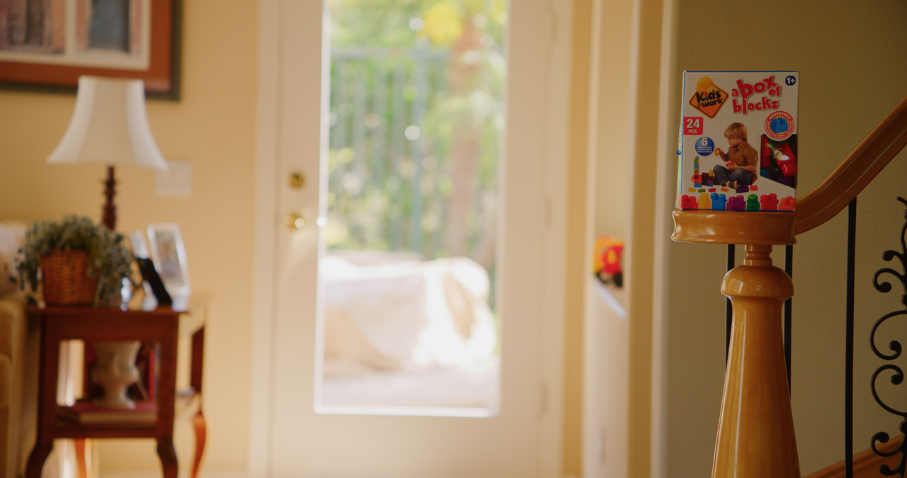

Better late then never......Here's a quick test of the Tokina 1.6 Expander and the 24-290 Optimo. Clip 15 is 8K with the Expander at 105mm. Clip 16 is 5K no Expander at 105mm. From what I see, surprisingly, there's little or no difference. Maybe someone with pixel peeping know how can have a look and weigh in.

Steve,
The 8K with the Expander at 105mm looks a slight bit Darker due to light loss from expander ,everything else being equal, than the 5K no Expander at 105mm. But I don't really see a difference either
Edit:
here are both at ISO 1000 and 5600K and better grade
Thanks, Rand.....Good to know the expander works as it's advertised. It's surprising to me that there's not a big resolution hit when using it. That being said, I think I'll go to it more knowing that aside from the light loss, there's no downside.
