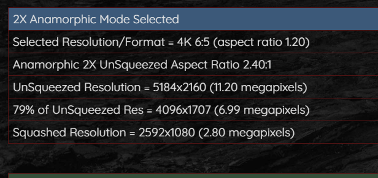

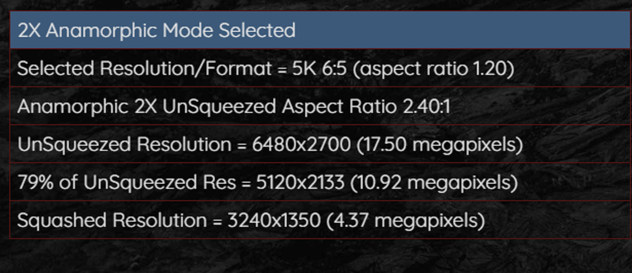

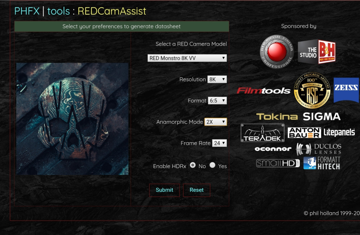

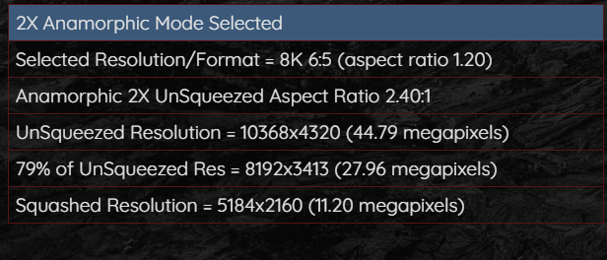

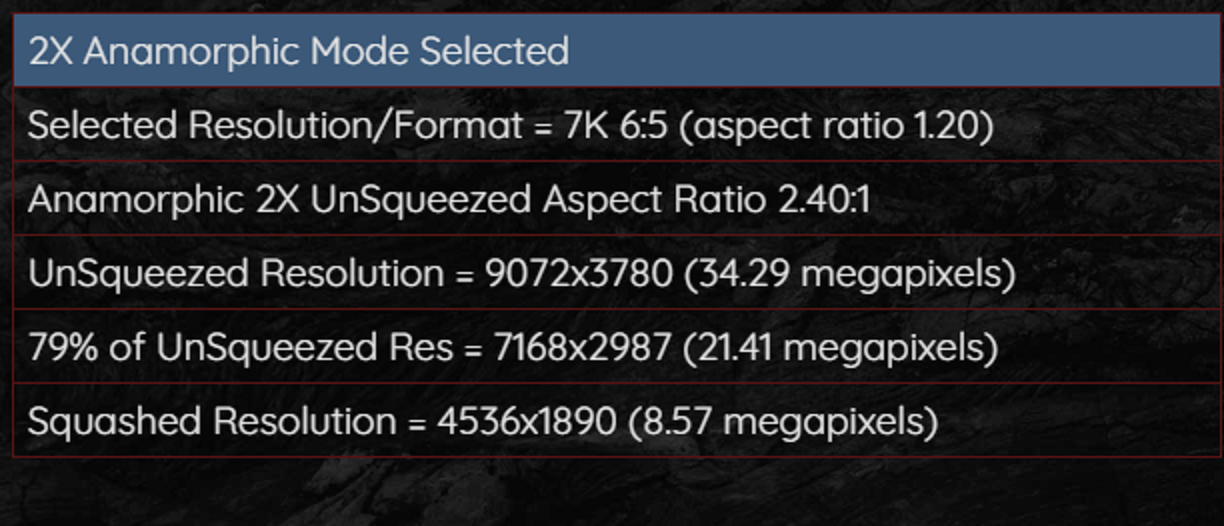

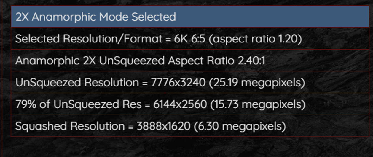

I found these resolutions at PHFX.com from Phil that give you an 2.40:1 aspect with a 2X Anamorphic lens.
But always, try shoot at the highest resolution the camera and lens can give. If shooting anamorphic that is usually 7k ana or 6k ana.
