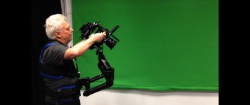

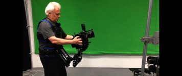

Your vest photo Terry is what sold me on the HELIX :)
So stealth and sleek, great for running around with my Scarlet.
Nice Terry, which vest and arm is that? You can PM me if you don't want to give away the trade secrets ;)
Samir, no trade secrets here. That system (I have the sled, too) is made by Zolinger. I was turned on to it by fellow REDuser Chris McKechnie, and I like it quite a bit. My specific unit is no longer made but it is roughly like this one:
