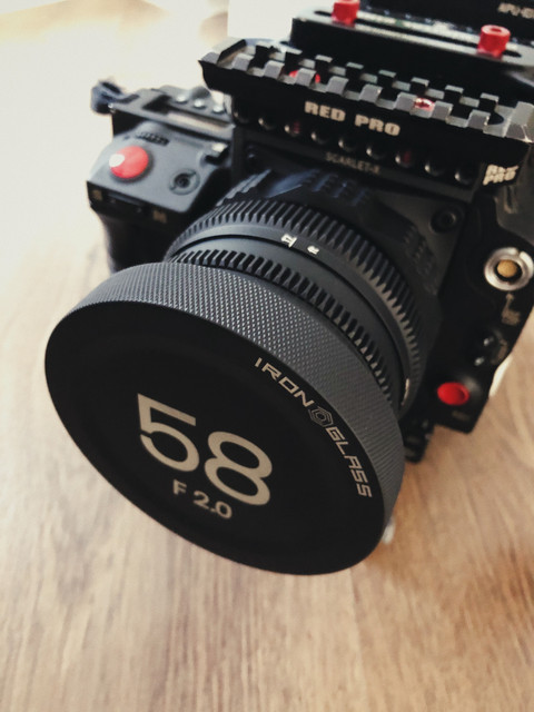

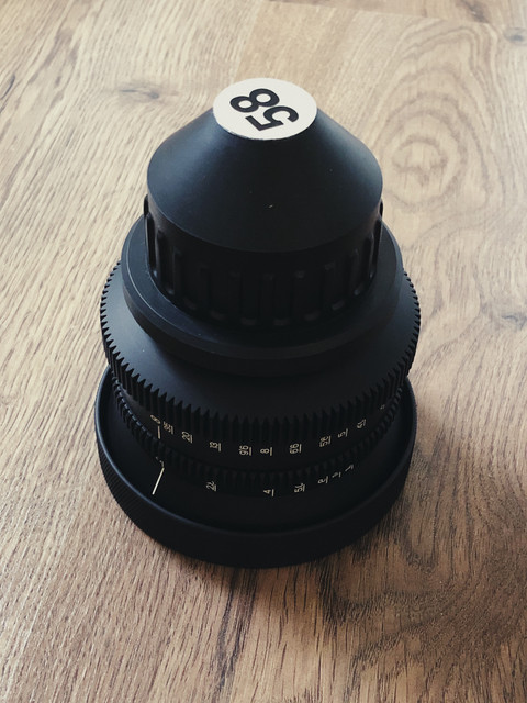

Update - I've decided to pick up a PL-mount for my Scarlet from them, and they were pleasant to give me a 58mm rehoused in PL-mount in Feet scale for a test.

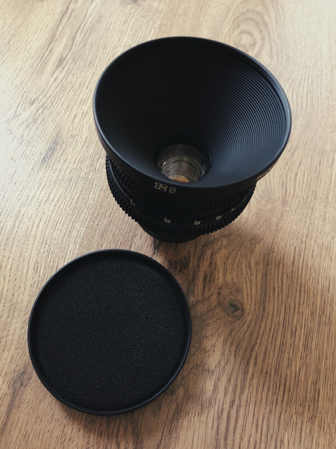

I've just recieved the stuff, so yet no through tests - just unboxed and took a couple shots at home. First off - the quality of the rehouse is stunning. The boxing is pleasant (for those who has seen Cooke, or Arri, or other cinema lens boxes - will understand). The lens did come in a rather small box with padding, as if it was fitted into peli-case. Also it did come with a soft bag. The caps are fitted well, if you've used Sony Cinealta lenses in PL, you know they always come loose and messing with them is just annoying. The front lens cap has a soft cushion built inside, which is what i've always expected for someone to do at one day! There are plenty of focus marks, so it's an easy to use on a daily-basis world. The focus ring and the iris ring do come in an unusual placing - focus is closer to the lens mount, iris is closer to lens front. It's due to the original lens design. The grease is a tad stiffer than I'm used to, compared to other lenses, but overall it's smooth and silent. Dunno, never tried a totally new lens from a pack though, maybe it'll act a tad different after some time of use. The focus ring rotation is a full-cinema grade one, I don't actually know is it the same angle on every lens, or differs from lens to lens - will have to ask tomorrow. The lens does retract it's front element while focusing, but the movement is robust and i've barely managed to see this. Will test with clip-on mattebox and some ND's in a couple days. Thefocus gear of the lens stays on the exact same position all the time, so no need for a thick pitch wheel. The IRIS wheel does move, but I'm guessing you'll almost never need to throw a motor on that. The focus wheel is located really close to the camera body, so it's better to check your rig before going on set. Some studio FF systems will be tough to put-on (guess).
Okay, now about the image. The bokeh and the "3D" characteristics of this lens are well-known in photography, but I have to say - it's nothing but stunning! It's a FF lens, and it really shines on VV or LF sensors, while 4K on my Scarlet MX gets right to the edge of it's legendary "swirly" bokeh. On Gemini, Alexa mini OG it'll take much more of the fun aspects pf this lens. Otherwise it's sharp wide-open, and at T/8 it seems clinical.
Post what you'd like to test in this lens, and I'll try to make it!

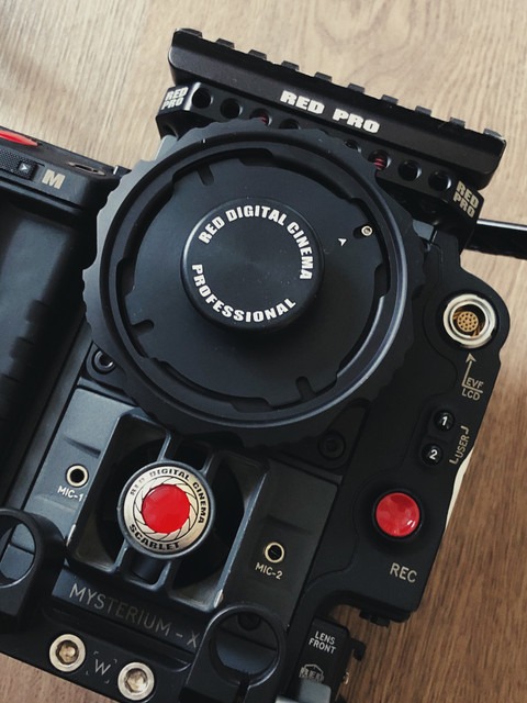

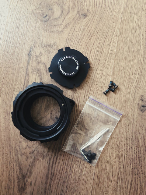

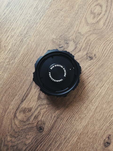

Now separately on PL-Mount. During last decade I've used a lot of various PL-Mounts from different manufacturers. Was it RED TI PL, MG PL, DSMC 2 PL, Wooden Camera PL, noname PL - I've always preferred the original MG PL due to its simplicity and robustness, then the DSMC 2 Pl came out and has become my fav. one, while Wooden Camera one was my most-hated. It's just too soft, I've bended them twice on sets, one was using Arri UP 40mm !!!
I never needed to buy one though, throwing in one with the rented lenses on a gig. I've bought an old 18-85 RPZ for car-chase stuff recently, so decided to buy one. My choise was between Tilta (never seen one) and the Iron Glass. I've liked the Iron Glass a tad more due to its matte black finish. Was worried for the ring size though, but it did come just right.
The mount itself is dumb (no pins), with a pin-safety bar inside to prevent short-circuit. Does come with a lens cap, and is a tad front-heavy. Made from anodized aluminium, it's pretty thick in base, and quet large. Those with big hands will feel comfortable with the fixing ring. In terms shims - it does not come with ones, will check the flange distance later this week or in the beginning of the next one.

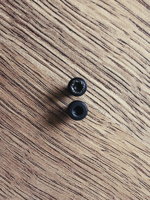

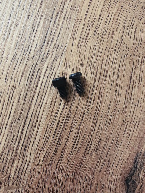

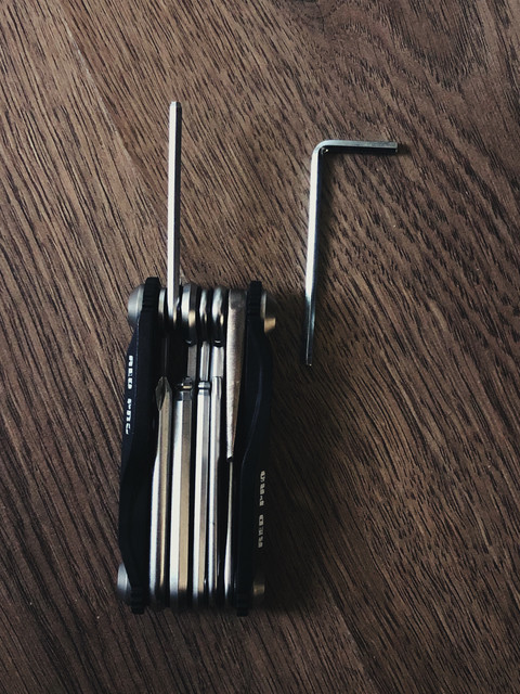

It has different screws than the original RED mount. They are different in length and type, but the tool to unscrew them is right on your Red Sidewinder. Just have to keep in mind that the screws are not interchangable in between mounts.
Also, by far this one is the cheapest one on the market right now - only 220$

The one I've tested is a natively-coated, 8-blade iris lens in full cine housing. The front ring diameter on each of their cine-rehoused lenses is 95mm, which is handy. You're going to love the lens cap. Size-wise all lenses match in their set. The focus gear is located closer to the mount, while the Iris is at the front. The housing is a retrackting one (does not rotate while moving), so while you're pulling focus the lens front is going to move back and forward (not much compared to a lens size, also depends on how deep the refocus is). While the focus gear itself will stay at same place, the aperture ring is going to move with the lens. Also, aperture ring adjustment is non-linear, which means the throw from 2 to 2,8 is the same, as from 5,6 to 16. The focusing itself is made a tad stiffer, than you used to. I've tried throwing an LMB-15 with a couple thick clear filters - and it feels just fine. But it could be a possible problem if you're going to use it on a gimbal with clip-on and a bunch of filters.
While pointing on every single aspect, I have to say that the build quality is good. Don't know how to expect the lens to survive a rental life, but for the owner it'll work a ton.
