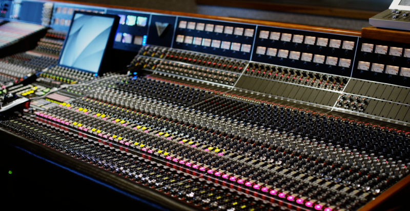

Matt, your mention of linear gamma gave me a thought, which is to start with REDlog and then create a double S-curve, one for the console the first inflection) then another for the buttons. There's slightly more gray than I'd like to see in the result, but this might be a start (1/4 res link URL, attachment is even smaller):
https://www.dropbox.com/s/ltw262ub9hx9k4u/APIv2.0000000.jpg
The button colors are still way on the magenta side (they should be red). But I think I'm getting it.

As you can see, the MUTE buttons (RED) have blown to nearly white closer to the camera, but as they fade into the distance, they fade from magenta-ish to red-ish. Which makes sense: the farther away the button gets, 1/r^2 has its effect, and that effect is amplified when the bokeh smears that smaller amount of light over a larger portion of the image.
What I'm hoping to do with DRAGON is to avoid that false color shift completely.
I just played around a bit in Resolve. Looks like those red buttons closer to camera and are gone regardless of what you do, so I tried to bring back the numbers on the ones that were recoverable and bring up the level meters. Not sure if this is what you are looking for.
The way I deal with stuff like that in Resolve is: 1) bring up the entire scene normally, 2) do a power window isolating the area with the buttons, 3) create another node isolating the Red of the buttons only, and 4) drop the Red Luminance. Do that, and I'd guarantee you'll pick up another 10-15% of detail that's buried in there. The alternative would be to use a Parallel node that would retain all the detail of the original shot and drop that into just the buttons. This is a fairly common situation, fairly trivial to fix or at least improve in about 10 seconds.

Matt, your mention of linear gamma gave me a thought, which is to start with REDlog and then create a double S-curve, one for the console the first inflection) then another for the buttons. [...]
I can send you this .RMD if you like, almost matches what you got on your 5D...straight from RedCine :)
When reds blow out, try using RedColor2 instead of 3.
The curve you came up with is almost exactly the same shape that I did, based on Matt's comments. Thanks for the tip on RedColor2. And thanks to all who jumped in with their help.

You are looking for that shot to look more like this? Right out of RCX?
Battistella
Nice! A little less green in the yellow SOLO buttons and a little less blue in the red MUTE buttons. But YEAH! Very nice.
That was just out of RCX.
Here is a little Resolve action. That yellow will take a little extra work. IS this new OLPF?

I am happy to report that DC/RG4 does what I want it to do. It tames the excessively red switches and makes everything else look right.
Post a link to a file with a few frames of the R3D again. I'd like to check out a couple of things.
Ugh. Looks like my fault for moving/deleting the DropBox files. Here's something very much like what I posted before, but as a collection of R3D files. These are shots of the console with some DSC Chroma Du Monde charts. From f1.4 down to f16.
As I look at these images with different color models, I see that RedColor over-saturates the red mute buttons, RedColor2 really desaturates them, then RedColor3 re-saturates them, and DRAGONcolor desaturates them again, albeit not nearly as much as RC2.
