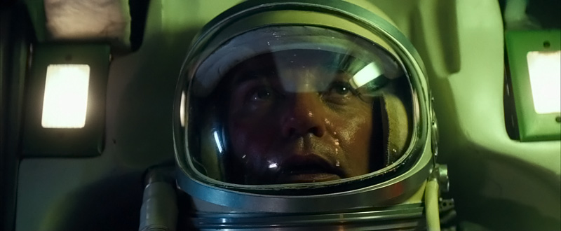

You just have to accept that there will be reflections, so whatever gets reflected in the helmet has to be justified -- hence why either you design the space capsule console to have lights in it that also light the face, or you use a distant hard light that represents the sun. The camera lens hopefully can be surrounded by black or by sections of console with lighted buttons (if you look at "The Right Stuff" you see they did this, panels of instrumentation surrounded the lens and the button lights were bright enough to fill in the face, along with fluorescent work lights in the capsule, more than the actual Mercury capsule used. I went through all of this research when I did "Astronaut Farmer".)
In this shot, the window reflection of the blue sky was done in camera with the actual window (it's a tiny capsule) but in space, we had to add the reflections of the Earth in post -- "The Right Stuff" did it live with rear projection. Today I might have tried an flatscreen monitor out the window with real footage playing to get the reflections.
