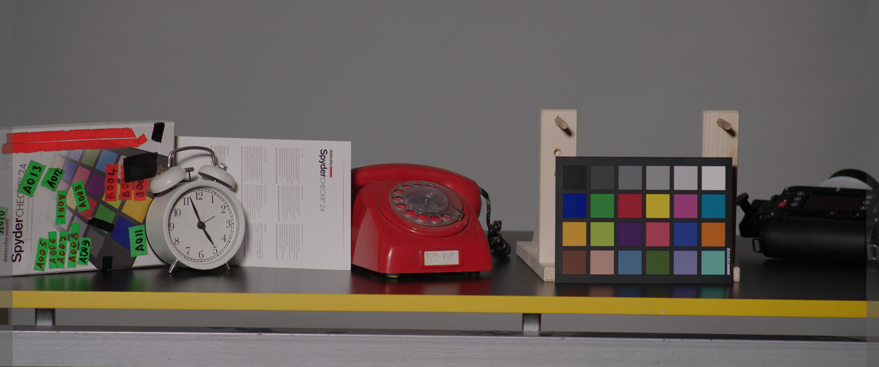

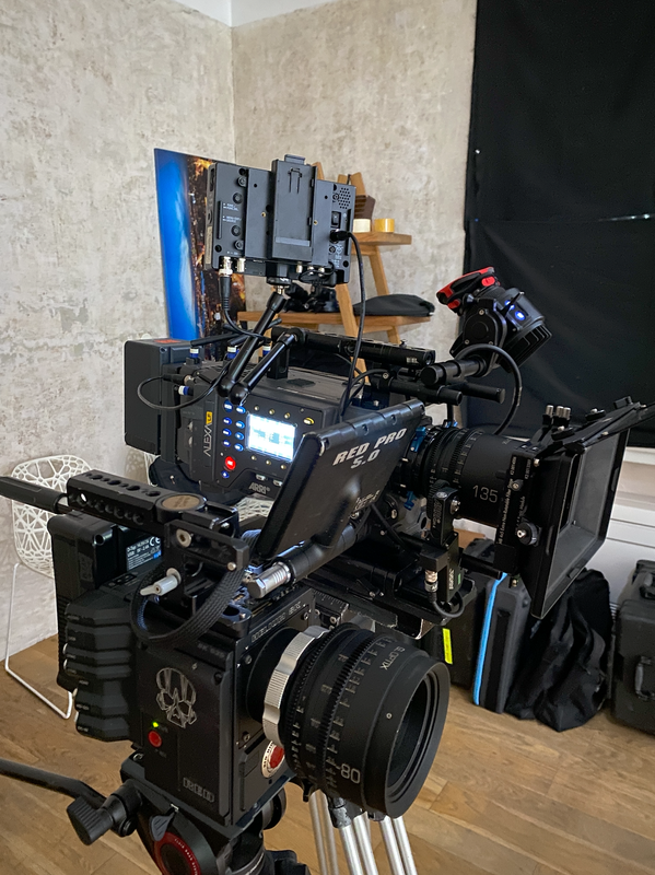

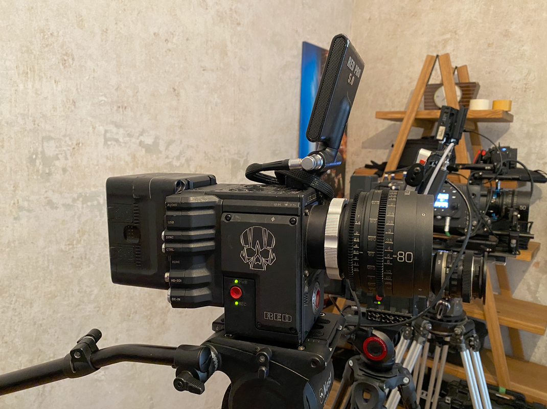

I've been conducting a side-by-side test with my Helium and Alexa LF cameras. I did this test AFTER a shoot I did several weeks ago where I used the two beasts. That project came up all of a sudden, it required 2 cameras, so I didn't have time to make LUTs and I just had to go with it. I'll be posting that project soon, though for now, here are some examples of how the 2 cameras look when under the same shooting conditions:

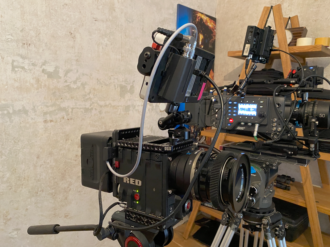

Here's the setup for both cameras:
800 iso
24fps
5600K
180 degree shutter
T4
The Alexa LF was set to 4.5K Open Gate 2.39:1 ARRIRAW
The Helium was set to 8K WS redcode 8:1
The Helium OLPF was Low-light optimised (which I use 99% of the time).
Lenses were Leica-R (135mm on Alexa LF and 80mm on Helium) Naturally the field of view is different between the Full Frame Alexa and Super 35 Helium, so these lens options were somewhat of a match in terms of frame size

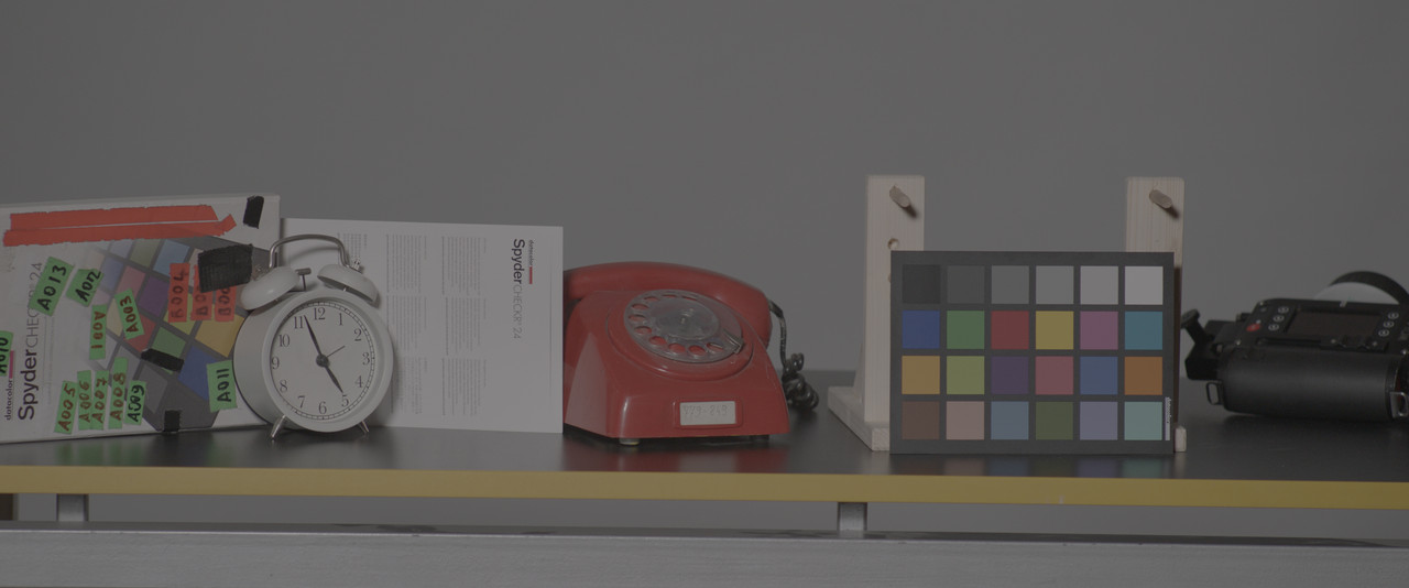

I used my Minolta spot meter to take the light reading at 18% grey on the colour chart, which was exactly T4
Here's what I found:
Using the false colour in the the Alexa LF (with LOG-C), the exposure was perfect at 18% grey. I usually don't use false colour on Reds because I rely on my spot meter, the histogram, goal posts and traffic lights. Everything looked good like I'd expect to see on the Helium's Red Touch. Though I did check false colour (with Log3G10) and the exposure was perfect at 18% grey also.
I also shot the same chart with both cameras set to 4K ProRes 422 HQ as a back up test... but RAW was the prime test
Just a quick note, I scaled down the Helium 8K to fit the frame of the Alexa LF 4.5K in the same timeline. Weirdly, the 2.39:1 Alexa (4448x1856) is a wider aspect ration than 8K WS Helium (8192x3456). 8K WS is 2.37:1
Here's a frame grab from the Alexa LF with ARRIRAW-to-LOG-C applied in Premiere, followed by a frame grab from the Helium with redcode raw to REDwidegamutRGB, Log3G10, output tone map = none, highlight roll-off = very soft
ARRI Alexa LF raw-to-log-c
RED Helium raw-to-log3G10
Straight up you can see the Helium is darker and with more "orange" in the reds. Take a look at the red camera tape on the back of the slate on the left side of frame. Other than this, there's very little differences.
On my 4K monitor and 16'' Macbook Pro, both cameras look beautiful, clean and easy to work with. The 16" Macbook Pro plays back both 8K and 4.5K raw video in the premiere timeline without lag.

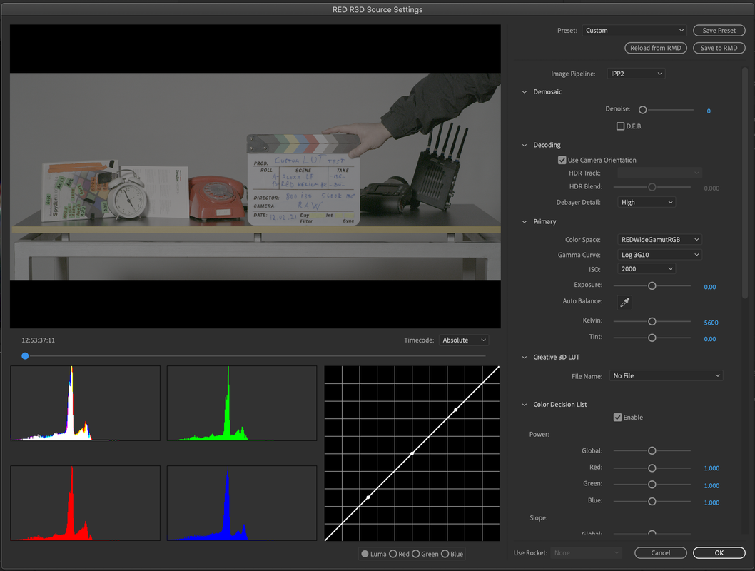

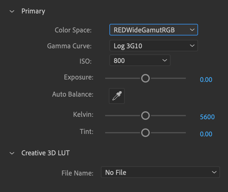

Screenshot of raw settings:
I've been shooting with Reds and Alexas for 10+ years. My gut feeling has always been that Red 800iso is more like 500iso. I've never done a scientific test and never needed too. I've never had an issue with exposure on either camera system. I usually just "over expose" both cameras by 2/3 of a stop (just like I used to do on 35mm film), and get solid results. I rarely correctly expose to 18% grey and avoid white clipping through proper lighting.

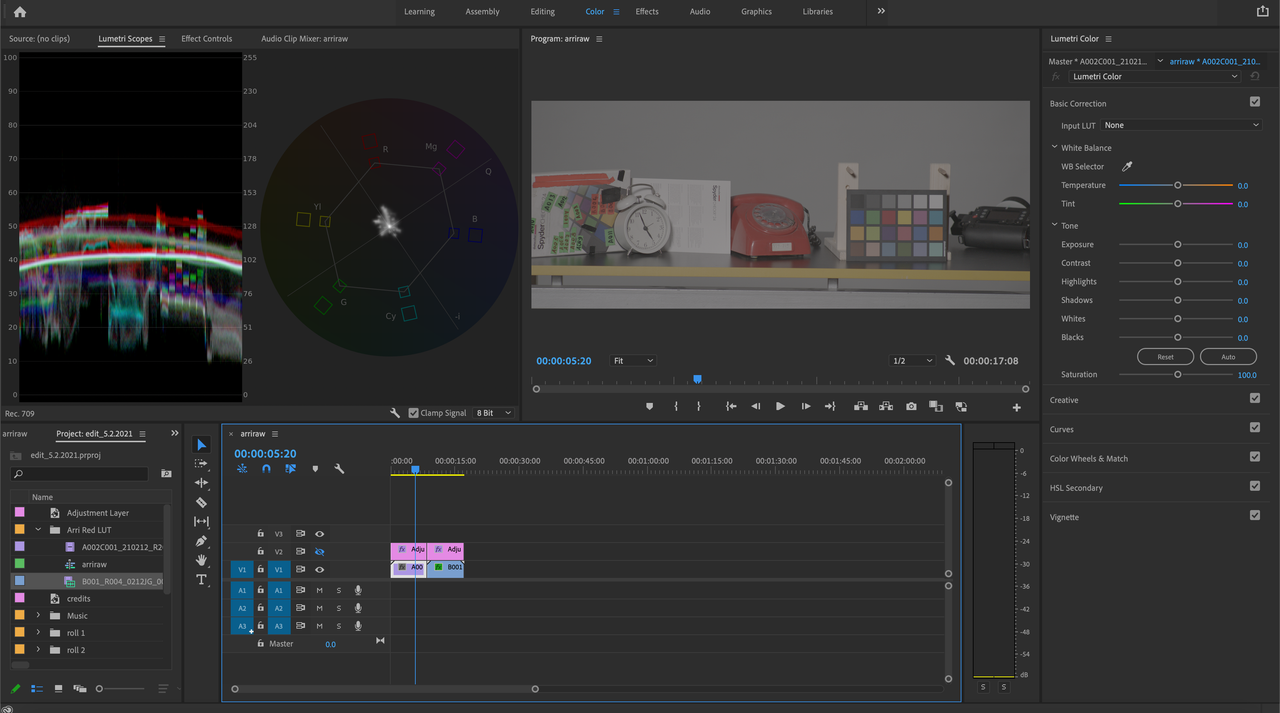

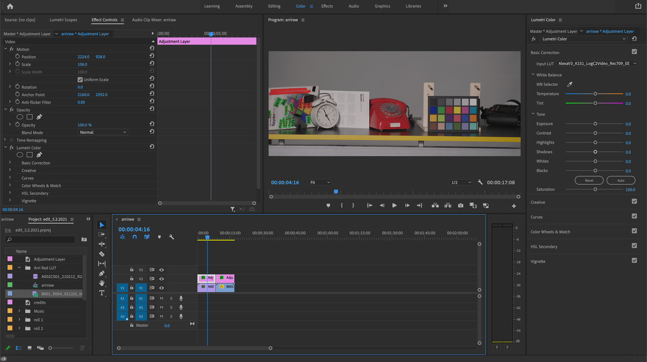

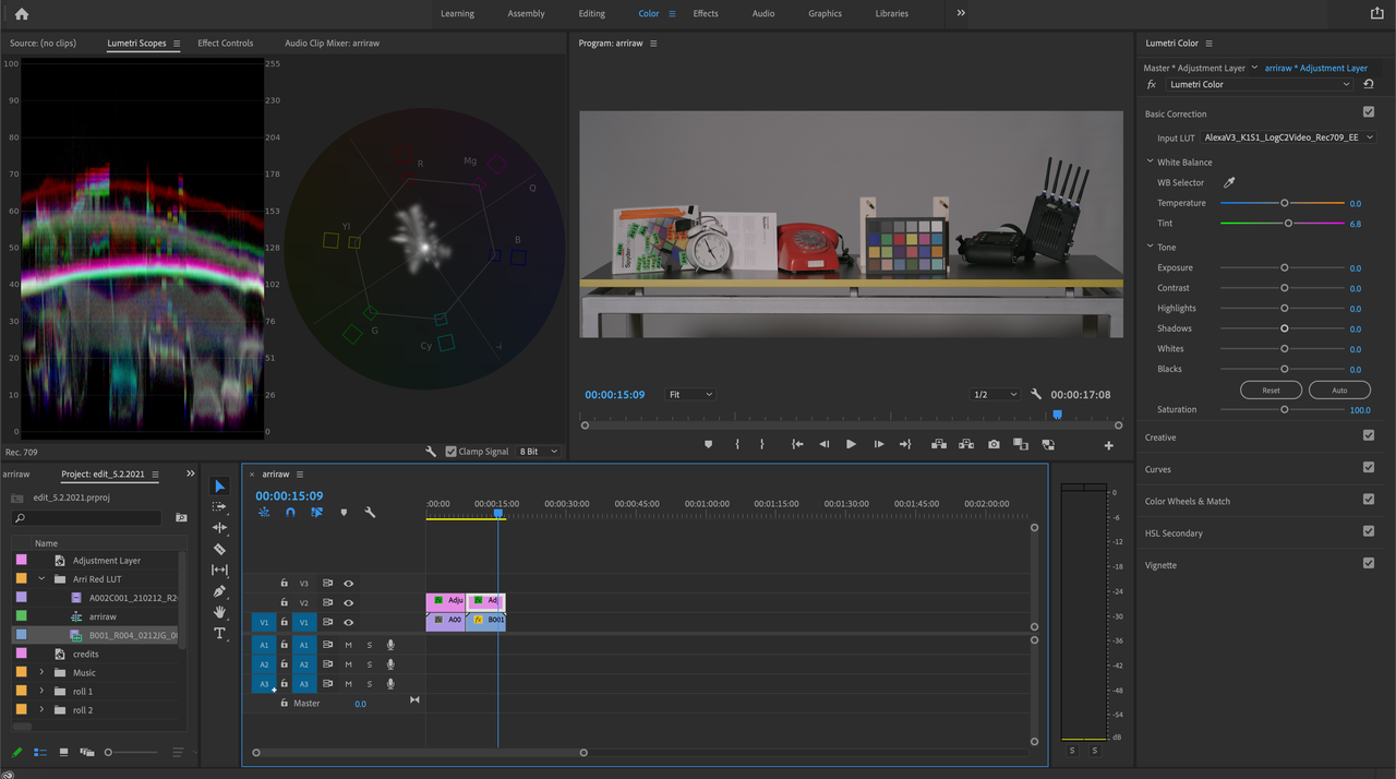

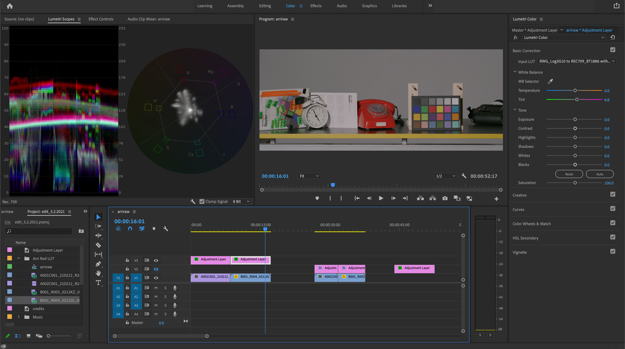

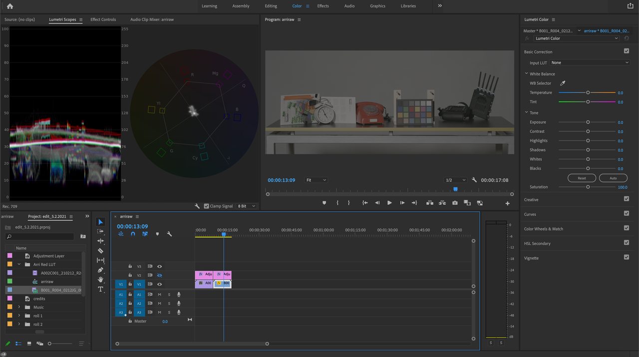

Screenshots of lumetri color with scopes and settings in LOG-C and Log3G10:

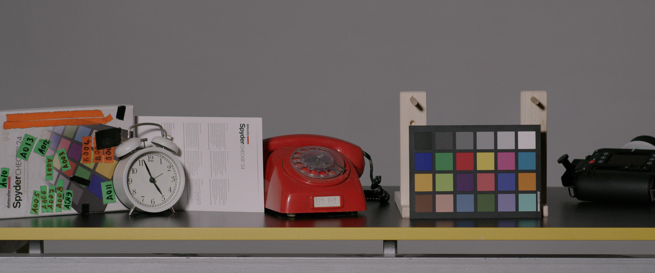

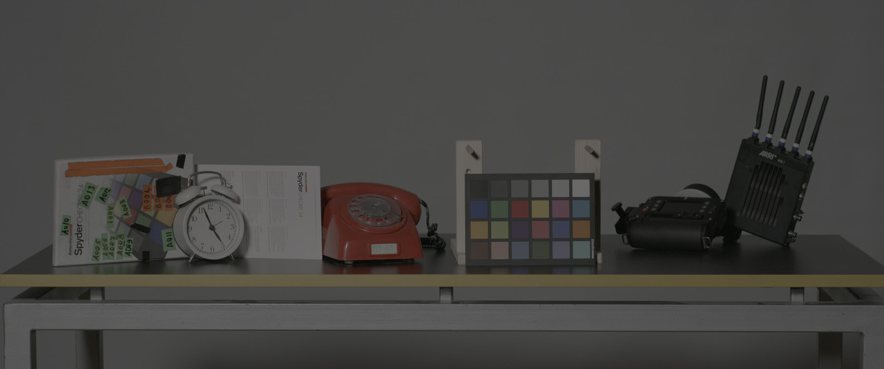

Anyway, to get both the Helium and LF to match exposure, I applied the default Arri Logc2rec709 LUT to both cameras then boosted the iso in the Red source settings to 2000iso and added 6.8 points in the magenta tint (what's odd about this is the false colour tool in the Helium... it displayed green on the 18% grey colour chart, but is underexposed. If I set my spot meter to 500iso and used the iris setting it told me, which would be T2.8 1/3, I'd have a much closer exposure to the Alexa than I currently have). UPDATE: I've retested this theory and corrected my comments down below. 800iso on Helium is 800iso (not 500iso)
Here's the screenshots from lumetri color showing the scopes and settings. The red camera tape is still "orange" on the Helium (and yes, it was red to the eye and rather damn close to what the LF is showing).
Alexa LF with default Arri Logc2rec709 LUT
Red Helium with default Arri Log2rec709 LUT
The scopes show the Helium could still be boosted in exposure a touch more. The noise at 2000iso on the Helium is not noticeable (unless you have extremely poor lighting conditions), so this doesn't bother me. However, for best results, it's good to set the camera at 800iso, then meter at 500iso (or even 400iso) for a super healthy raw image. Here's the frame grabs with the Helium rescaled to 4.5K to match the frame of the LF
LF
Helium
My thoughts on this test:
- both cameras are excellent. In fact, they are my 2 favourite cameras on the market. I love the Monstro and Dragon too, but LF is brilliant for Full Frame because of the tall 1.44:1 sensor and Helium delivers 8K in super 35 (great for the Angenieux 12:1 and Panavision 11:1 zoom lenses, plus Zeiss Master Primes, Ultra Primes, Cooke S4s and Primos etc).
- I feel more than comfortable shooting with both cameras side by side in any lighting condition
- 8K is essential for 4K delivery, high end VFX, reframing and clean low-light performance.
- Red 800iso is closer to 500iso (i've now corrected this after more testing, 800iso is 800iso! See my comments below)
- Alexa LF is true 2.39:1 wide screen where as Helium is 2.37:1
- Alexa LF DOES NOT have a 4.5K 16:9 recording option (this is a frustrating problem in my opinion). The only way to get 4.5K 16:9 is to shoot Open Gate 1.44:1 then crop top and bottom.
- Helium performs well with the Alexa logc2rec709 LUT. If you're a colourist, feel free to grade the frame grabs I've posted and see what results you get. I supposed I could upload the raw video somewhere also.

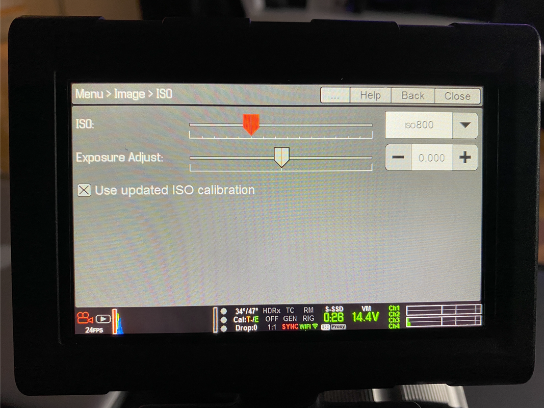

Yes, I used the new ISO calibration:

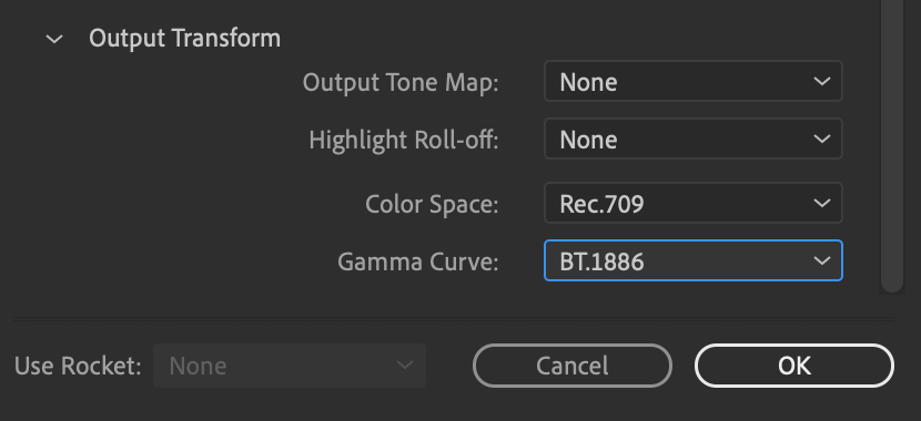

Though, forgive me for being behind the 8-ball on the IPP2 workflow, because I don't usually delve into the details of how a colourist works on my footage, but what is the path for me to get the best results in Premiere? The reason I ask is, in this part of the world, Corona has significantly impacted production and I've been asked to colour my own work on the past few commercials. I'm under the pump with shoots, so don't have the time to learn Resolve. What does "output transform" mean in Premiere? Can it not be bypassed as Mike is suggesting? This is the detail that seems to be altering my exposure and making the image darker than Alexa. ARRI doesn't have this option in their raw settings and it just looks like a normal exposure in the timeline.

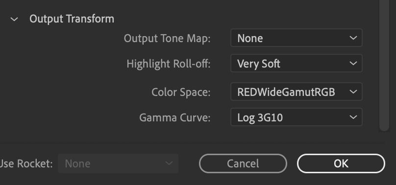

Here's my in camera settings:
Here's 2 options for the "output transform":
Log3G10
BT.1886
My gut is telling me it should be LOG3G10 and then throw a LUT on in Lumetri as an adjustment layer. Right?
If this is the road to get the best result, which LUT from RED do you recommend I use? On youtube I found a dude recommending the following:
RWG_Log3G10 to REC709_BT1886 with HIGH_CONTRAST and R_4_VerySoft size_33 v1.13.cube
Though, this youtuber doesn't state what his "output transform" settings are... so I'm getting confused and lost. Actually, the more I look into this "output tranform" business, there's little to zero information available on the web.
Anyone got answer or recommendation? I'd love to get my Helium (and Dragon) looking shit-hot in the Premiere timeline just like my Alexa. It will help satisfy clients who ask stupid questions :)
Okay this is interesting... I went ahead and used this LUT with my initial settings from the day of testing
RWG_Log3G10 to REC709_BT1886 with LOW_CONTRAST and R_4_VerySoft size_33 v1.13.cube

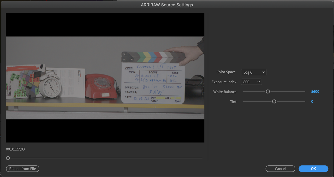

Screenshots of my source settings in Premiere:
With the LUT applied as an adjustment layer in Lumetri, the result looks like this:
VS Alexa LF with the default Alexa logc2rec709 lut
Red Helium
Alexa LF
It's now looking close WITHOUT having to boost ISO at all. Of course with some fine tuning this could be an identical match between the 2 cameras, but as for basic LUTs and offline edits, this is satisfactory in my opinion. Let me know if you don't agree :) Have I done this correctly?

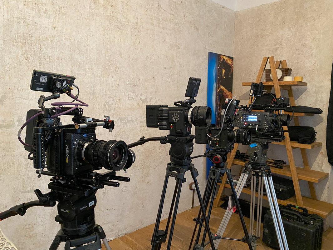

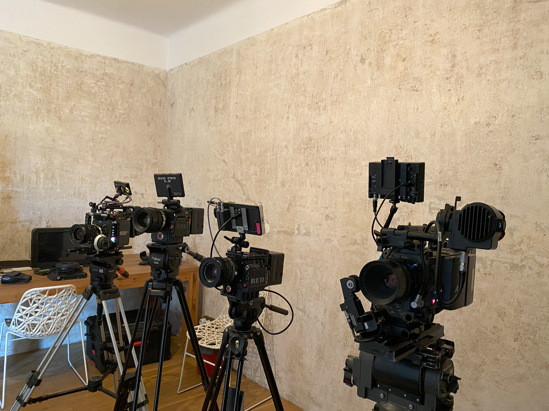

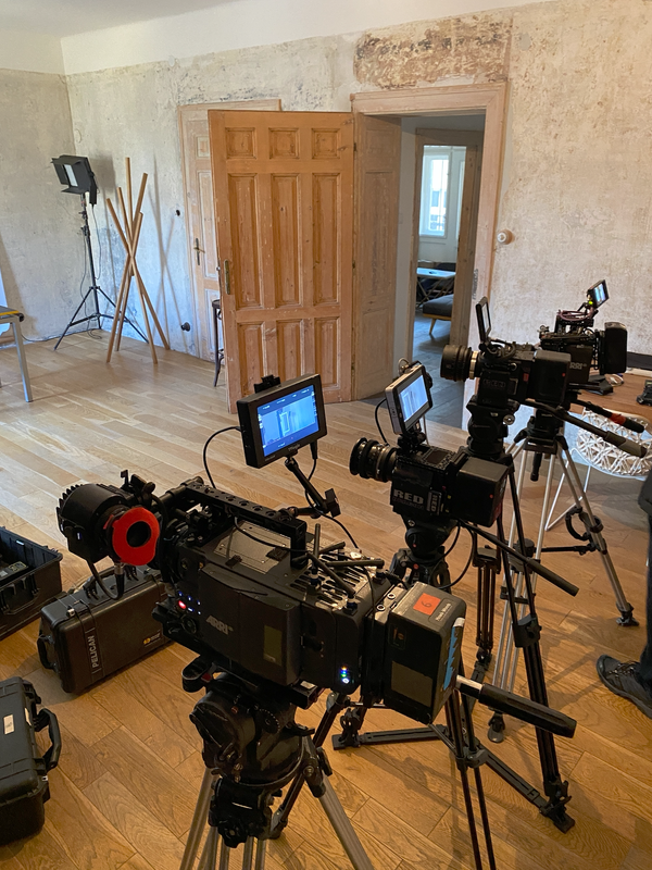

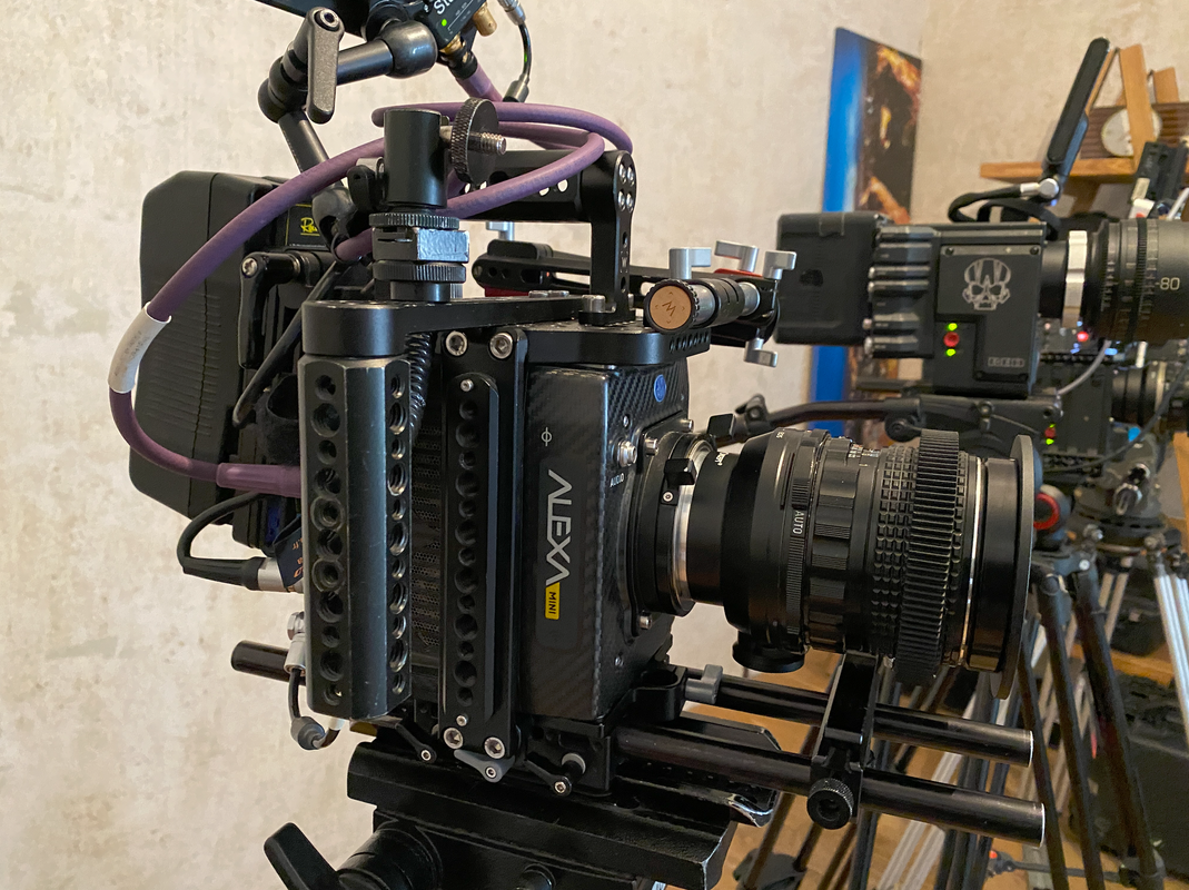

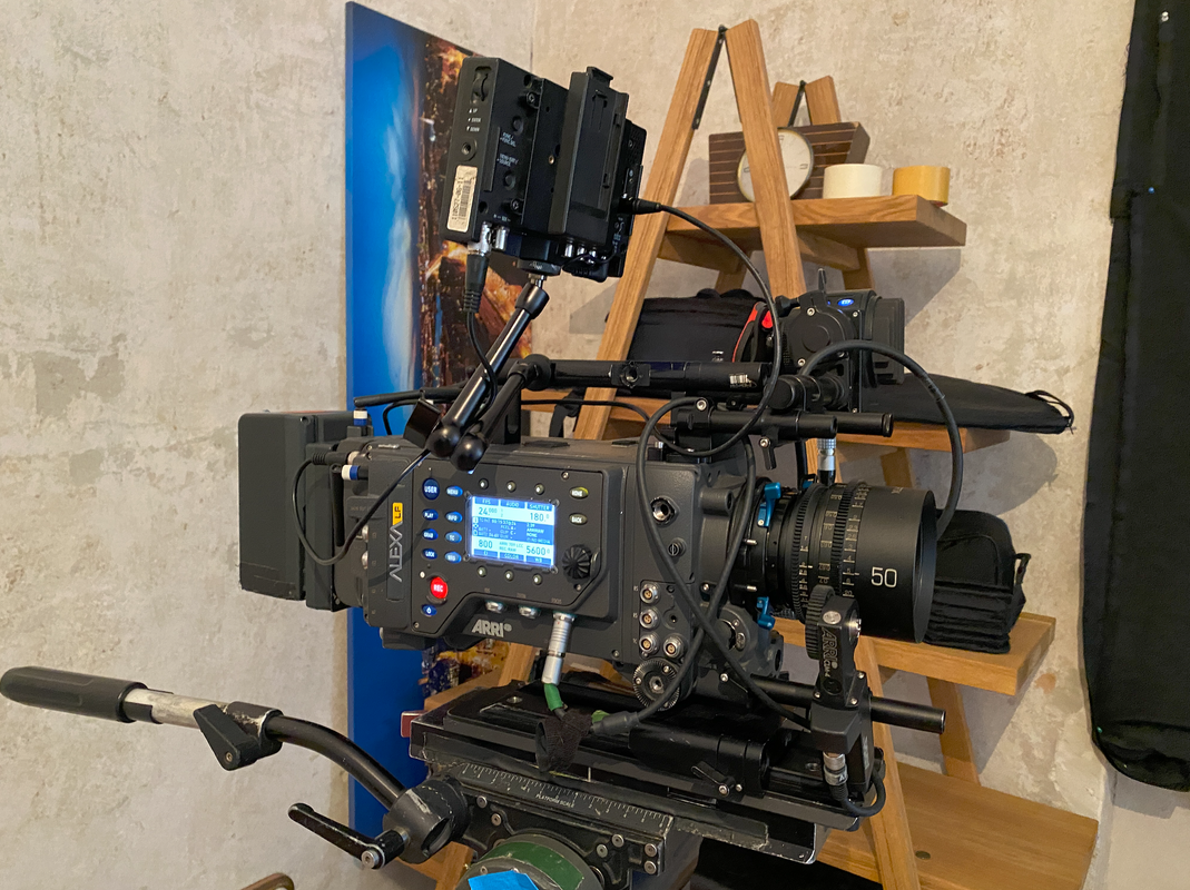

I've done the Helium/Dragon/Alexa LF/Alexa Mini test:
I'll posting the results soon!
That's awesome! Please post a few .r3d/.ari frames (or super short clips).
OH MAN! Is that are those MF Focal Reducers on the Dragon and Alexa Mini? Ha!
Yes, it's the Kipon Baveyes Pentax 67 to Red medium format focal reducer. It reduces the IMAX size Pentax lenses down to the Dragon sensor creating an IMAX-like image. It also increases the exposure by 1-stop. However, the Pentax 67 lens on the Alexa Mini is mounted via an EF adapter without any focal reduction.

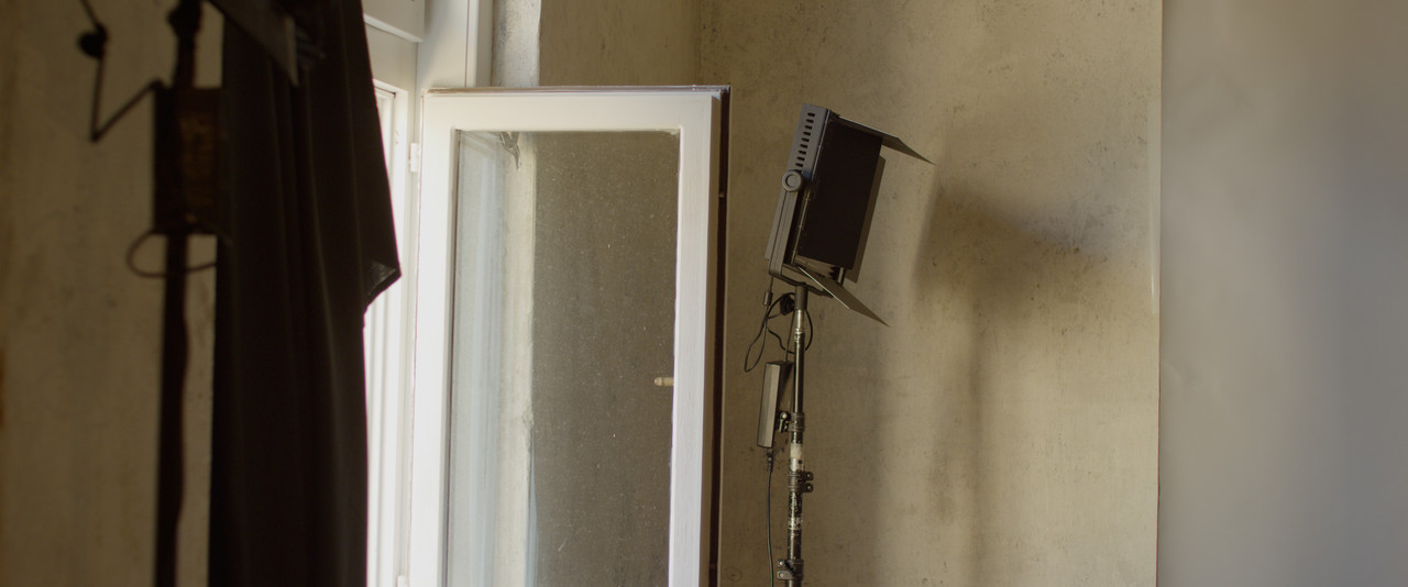

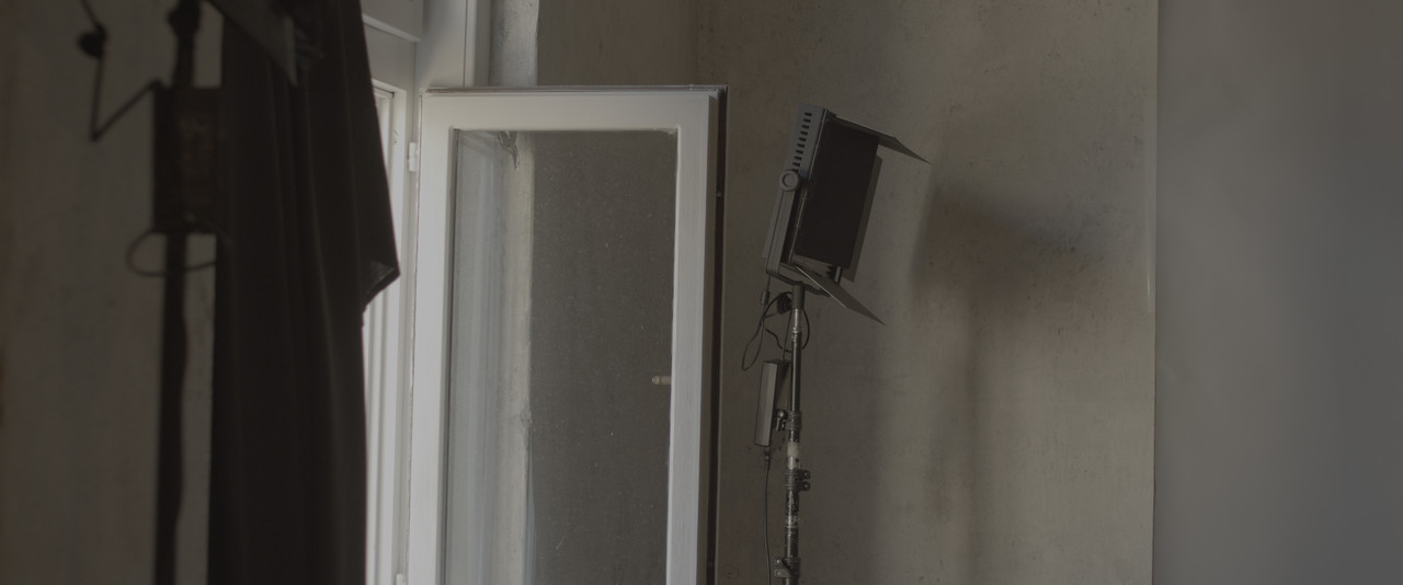

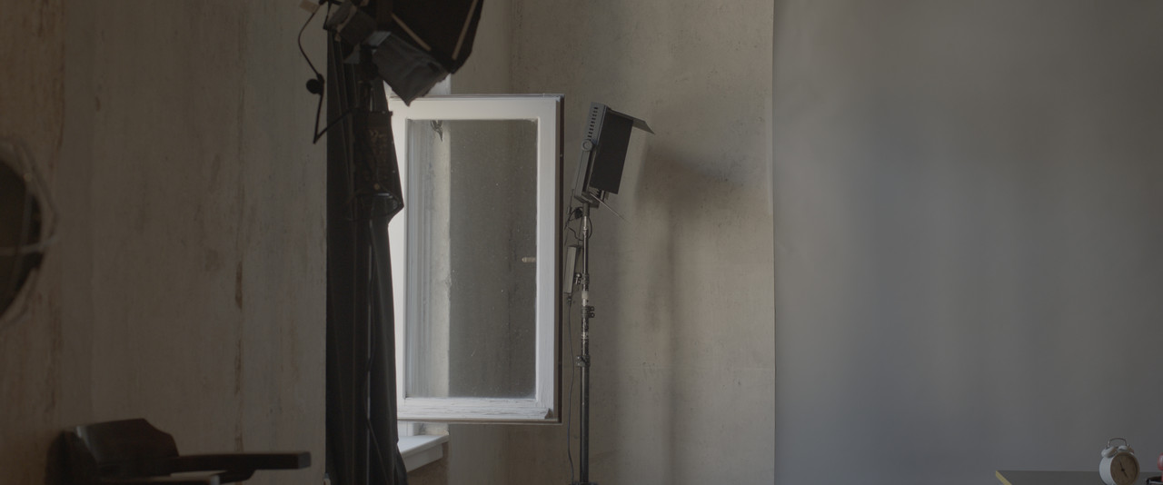

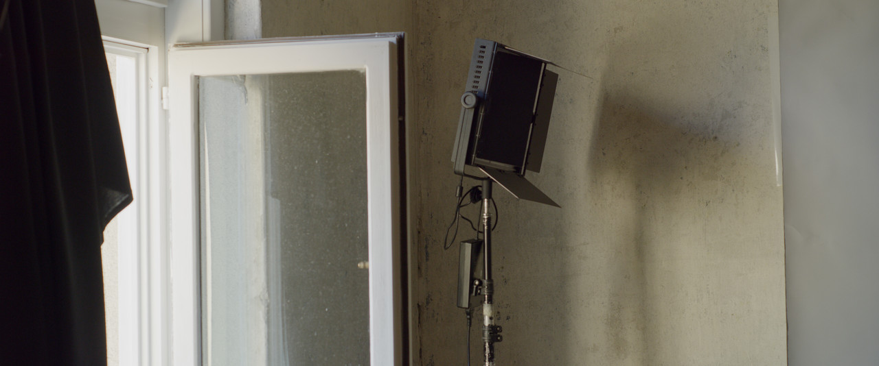

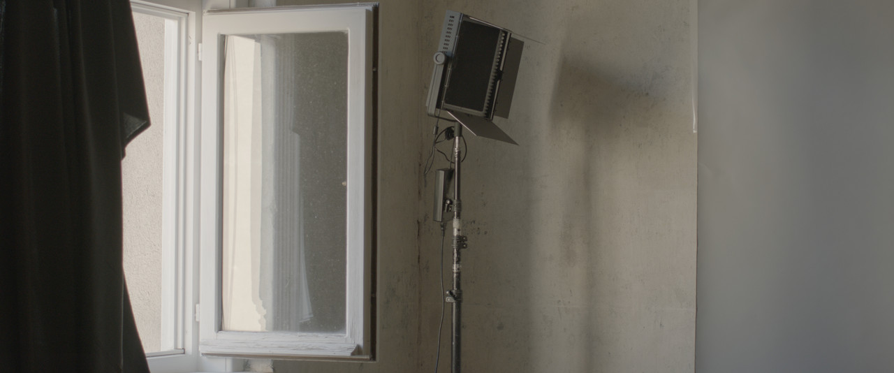

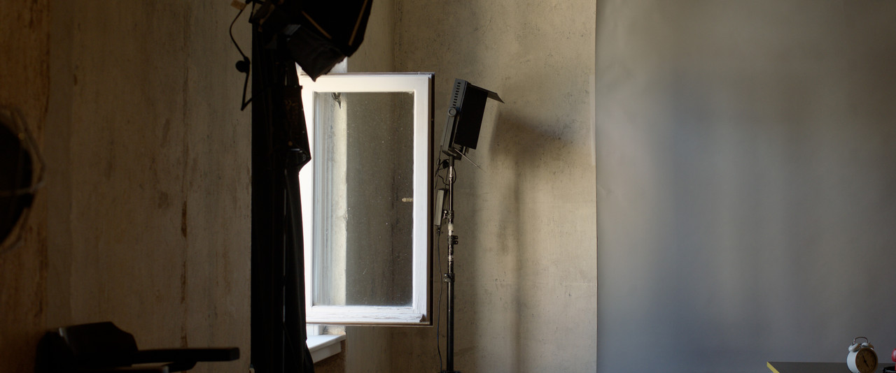

Okay, so here's the results from the test (which I decided to do without colour charts and instead framed all cameras against a window)...
Camera settings were the following:
800iso
24fps
180 degree shutter
5600K
T4
The Helium and Dragon were set to 8K (8:1) and 6K (6:1) respectively. Both cameras used IPP2 and low-light OLPFs
The LF was set to LF 2.39:1 4.5K arriraw
The Mini was set to 4K UHD ProRes 4444 as it did not have the raw license

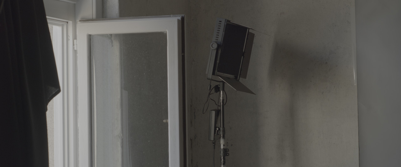

First up, here is a screen grab from each camera in Log (LOG3G10 for RED and LOG-C for ARRI)
Helium Log (with Leica 80mm)
LF Log (with Leica 50mm)
Dragon Log (with Pentax 90mm)
Mini Log (with Pentax 55mm)
Second, we have the same with REC709 luts.
The RED cameras used: RWG_Log3G10 to REC709_BT1886 with LOW_CONTRAST and R_4_VerySoft size_33 v1.13.cube
The ARRI cameras used: AlexaV3_K1S1_LogC2Video_Rec709_EE.cube
Helium Rec709 (with Leica 80mm)
LF Rec709 (with Leica 50mm)
Dragon Rec709 (with Pentax 90mm)
Mini Rec709 (with Pentax 55mm)
So there's several things to note here: The Dragon combined with the 1-stop focal reducer measures accurately in terms of ISO alongside the other 3 cameras. If I were to put the same focal reducer on the Helium, the Helium would measure 1 stop faster than the LF and Mini. So, the Dragon is typically 1-stop slower than the other cameras even when all 4 are set to 800iso.
The 90mm Pentax 67 lens combined with the focal reducer on the Dragon has a wider angle of view to the Pentax 55mm on the Alexa Mini. The Helium with the 80mm Leica appears to have an almost similar angle of view to the 55mm + Mini. This demonstrates the benefit of the larger sensors with Red cameras.
Naturally, the LF sensor is larger than all (twice as large as the sensor in the Mini). I'd be happy to compare it to the Monstro one day.
Dynamic range is excellent and essentially identical on all cameras, though if there's a difference, it's likely only noticeable in extreme stress-test lighting conditions.
Given this, ALL 4 cameras are brilliant.
What do you guys think?
