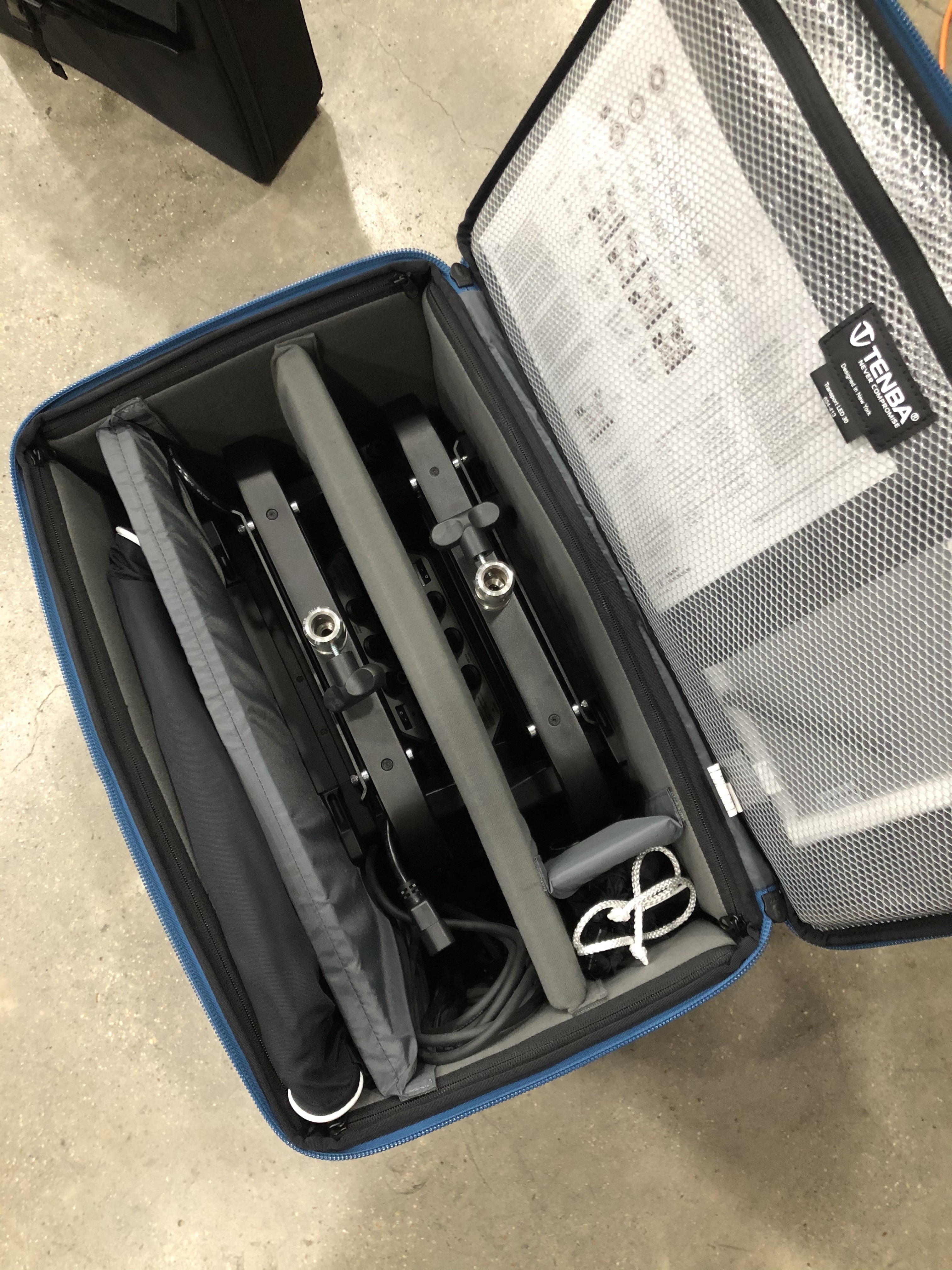

If anyone out there ordered a pair of 1x1's outside of the kit like me and is looking for a good, inexpensive case for them, I found one.
Thanks again for sharing this. Mine just arrived and it's perfect. Holds two complete kits with soft box and grid. And yes it does include a 2nd large divider which I put to use to separate the soft box.

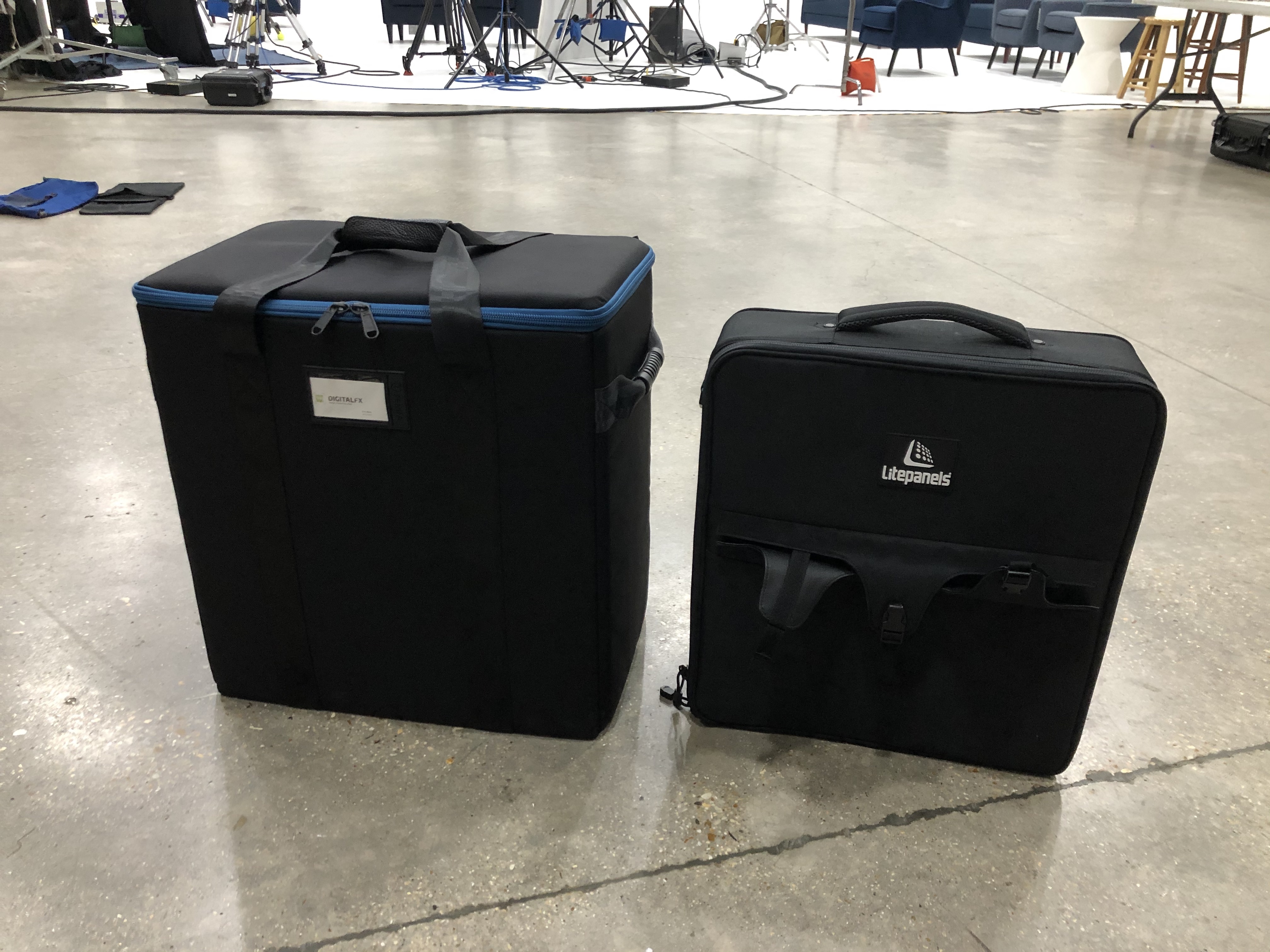

two light kit and single light kit:
Glad I could help. I don’t think I’ve ever bought any Tenba cases/bags before. I’ve mostly used PortaBrace, Pelican, Petrol and Kata for most of my gear(The latter two no longer exist. Gobbled up by Vitec and dissolved with Petrol rebranded as Sachtler and cut down to only a handful of models). But the Tenba case seems really well made. I wish it had a shoulder strap, but it’s not the end of the world.
I’m actually thinking about contacting them to ask if they do any custom work/modifications. I want a soft rigid case that I can fit my two 2x1 Gemini’s in together. The dimensions for their case for the SkyPanel S60 don’t quite work for two. But I have a feeling I’ll end up using PortaBrace, though. They do custom work and have done custom work for me in the past. But I’ll let y’all know in case anyone else is interested.
