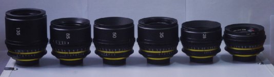

Guys, here's the Contax Rehoused Lens Set from G.L Optic...I got the Canon 70-200mm rehoused on hand too, will post some pictures I'd used for my last project...

Hey guys sorry about the delayed response but I didn't have any time to take photos yesterday. I took a few this morning in my kitchen.
Like I said before I really like them so far. We will see how they hold up but the feel solid.
Nice balance between still and cinema sets.
