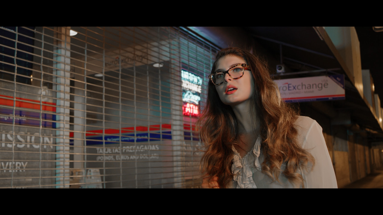

Šabović Adis;1861431 said:
Damn...she hot!
Who is she? :001_tt1:
IG is @camille.sofia super cool too!
Looks good Jason (even if Low-Light mode would have been better for that shot), glad it worked out.

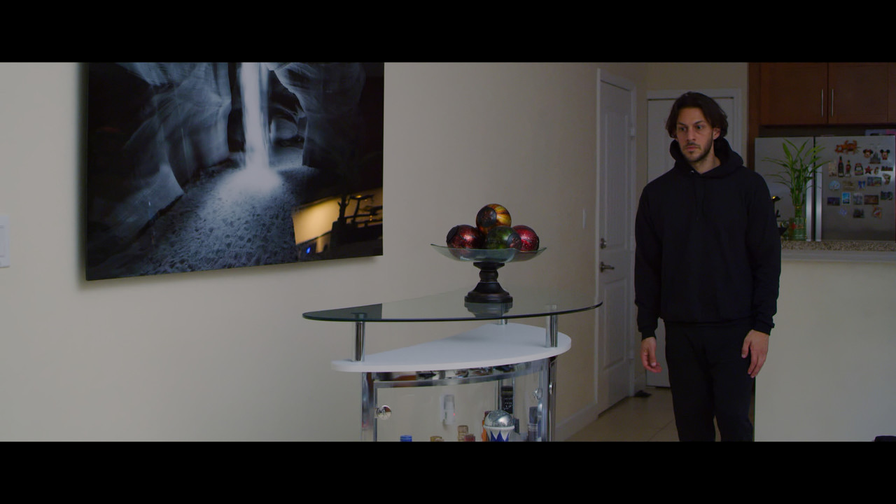

Can someone tell me what I did wrong, or has this happened to them. My camera just started doing this.
Of the four shots in the link:
First is underexposed + 8:1 bites off a chunk of what is left = unusable
Second is okay
Third is okay
Fourth is underexposed = unusable
There is nothing wrong with the camera.
You just didn't capture sufficient light to quantize into data. Your signal chain for monitoring may have been misleading so make sure you check that and stick with what is reliable and tested, and on that base test all the preview transformations in specific shooting conditions.
Your images with proper transformation applied to get a sense of realistic exposure levels:
May I ask why you didn't you use LL mode when you're more or less going natural/ambient light? The beauty of LL mode isn't just that it "gives you clean ISO2500", but that it actually shifts the dynamic range to open up more stops in the low-end (it actually empties out the shadow goalpost.)
And why only 4k WS? 5k (or even 4.5k) WS will net you substantially more image, which only serves to look better/cleaner when downscaled to 4k or 1080p. Also the shot of the girl (the most useable in my opinion) was still f4!!? You could've shot wide open, ETTR, and brought the ISO down in post for a fatter histogram/image.
Try looking at your left (shadow) goalpost. If you can, keep it empty, but if its not, toggle to gio/video/raw view to see what's actually purple and that'll tell you what is actually black. In terms of underexposure, again, use the video view for false colour (Caucasian skin tones should ideally be green/pink, unless it's actually in shadow). Beyond that, you're dealing with underexposure, so tread lightly (or do more tests until you know what you can recover in post).

Here are the only two recoverable out of the 4.
