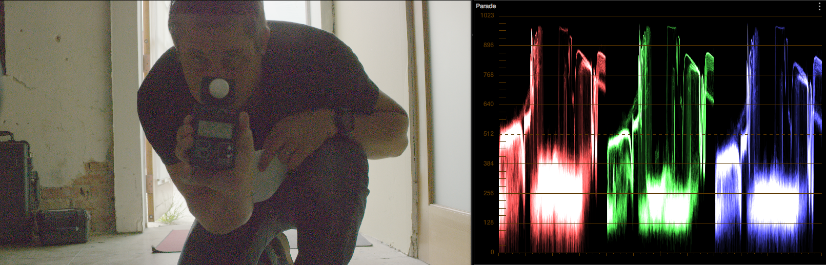

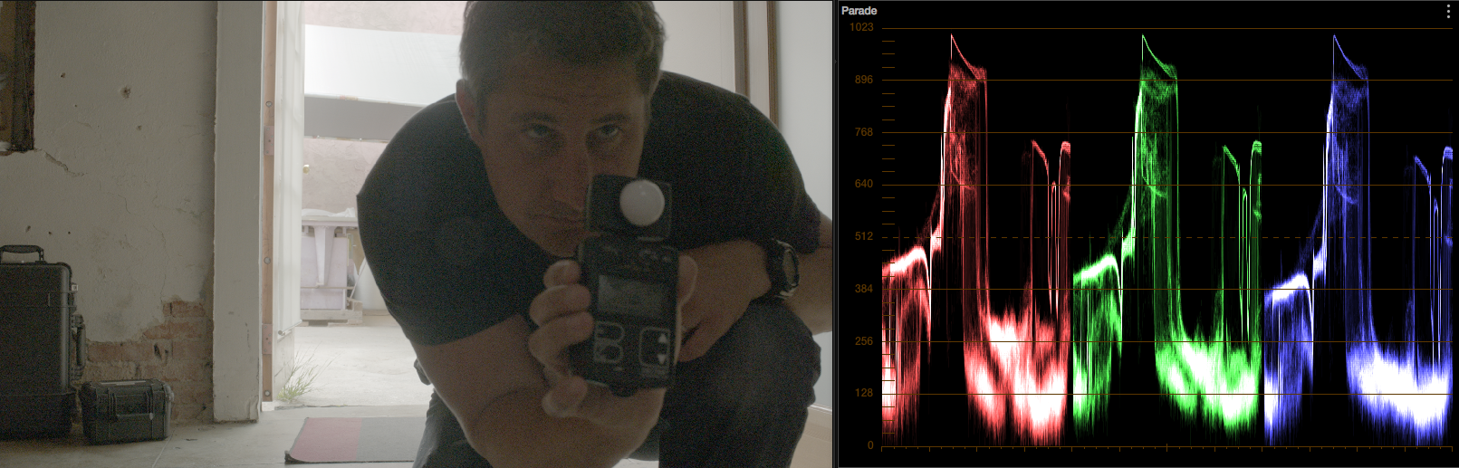

I think these images, unfortunately, say a lot about noise, shoulder clipping and color cast:
Dragon:
Alexa:
These are Dragoncolor/RLF at 3200 ISO, 5600k - Arriraw 3200ISO, 5600k, no sharpening out of Resolve.
I've noticed on the new olpf/calibration that there appears to be a lot of red noise in underexposed footage. I'm betting that can be fixed by firmware/software update. I do agree though that Alexa has the upper hand on the low end. Lot less noise with Alexa...
The challenge with comparing the light meter shot is that if you load up both RAW images neither is clipping anywhere in the frame. So either camera could have been rated a stop lower and I doubt they would have clipped. Who would have clipped first? tough to tell.
