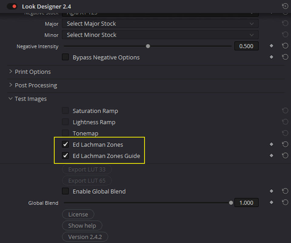

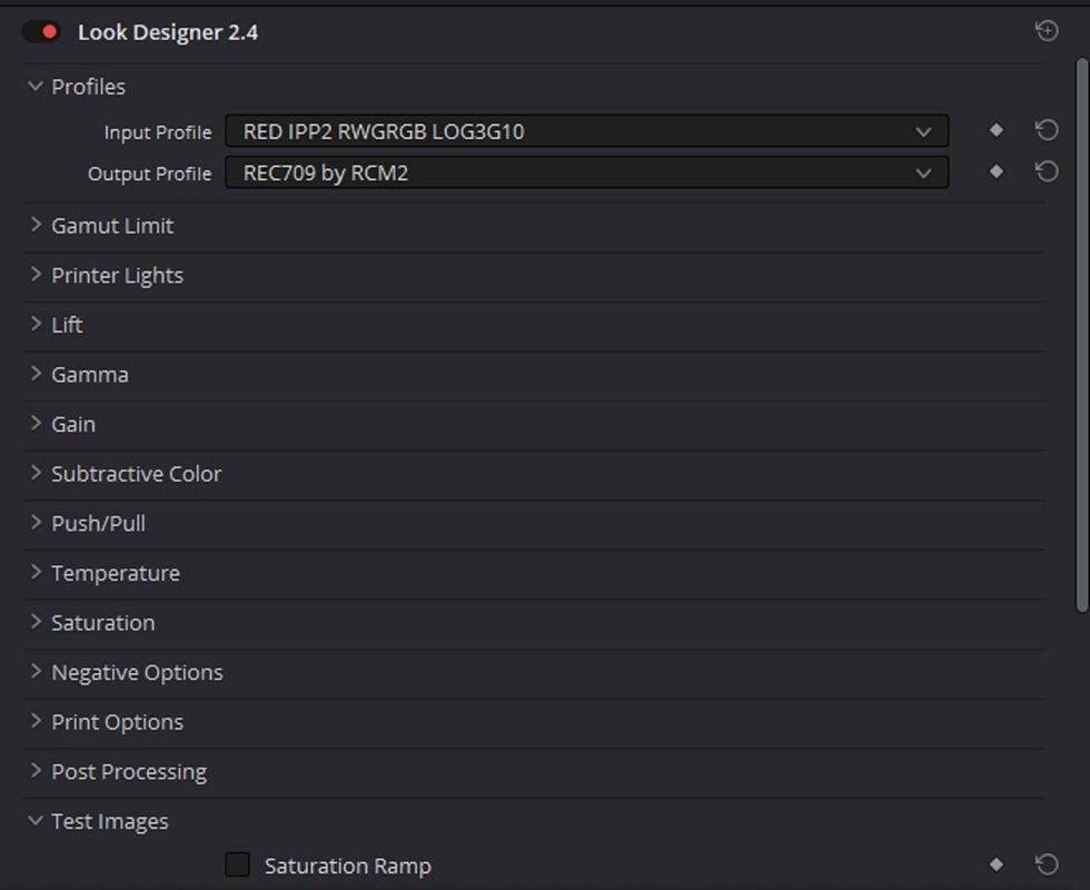

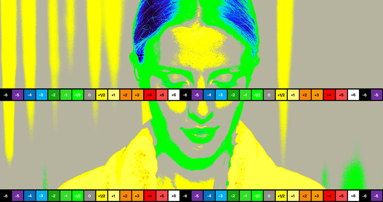

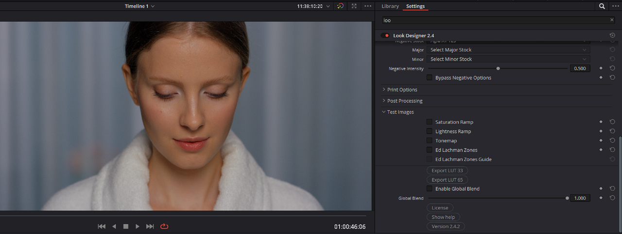

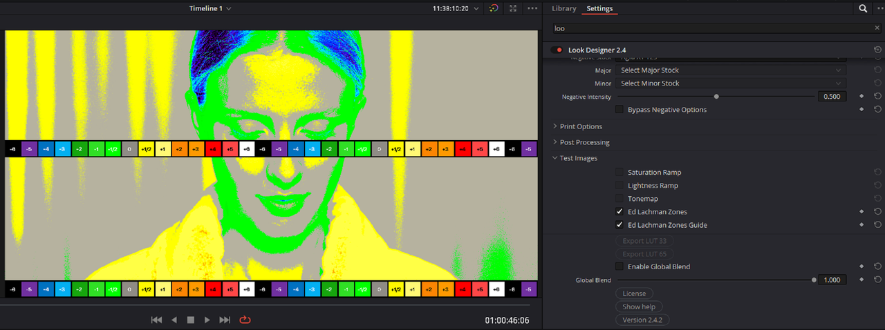

The Ed Lachman Zone System can also be found along with guides in post inside of LOOK DESIGNER.
