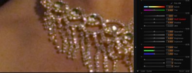

Hello,
I was looking at the difficult example of the nude woman on the thungsten bulb and was looking at the details of the diamants.
Without denoise the color saturation of the brillances seams too harsh. Is it due to a to hard debayering process?
Pat

Hello,
Pat
They don't look like real diamonds... My guess is they are fakes and that accounts for the higher amount of colored brillance.

IMO, the artifacts in the costume jewelry without de-noising is a peek into the balancing act any DeBayering algorithm has to manage. I'd be curious to see an example like this at various compression levels and decodes. Would love to compare a 1/4 res version, to a full res premium, to ADD processing of the same image.
I also believe that specular highlights are the "last frontier" for any image created using a Color Filter Array like the Bayer pattern. I would further postulate that, based on what little we know so far, that the ADD processing would be of particularly great value any time image elements have edges near the pitch (or exactly double) of the sensor photo-sites or low pass filtration.
Digital imaging physics are like most physical systems in that they have what I refer to as resonance points - think about a woofer in a cabinet of internal volume X that plays back 30Hz or 40Hz sweetly but at 35Hz (example resonant frequency) it shakes and rattles. The DSC "wringer" chart is particularly good at finding failure points in Bayer decodes. I would guess that Graeme uses them, and other tools, to dial in his algorithms. Moreover, I would posit that the OLPF characteristics have a major role in these interdependent equations. I also believe that part of the ongoing optimization process is to fine tune how the algorithm sorts real detail from aliasing.

The strange thing is that the over saturated colors are happening in the orange-red-magenta spectrum. Knowing that the ballance had to be made from 5600k to 3200k some difficult highlights/highcontrast could have broken the color resolution and brought up saturation (?). I don't have a clue, but I'm speculating on what I see... I wonder what Graeme would have to say.
I don't think this is due to anysort of CA of the optics nor due to colored diamonds.
Pat
Pat
I would suspect you're right. It's just one of those tricky situations though where it doesn't matter what color the diamonds are, if they are hitting individual color wells the debayer is going to assume that it's fine chroma detail and debayer accordingly. Will be interesting to see how ADD handles this.
