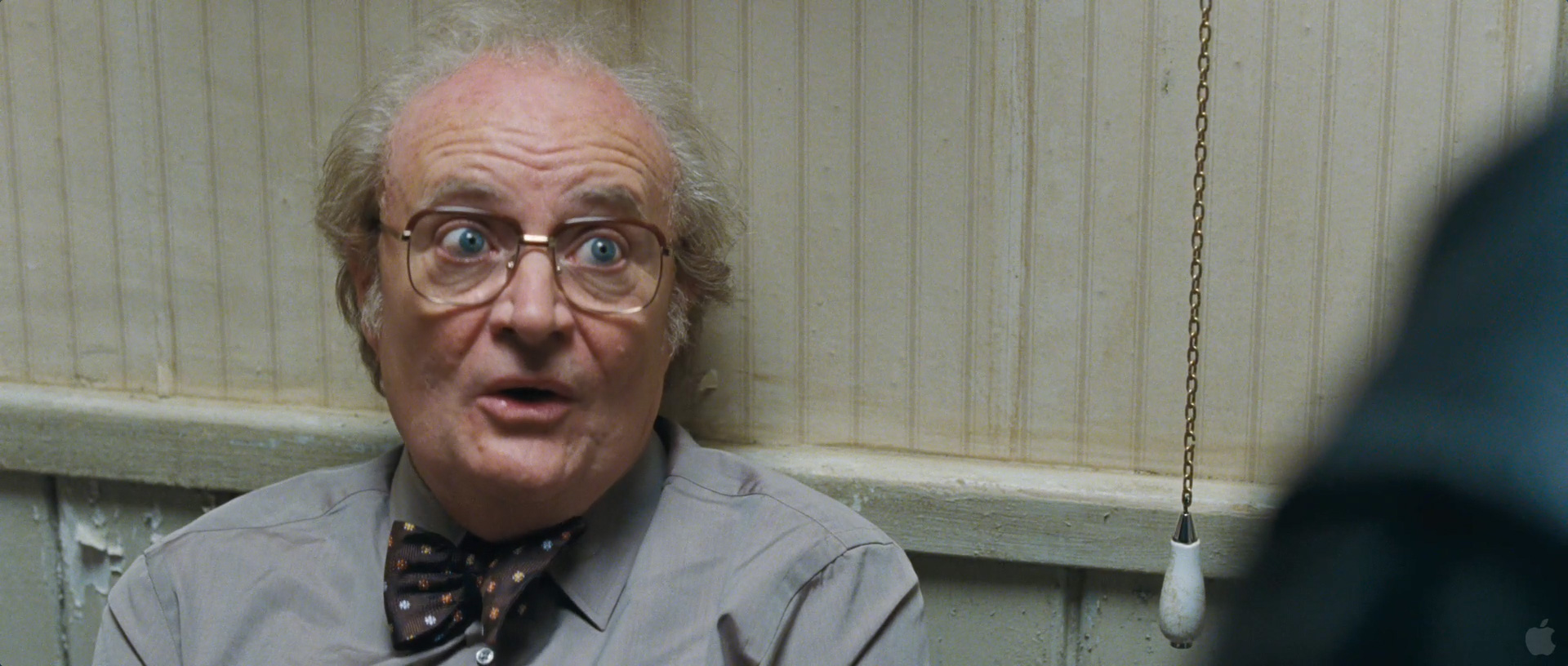

And, just for kicks, below is an image from Cloud Atlas, which was shot on film, showing that yellow blotchiness on the forehead.
Right-click for a larger image.
Jim Broadbent has that type of skin tone variation, which is likely additionally affected in post.
http://www.aceshowbiz.com/events/Jim Broadbent/jim-broadbent-premiere-cloud-atlas-05.html
I looked at this pic as well as several dozen more on IMDB. He does seem to have some natural yellow variations in his skin but it's hard to tell to what degree. As they're all shots of acting related or public appearances and, being an older gentleman, he's almost certainly "made up" in all of them to some extent.
It could be the case that whoever does his makeup never bothers to apply it higher than his forehead. After all, he is 6' 2".
In the pic below (from Another Year), you can see where the makeup stops at the top of his forehead, leaving the top of his head a slightly different color and less shiny.
I think whatever makeup issues a camera has is often exacerbated by not applying makeup close enough to the (actual) hairline or not blending well/far enough into the neck.
I notice a lot of women in general have this issue when wearing makeup - their faces will be considerably darker or lighter (depending on complexion) than their neck and chest. It's not a look I'm fond of.
