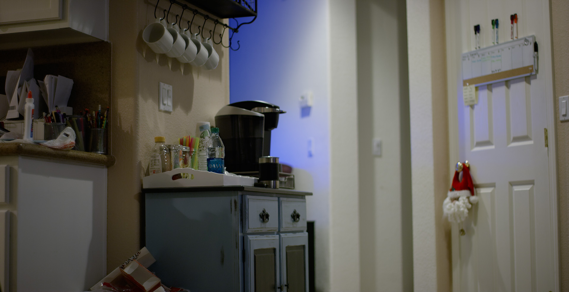

I take Aaron at his word that this was captured at 1.4. The Camera might default to 2.8 in the metadata for dumb lenses or non electronic lenses. Based on the histogram I do think it is 1.4
This said. I took a WB on the light switch and applied DC2/RG4 and I think the shot looks great. Just pops and the texture seems just right for this lens/exposure combo.

Like David, I did pretty much the same process but bumped the ISO to 1280 and applied a tiny amount of NR and it's smooth as can be in motion. In motion at 4K the noise is already almost invisible in the original clip. It isn't until you look at it as a still that you really notice it. I used DEB + Denoise + Neat Video profile on 20% luminance NR. So when I said tiny amount of noise reduction, I meant it. Dragon does exceptionally well with Neat Video. I'd say it's pretty good for the Skintone/Highlight OLPF.

Yes, the other REDgammas definitely look better. I really do like the look. I was just worried I didn't perform a calibration or something to help the performance of the camera. This was a quick clip I stole with available light just to see what I got. You're right, the noise shrinks quite a bit at 4K.
David, yeah, I tried that combo as well and the image really did seem to "pop"...
Yes, the lens was a Zeiss 50/1.4 that didn't send any of that metadata info to camera. I had it wide open, which could explain some of the softness. The focus was actually somewhere around the pencils or just in front of...
