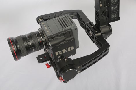

I don't think it's possible, because when I look at your picture: ( I hope it's OK, that I modified it a little :) )
I see a VERY LIMITED SPACE behind the camera, and even if you put very thin V-lock battery there and it's fit, - you still will have NO SPACE for TILTING:
I took someone pic and try to make this illustration in Photoshop... and hope it's show us how little space we have behind the camera ...

Sergei - it is not as simple as that. The moment you add something that heavy (like V-lock) to the rear - you have to move the whole camera forward to offset the balance. This is why adding weight to the rear of the camera allows for other lenses (and cameras) to be used.
If you look at JC's config here - he has a (rather large V-lock) at the rear and balanced:

If JC used the Endura E-7s (which is a lot more compact) - you will gain even more space at the back...
Now imagine that you would be able to add two V-locks to the rear of the camera side-by-side - that will push the camera even more forward giving you extra room at the back...
So things are rather complex and you need to try and test a combination that works for you.

Yes! It's not that simple! :iagree: ... - RED body ( on your video sample, on my "illustration" and on that picture ) is only 15sm long :
...but Sony F5/F55 body is 21sm long !!! :tongue: ...even Sony FS700 is shorter! - only 19.3sm !!!
