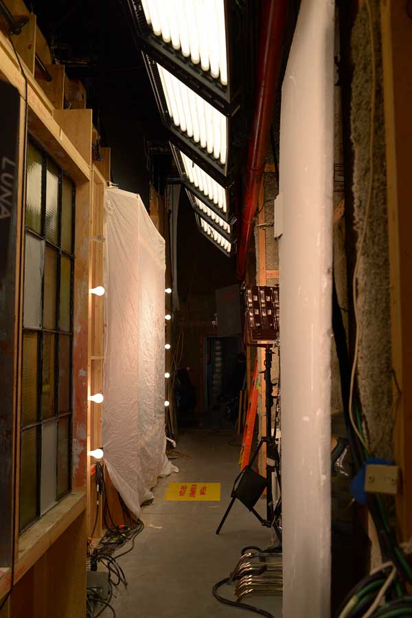

Another set:
In this case, instead of bounces, the soft skylight is coming for Image 80 Kinos. Since the windows are frosted, we didn't need a backing outside of them but we did put some light bulbs on the backside of the set to illuminate the stage wall seen (barely) through the glass. In this photo, the window was off-camera so I covered the whole window with Grid Cloth and put a 9-light through it for a soft side-key but in most cases, the Kinos were enough light to create a soft window light in the room and get me up to an f/4, it's just that since the Kinos are mounted above the windows, the angle of light is downwards and doesn't reach across the whole room as well as the lights on stands could. On some sets, I've put the Image 80 rows on a motorized bar so that I could raise or lower them depending on how far I wanted them to dig into the room. The Kinos have the advantage of being able to be rigged with a mix of daylight and tungsten tubes for a cooler effect at a 3200K base setting on the camera. The downside is that I can't dim them fully up or down on the dimmer board, just turn off select tubes. The other advantage to the Kinos is that they pull less power and generate less heat on the set.

Matt, thank you for the example too (and your blog is super, thank you for posting it). A great demonstration of doing lots with a little, as you said... my concern was that sets were going to be built with windows, which they might reasonably expect to see in shot, and which I was going to have to simulate daylight through.
