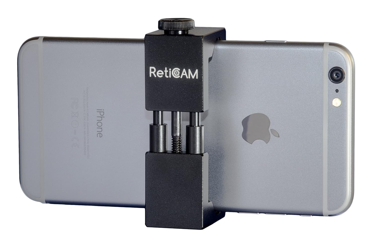

I use this mount for batteries for my Paralinx, but it's made for smartphones.
http://www.amazon.com/gp/product/B00KG4V11C
