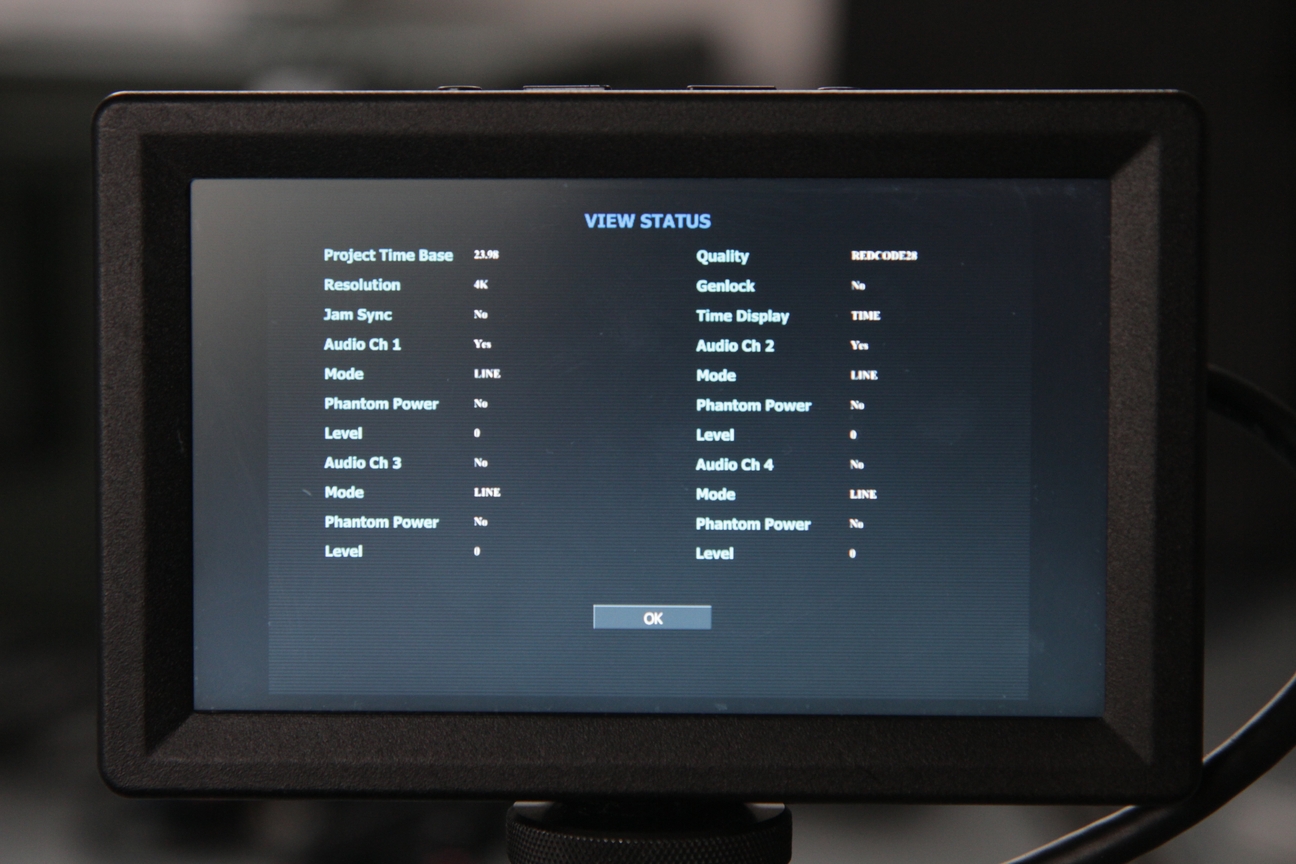

Working fine here so far. Interesting new STATUS display in the latest build:
HTH
Paul
