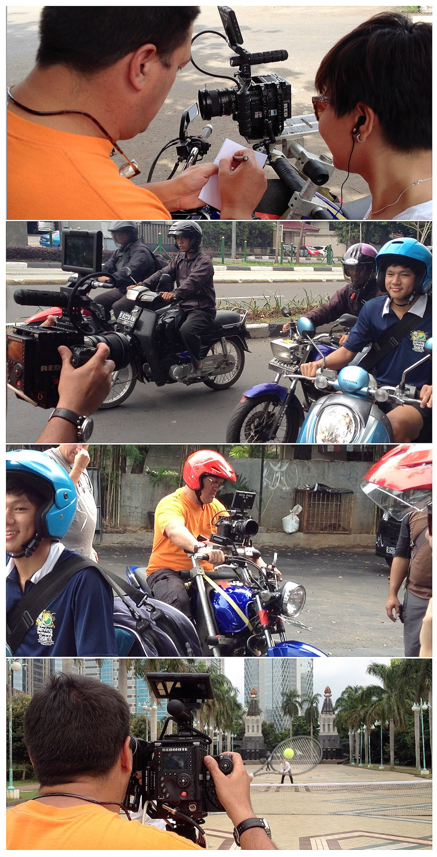

Plus its good for when your running around doing low shots, keeps your rig small and solid... know after maker screen flopping around on an arm weighted down with batteries to run it...
Whe n your camera is on a rig, crane, mount or something and you want to keep it small... the screen is solid and swivels and you can adjust settings fast...
We put outs on a motor bike the other day, would have been a real pain with any other monitor other than a 5 Inche RED touch... I could adjust speeds etc while riding... (dangerous but doable)
