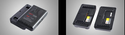

What about the Swit S-8172S 79+79Wh V-mount Battery?
http://www.swit-battery.com/EN/product.aspx?id=94
Any one had experienced on used this battery? Is it accept to use with Red Cameras?
If is not void Red Warranty, then I planning for group order directly through their marketing manager...
