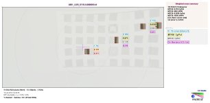

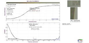

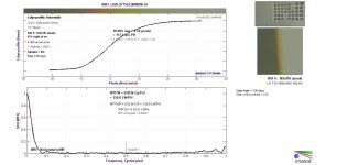

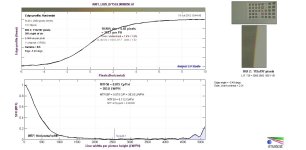

Some interesting results measuring performance of flat port.
Today we have done some measurements of perfectly aligned and precisely focused 14mm Master Prime lens placed behind a flat port with some interesting results.
It was no surprise that it performed very poorly at the edges, resolving less than 16% of the theoretical resolving limit of the sensor at the far edge (point 4 - the last two pictures).
But, what was interesting was that the system perfomed very poorly at much lower angles. In fact the resolution more than halved at less than half that angle of view. This means that even with a land lens covering 40 degrees diagonally, there is absolutely no useful signal left at the half resolving power of the sensor. Or, in other words, there is no hope for sharp 2k downsample shot with 40 degree (about 40mm focal length) or wider land lens behind a flat port.
So, what worked (60 degree land lens) behind a flat port in standard definition, seems to be much more limited when shooting for a 4k output.
It seems that the limit of a lens placed behind a flat port when shooting for 4k output would be about 20 degrees diagonally (about 80mm focal length). I didn't expect that.
The results are attached. Happy to explain the graphs and numbers or post the native resolution frame. I also shot "humanly readable" old-school ARRI zone charts for the visual folk.
Note: the angles of view above are before the 25% magnification effect caused by flat port.
Note 2: The correction of geometric distortions would further degrade the MTF figures.
