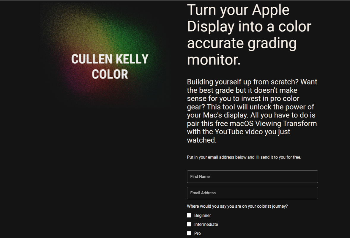

Turn your Apple monitor into a color accurate display in DaVinci Resolve

Cullen states at the latter part of the video that this is not a replacement for having a Calibrated Reference monitor for " Professional " Color Grading. This is only a way for those whom can't afford to invest in Reference Monitor to get a more trustworthy color grade from their Apple Displays for a less " mission critical " work.
