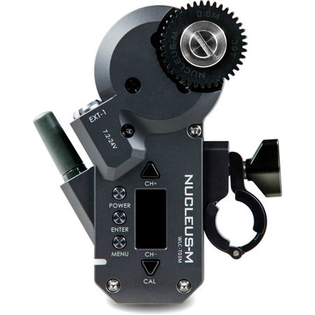

Do you still need to use the hand controller (FIZ) everytime you want to calibrate the motors to a new lense or can you do that using the handles only too? Thanks!
Motor has the ability to trigger calibration directly, no controller needed. It's the fastest way since you are already in there changing the lens, just trigger the calibration once the new lens is secured and mated with the motor! (it's the down arrow marked with CAL)
