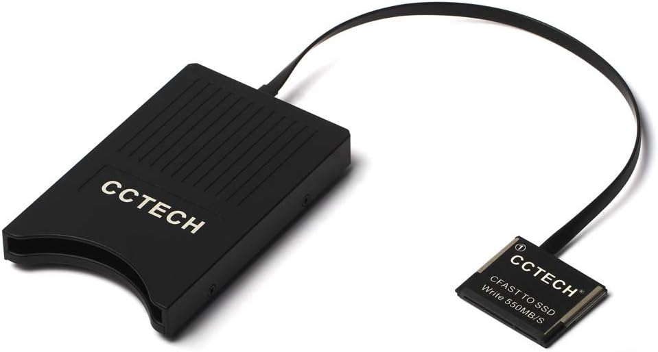

Any news on SSD and Komodo? Is that even possible? Would love to be able to use my EVO's with the Komodo.
Well, I suppose you can technically use the CFAST to M.2 SSD thingy from SolidPod IF the camera see the media correctly through that (but since RED said multiple times that the little media bay door on the Komodo is user removable in case you need to I assume they were thinking about those who would like to try this kind of adapters).
https://store.n.ki/products/solidpod-plus-m2
They also make one for mSATA SSDs if that's more your thing. (note that due to the CFAST side of things, the bandwith is limited to 550 MB/sec on any of these)
I am going with cfast to mSATA SSD solidpod. Its going to be released within 2 weeks. Hopefully there is no issues!!
There's a ton of similar adapters on Amazon. Also, I think Phil Holland was playing around with an SSD solution if you want to hit him up.

Nice video: "...and here's bunch of cheap crap that doesn't work for the Komodo". I guess it's a good what not to buy video.
I appreciate your response to my post but why do you feel the need to be all snarky about it? LOL
And you should probably watch the video before you comment on it. It shows two cheap media options that work. They’re not ideal for every scenario but they work. The silicone power cfast card is not able to shoot in all flavors but at 6K MQ 23.98 FPS it’s flawless. That’s good enough for 90% of my work. Also, the SSD option records flawlessly in all flavors with zero dropped frames. It’s just a messy set up.
